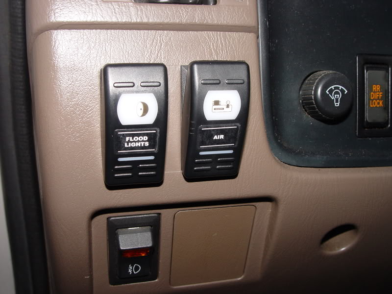

Finally got my OBA setup in full gear today. Well, sort of. I'm still waiting for my 3 gallon tank.
I have had the MV-50 compressor from Pep Boys for a while, and now finally hardwired it to the Viair pressure switch and mounted it in the engine bay.
I ended up taking out the cruise control actuator to make room. I never used the cruise control, and would rather have a compressor out of the elements. I just drilled two holes and fastened with nuts, and used some rubber bushings to settle down vibrations.
Rather than spending $75 on the Viair 2 gallon tank, I went with the 3 gallon tank for $33 here: http://www.kmwperformance.com/product/CT3GT.aspx. Its only 8" wide so it should fit nicely near the frame rails...
Here are some pictures to give you an idea on what I did. The switches are from here: http://www.4x4mods.com/Product/Jeep/...rswitch40.html

Also, I have a 50' air line coil with a clamp on tire chuck... Works very well. Very impressed.

Sexy switches

Looks good, way to ditch the cruise if you don't use it. How long to air up with that? You'll be popular with that 50' hose after runs. Post up pics when you mount the tank.
