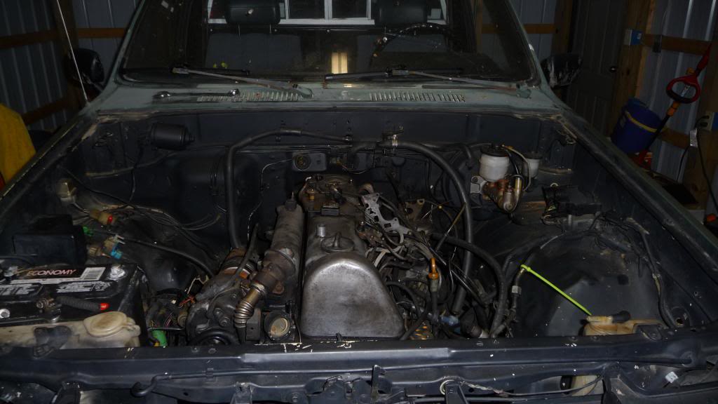

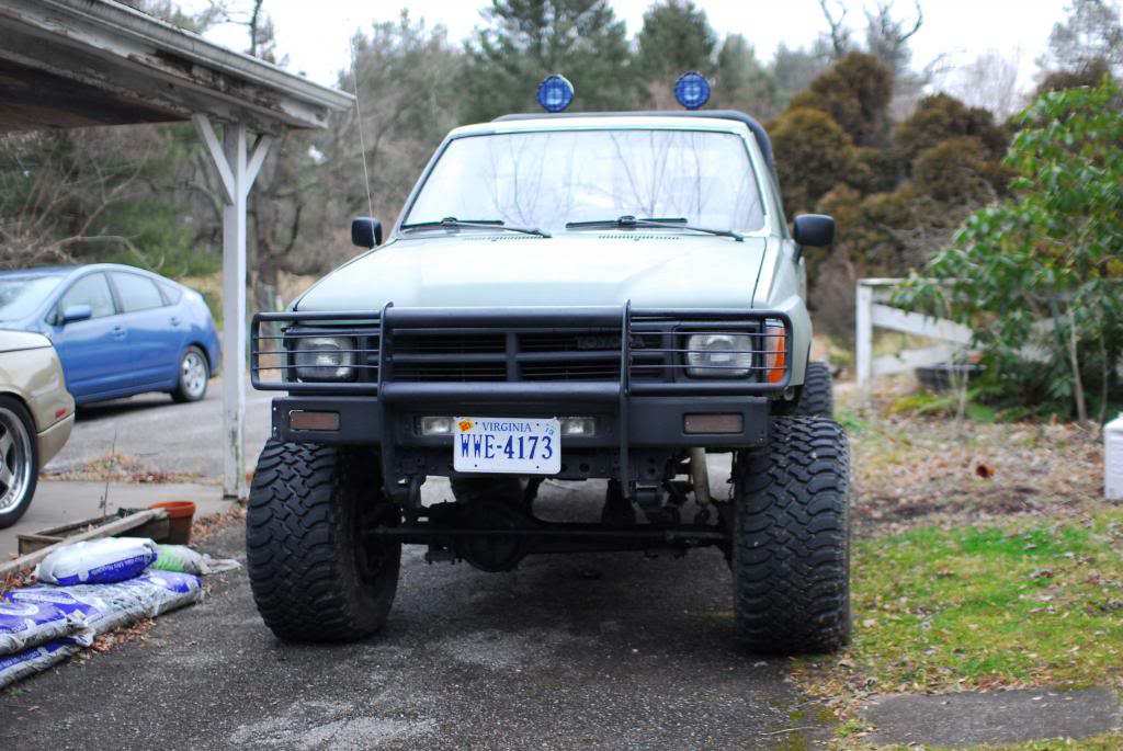

Long time lurker on the forums and I figured it was about time to make a build thread for my 1986 Toyota Pickup. I owned a 1994 4Runner I picked up for $500 with a blown headgasket (3VZE) a few years ago and enjoyed it a lot. Completely stock but a good truck none the less. Anyway, I'd always wanted an older Toyota Pickup and after graduating from college I decided it was a decent time to do so. After looking for quite some time, I ended up with this '86 Toyota Pickup with a 22R:
I found her on Craigslist with already completed SAS setup, supposedly a bunch of engine maintenance, Weber 32/36, etc. It had an externally leaking headgasket that I was going to fix, along with replacing a bunch of other things while I was in there. When I dug into the engine it turned out that all that "maintenance" that had been performed turned out to be BS. So I replaced the headgasket, full timing components, new cam, new rocker arms, new valve stem seals, decked and hot tanked head, etc. I left the bottom end alone which turned out to be a mistake. A few months after I started driving the truck I could hear a light knock developing. I hoped it would last longer than it did but not too long ago the bottom end let go and I now have a serious knock on my hands.

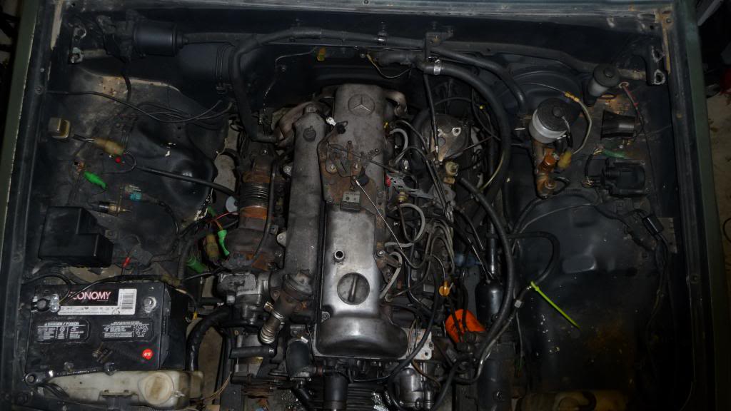

Ok as promised, more pictures and details...two Fridays ago a friend of mine and I got to work on the motor mounts. We suspended the engine with an engine crane, bolted it to the transmission, centered it, etc. and then made our mounts accordingly.
4x4Labs had supplied the plates that bolt up to the engine so I just had to make the rest. I ended up using the stock metal "cups" that go over the rubber mounts and welding plates between them and the engine side. They're not pretty but they turned out strong and the engine sits perfectly in the bay. I don't have any good pictures of this though.

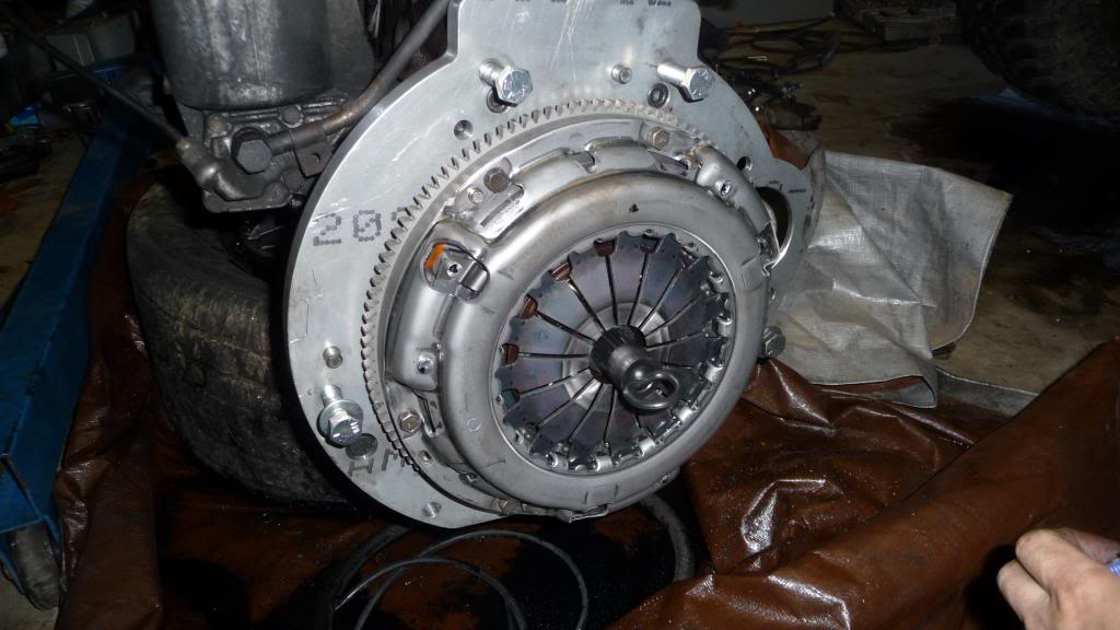

Sadly my clutch didn't show up until this past Tuesday. On Thursday, the engine was pulled out for the final time, mounts painted black, adapter plate bolted to engine, clutch installed, and the engine ready to be installed back in the truck. We finished up and had the diesel installed sometime on Friday evening. We even got the starter bolted up and as shown above started the engine for the first time in truck!!!

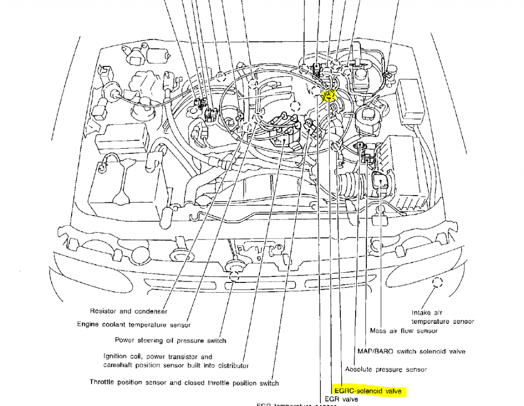

After a quick trip to the junkyard on Saturday I returned with the EGR/evap solenoid from a Nissan Pathfinder that I wired up to use as my vacuum shut off. This particular solenoid allows vacuum to flow when no power is applied and cuts vacuum off when 12v is applied. So I was able to wire this up to switched 12v via the old coil wire with little trouble.
Location of solenoid in Pathfinder:
The actual solenoid:
Adapter plate and clutch:
