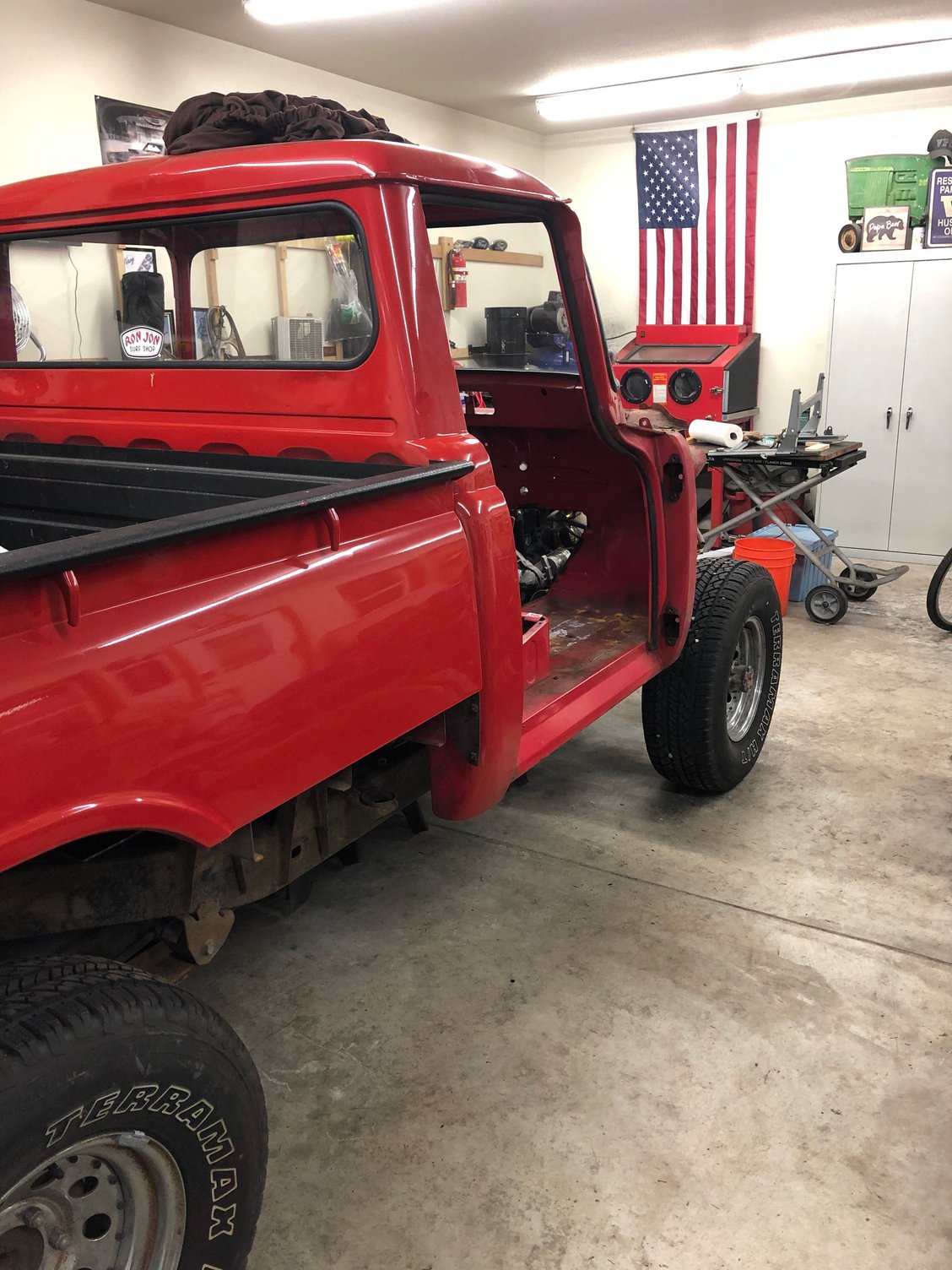

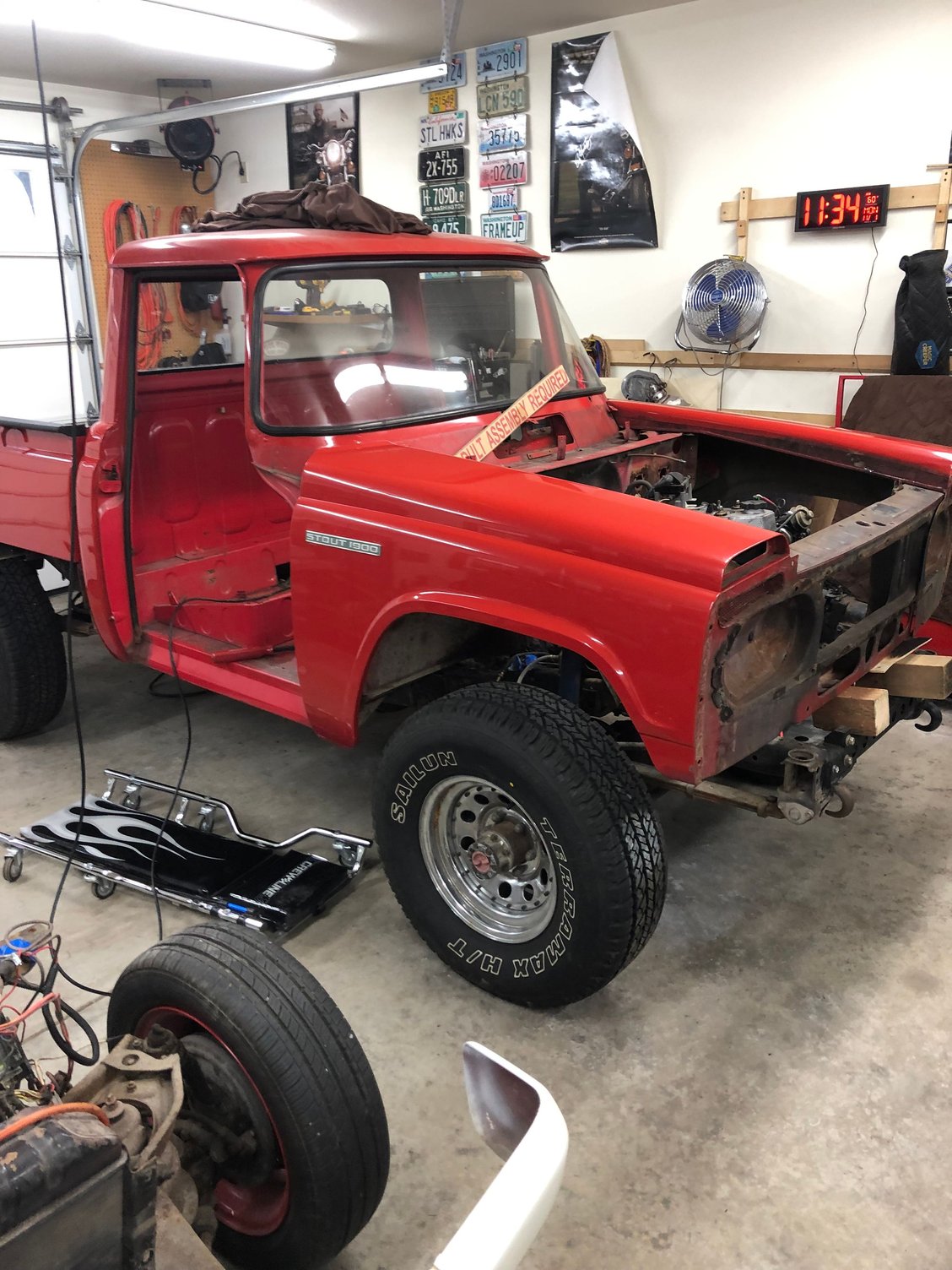

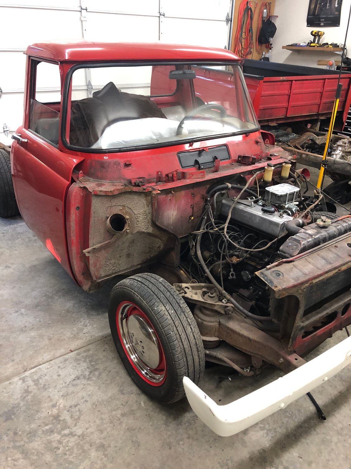

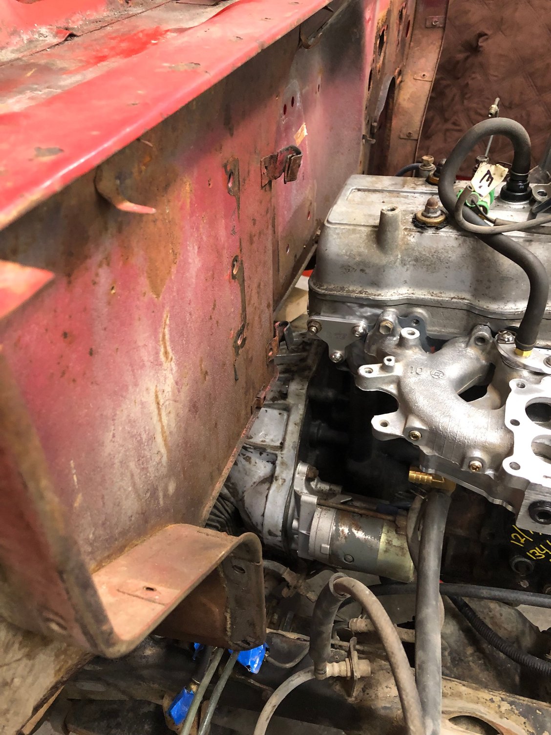

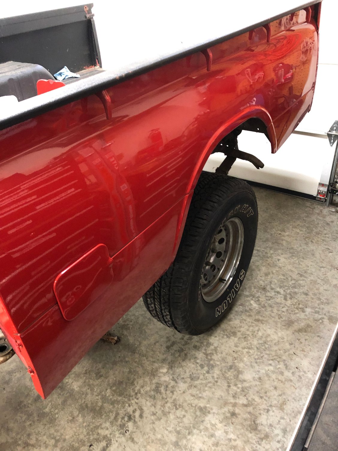

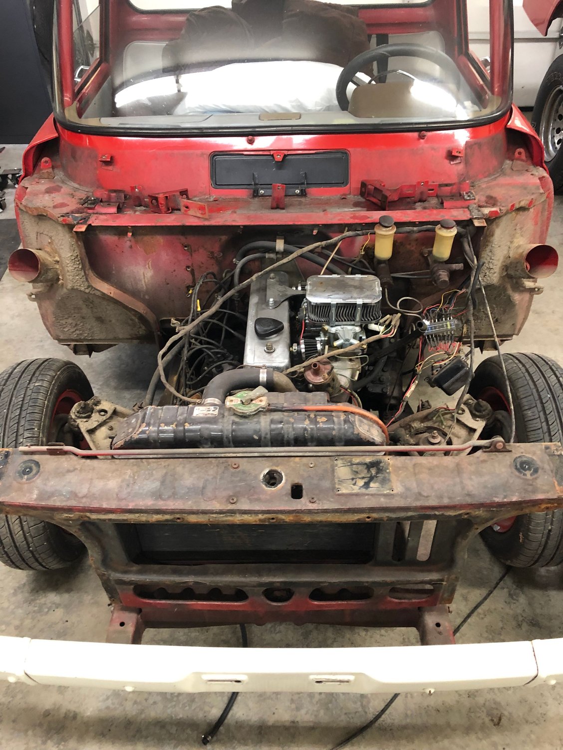

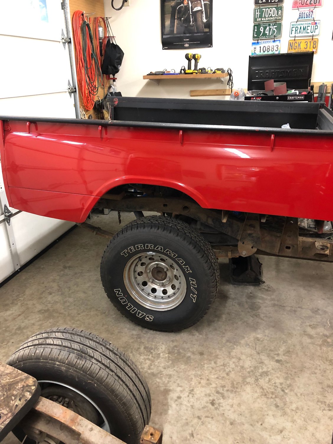

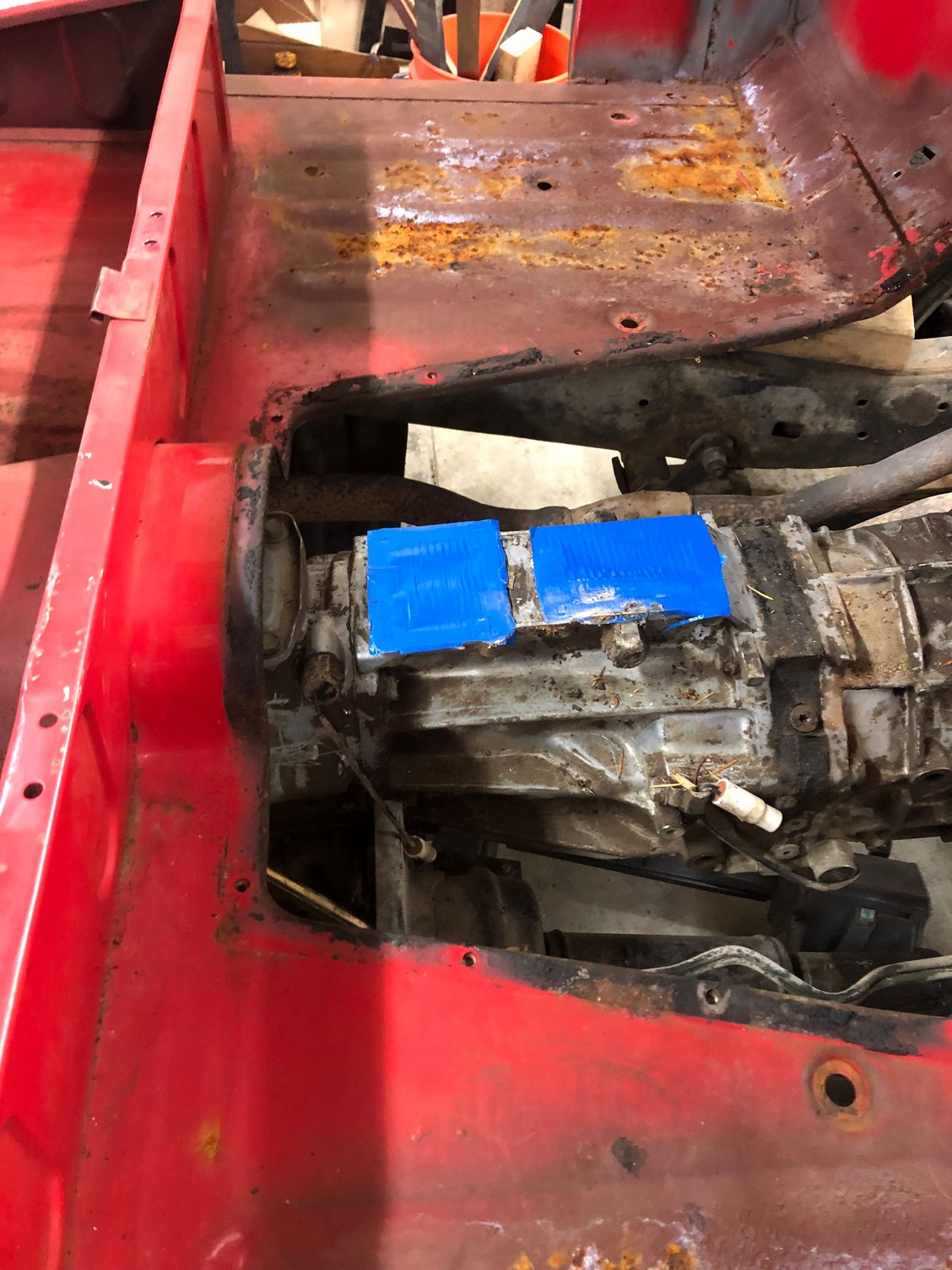

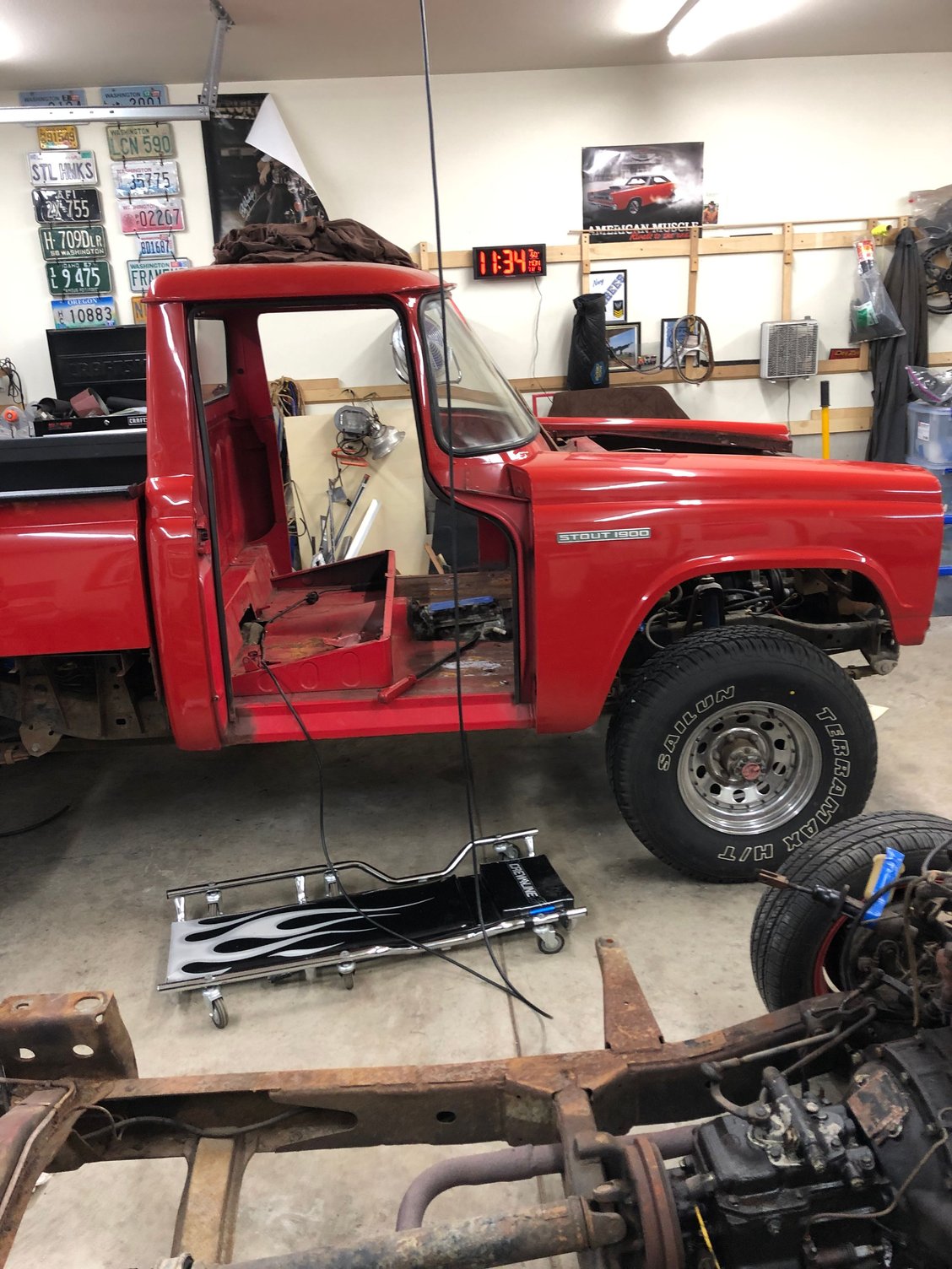

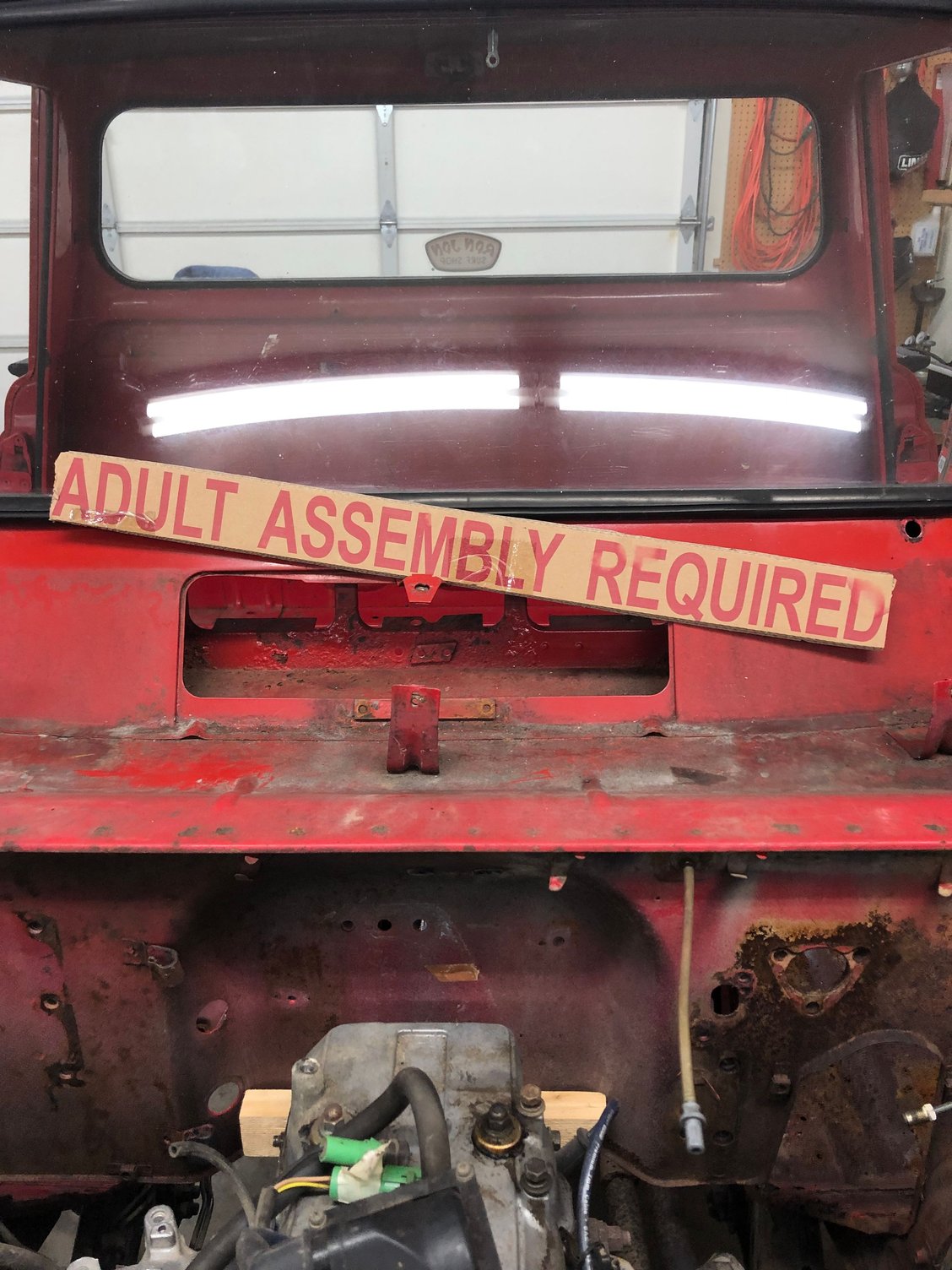

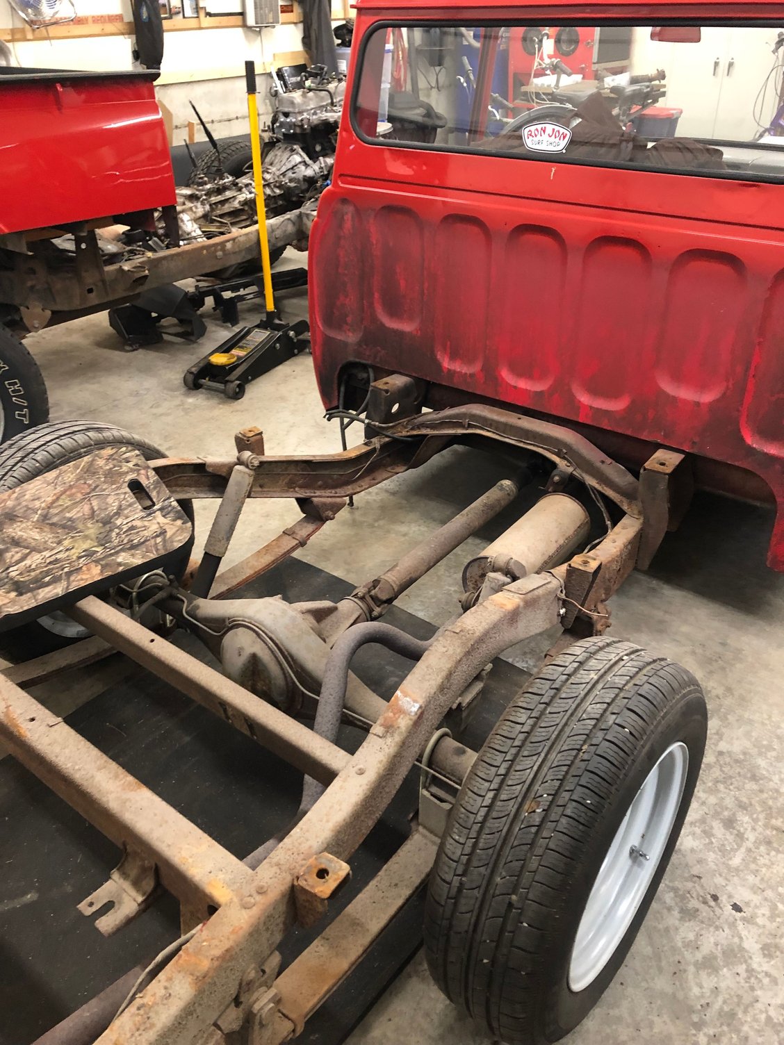

A few pics. The body fits fairly closely to the 85. The radiator to fan clearance looks like it will be the biggest issue. Once the body to frame mounts are fabbed, and things aren’t moving around, I’ll start working on the core support.
Tear down of 67
More tear down
From the back
Initial bed mock-up on 85 frame
Left side of bed
Initial cab mock-up
Lining up cab and bed
Interior alignment
Firewall clearance
Most lines matching up and ready to fab frame mounts.

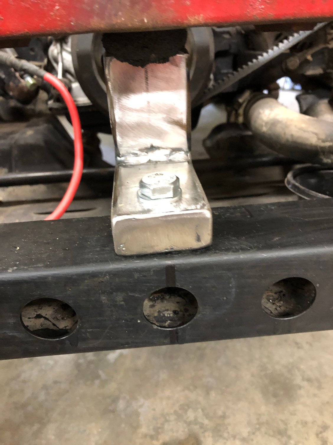

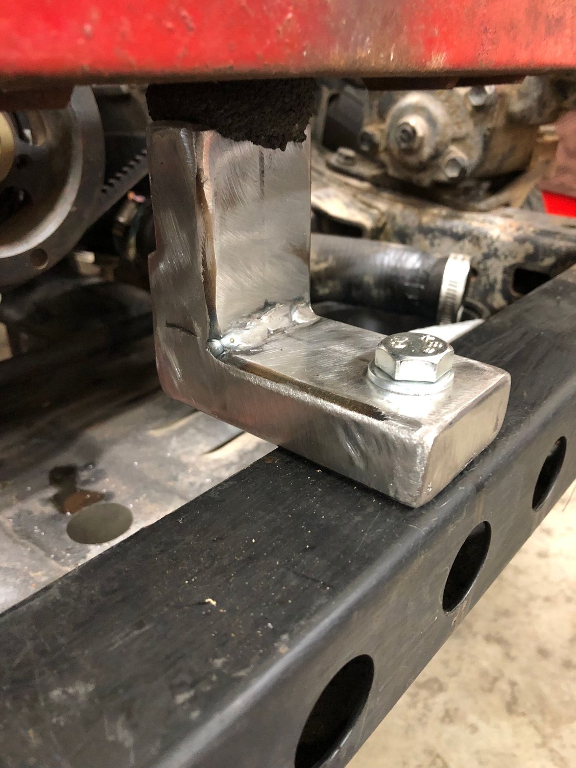

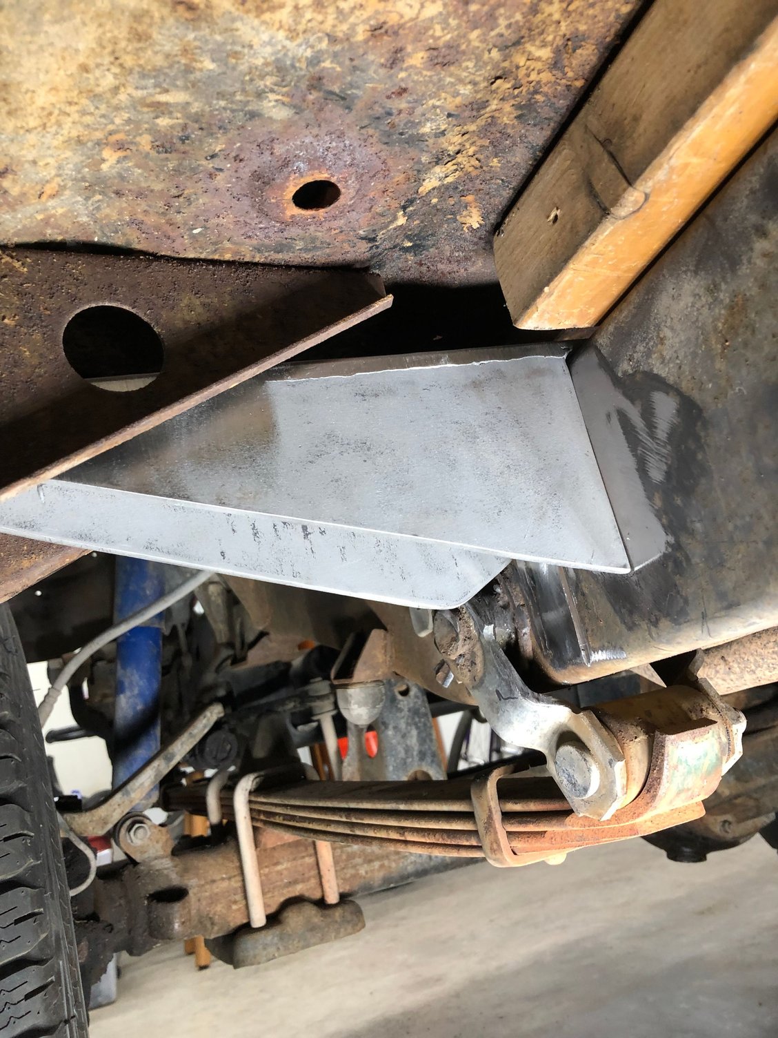

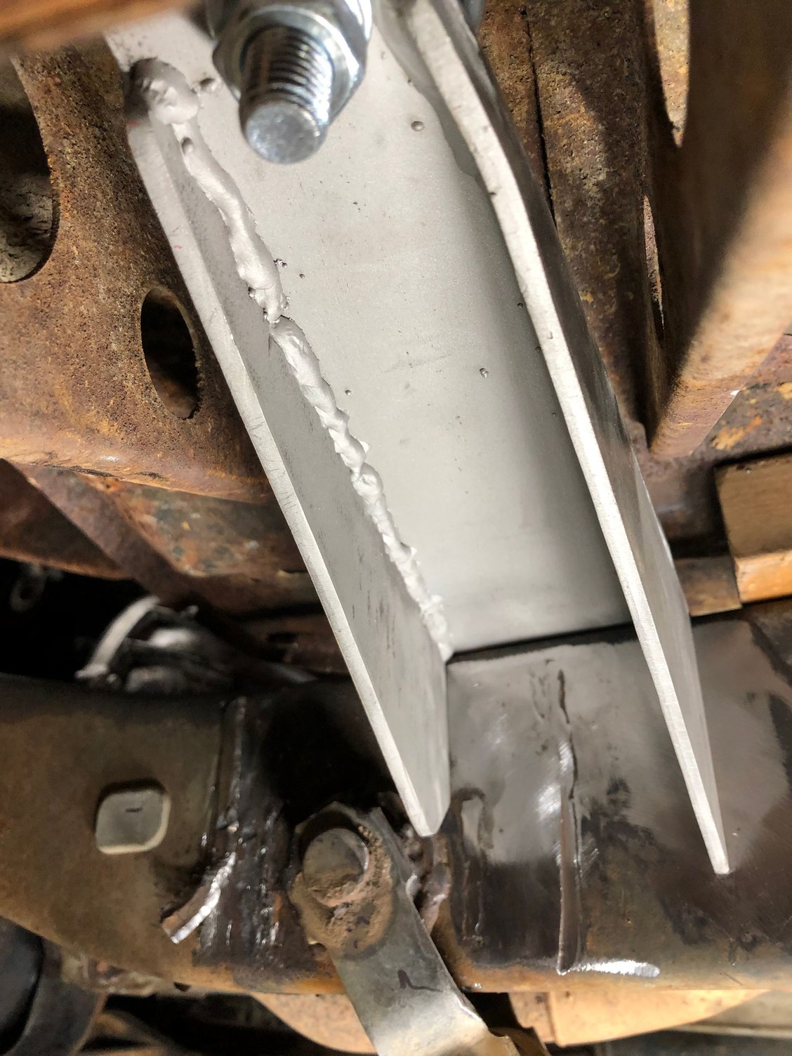

Core support mount
Core support
Front cab mount
Front cab mount

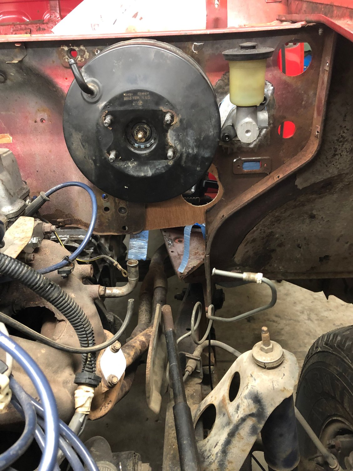

Finished mock up of bed mounts, front cab mounts, and core support mount. Need to remove the bed to fab the rear cab mounts.
I need to mock up the brake booster and then set the steering column angle at the firewall next.
Still looks like the radiator and fan will be a challenge.

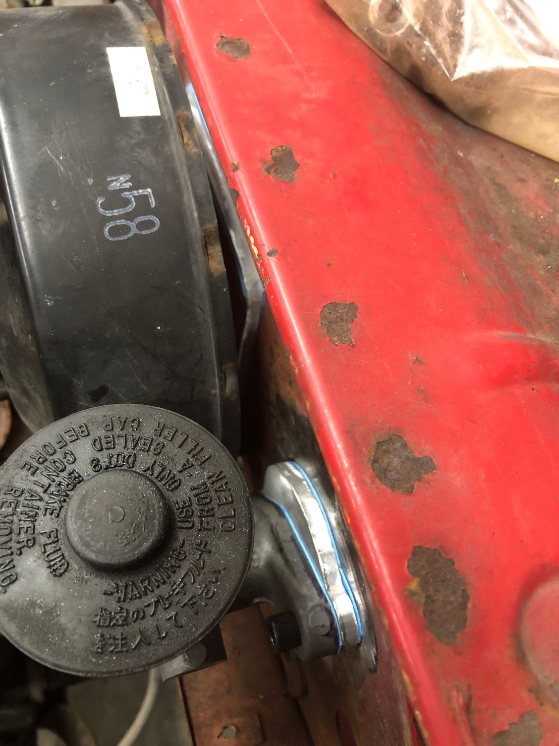

Finished mock up of the brake booster and clutch master. Also got the radiator mounts fabbed. Steering column is next. Looks like I’ll need to splice the steering shaft in order to use the 67 steering wheel on the 85 shaft.
Top view of aluminum spacers
Front view of booster and clutch master
