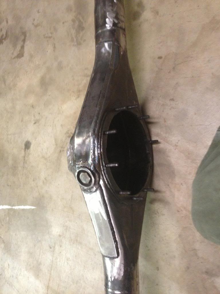

well it has been a long time since i got to do any work on this thing.

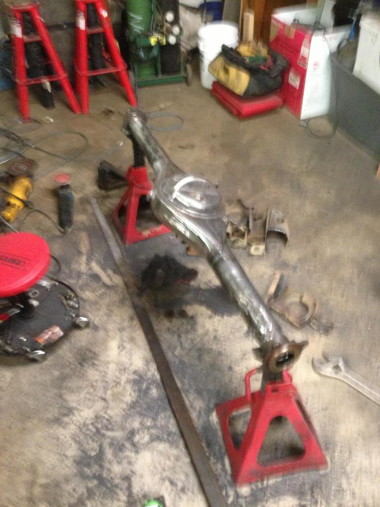

over this last weekend i started cleaning up a IFS rear housing for it:
starded as a 90 4runner axle, mnan those things have alot of brackets to cut off!
going to weld a strap across the bottom and back for some light reinforcement and get some ruff stuff perches.

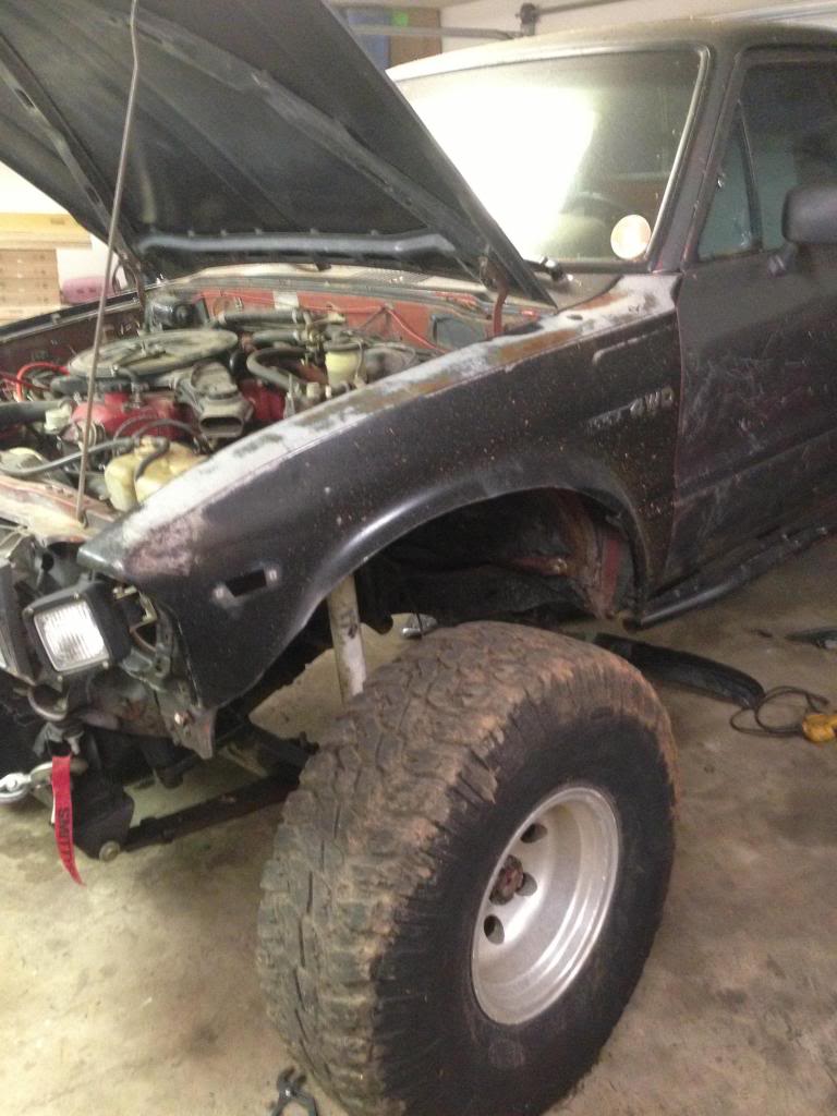

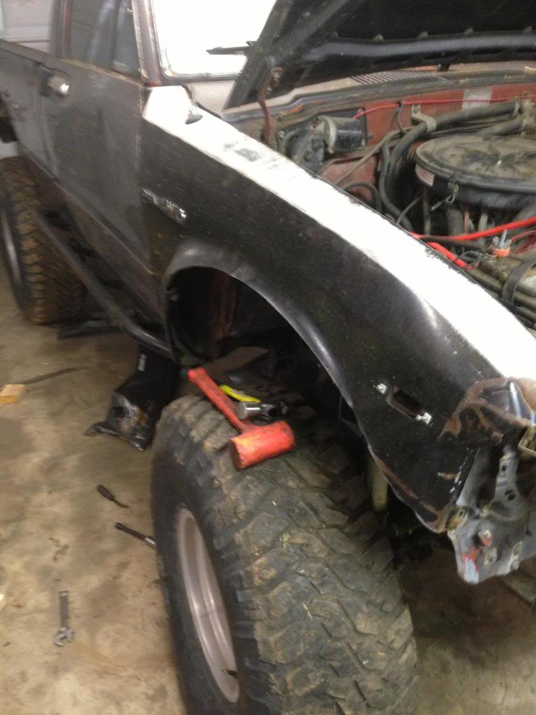

also worked on replacing the fenders and swapping in some IFS hubs and V6 calipers:
they are not perfect but alot better than they were.

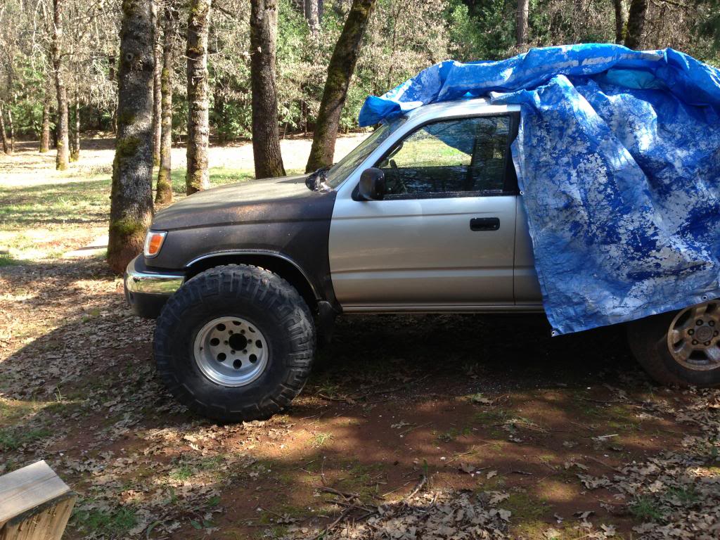

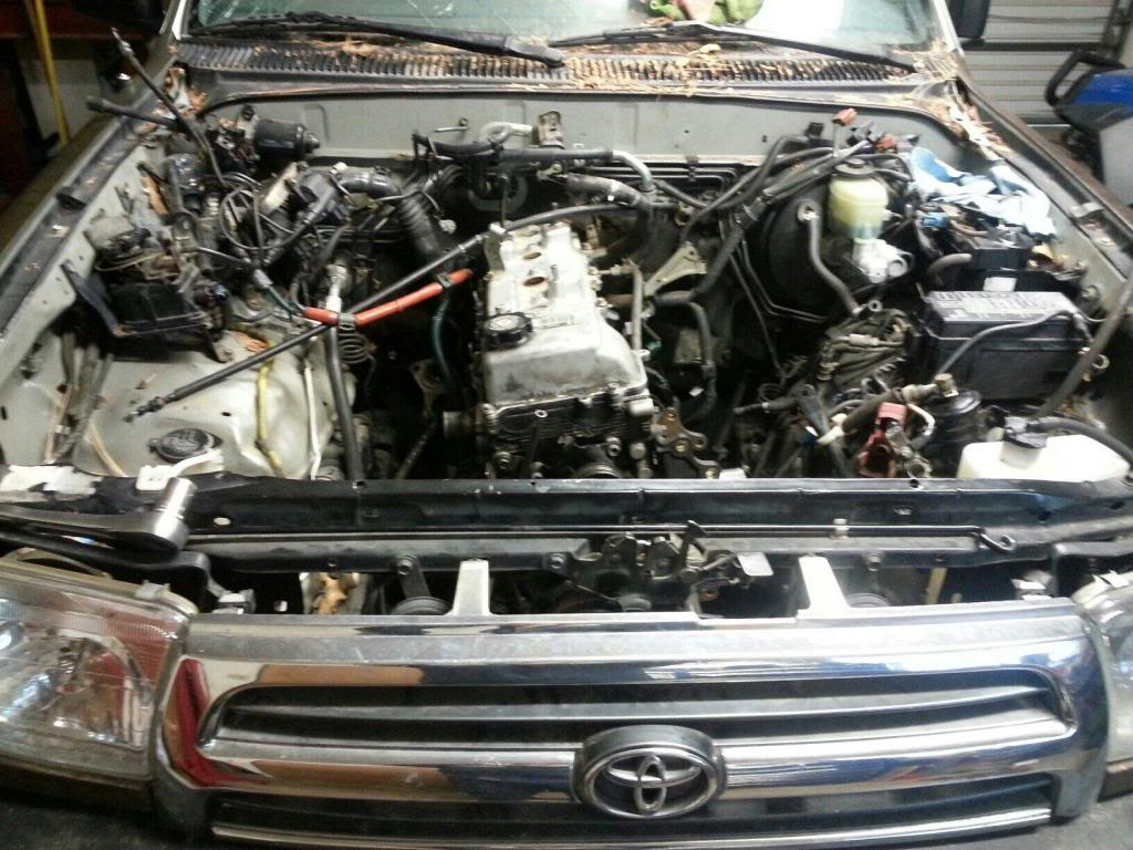

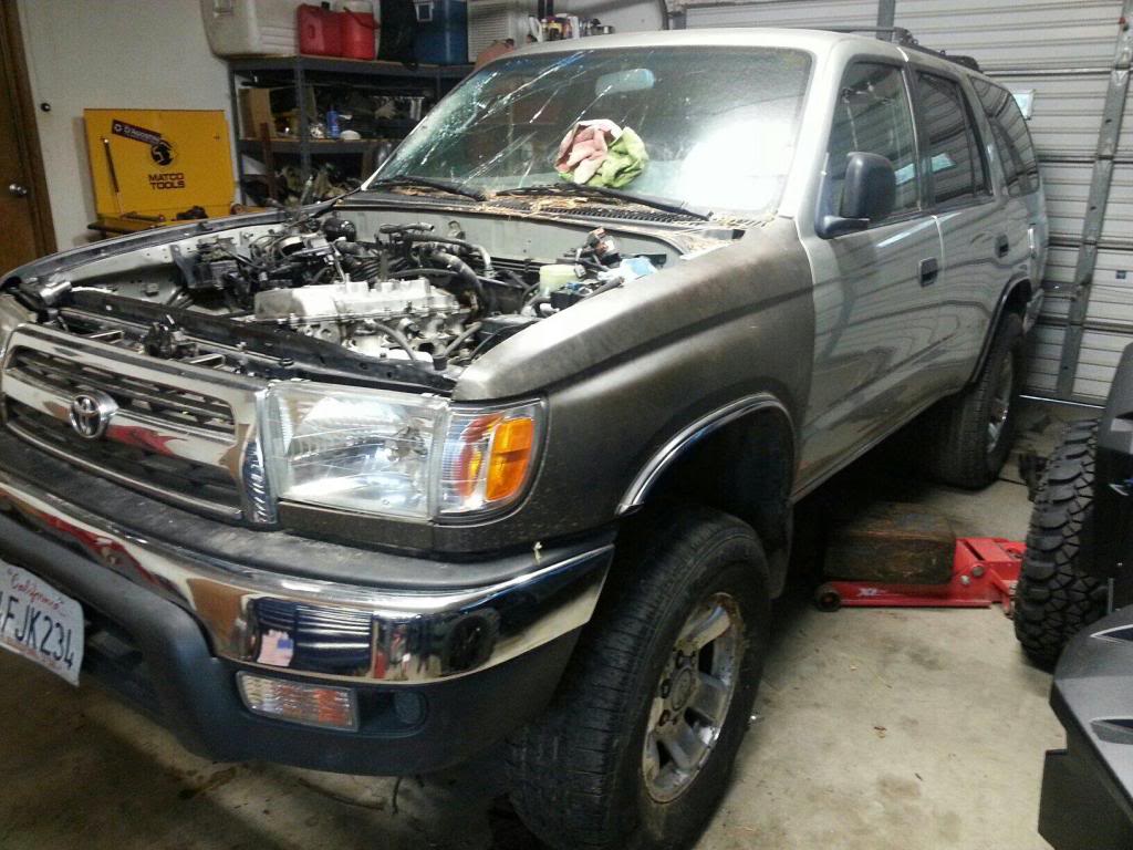

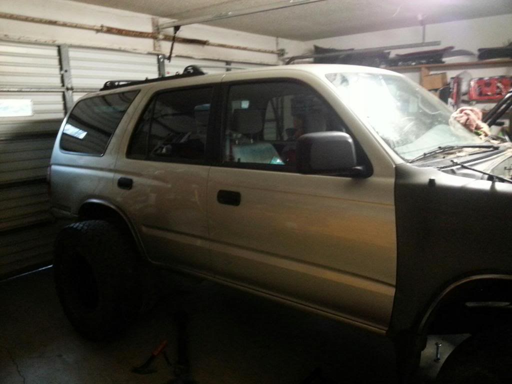

on another note, a couple weeks ago i purchased this trucks replacement.
i found this 99 4runner with a 3rz and auto that just had the motor replaced just needed to be finished hooking everything up:
and a little picture i took with one of my spares for motivation:
plan to use the widened fj 60 front and the FF fj80 rear under the runner and some 37's to make a really good family wheeler. i really needed something with a back seat to haul my girls with me.
hopefully i can clean up the first gen and wheel it some this summer and sell it to fund building the 4runner next fall/winter

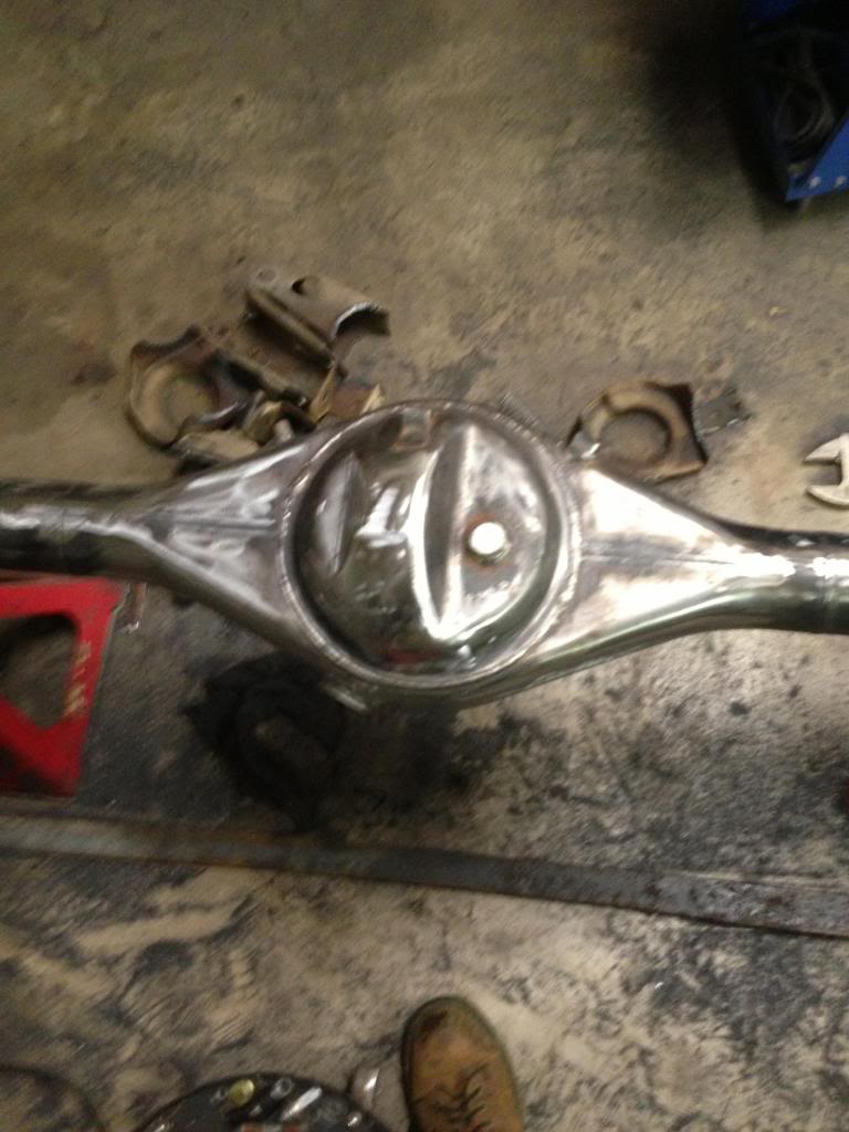

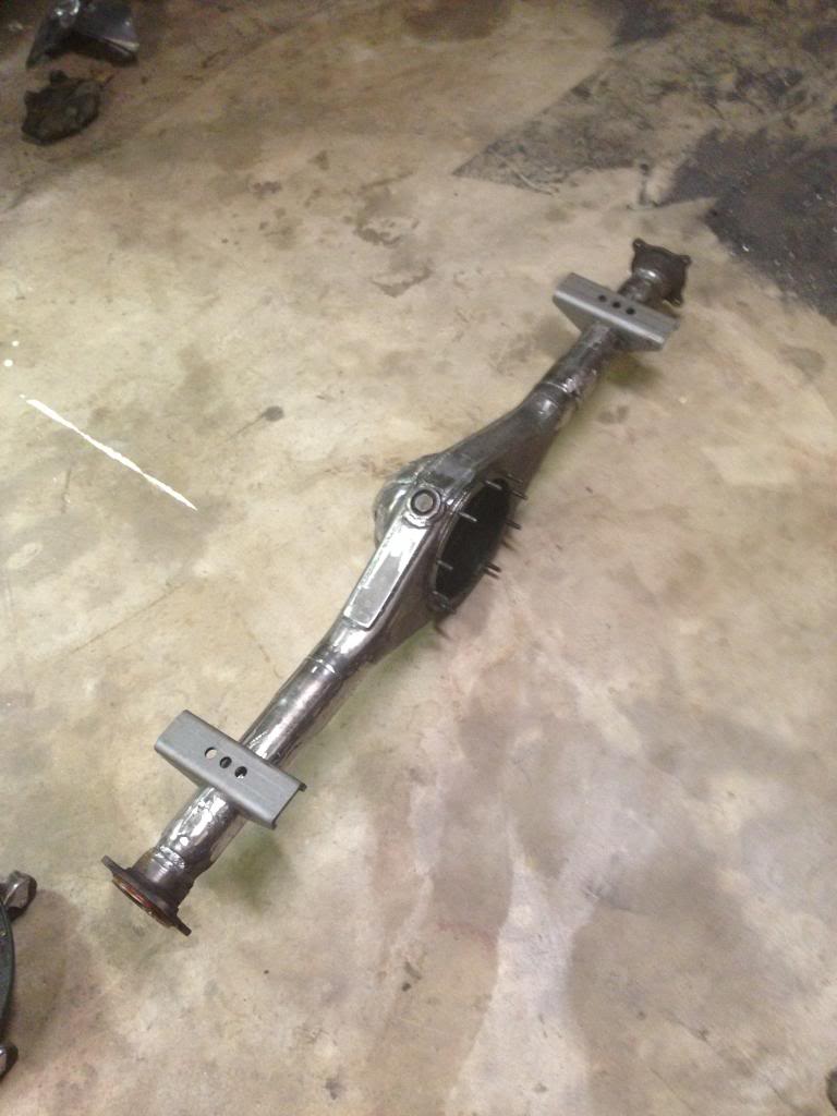

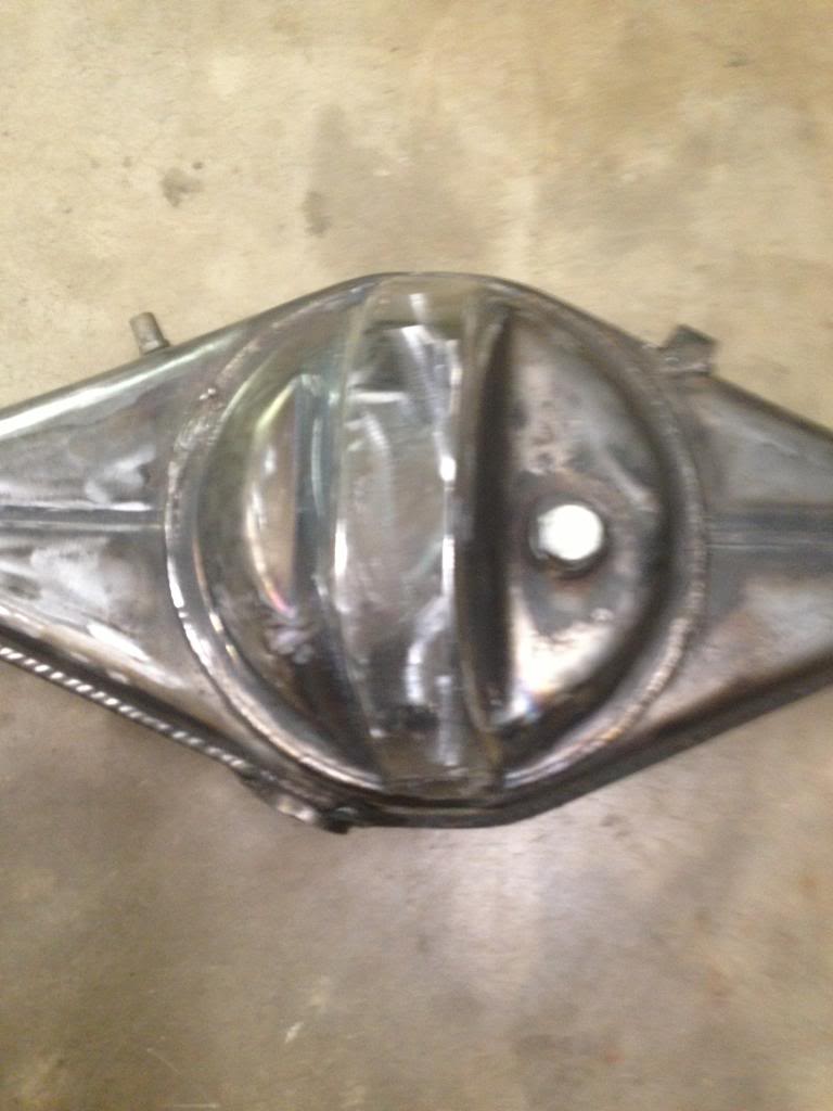

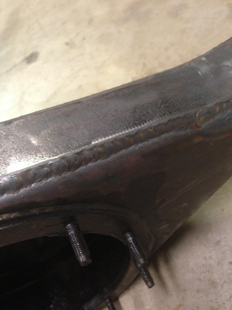

made a little more progress the other day and welded a little protection on the rear axle while i had it out and bought some ruff stuff perches to save time over building some.real easy when i only work 5 miles away to just go pick them up.
pics:
bent a piece of strap over the ring gear (sorry crappy cell phone pic)
and a piece of strap across the bottom
not too bad for not mig welding in about a year
threw the perches on (i know it is upside down) to get some more motivation
then got completely side tracked.....

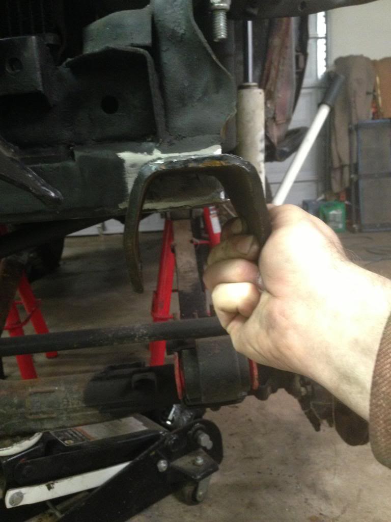

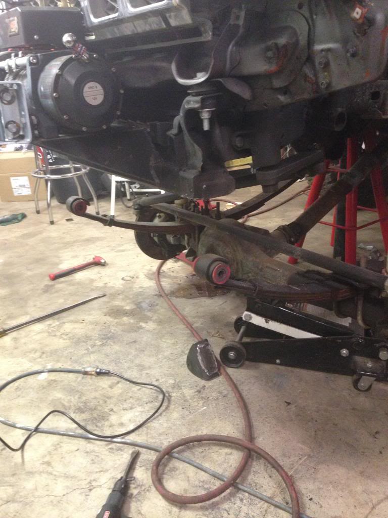

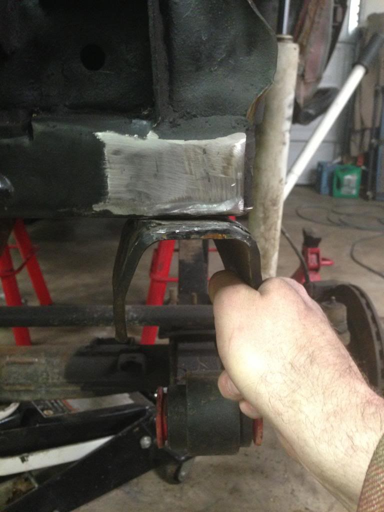

I have never liked the front hanger on this truck and i finally got pissed enough i figured i would cut the perches off and french them into the cross bar to lower it some and move the axle forward about an inch. only problem with a long list of fixes is i cant stay concentrated on one for too long.
pics:
perches cut off, i love the air hammer with the chisel blade, made this way easier
where they were
where i want to put them
hopefully i can get this buttoned up pretty quick as i have to leave for work next week for a while.
pics:
where they were
