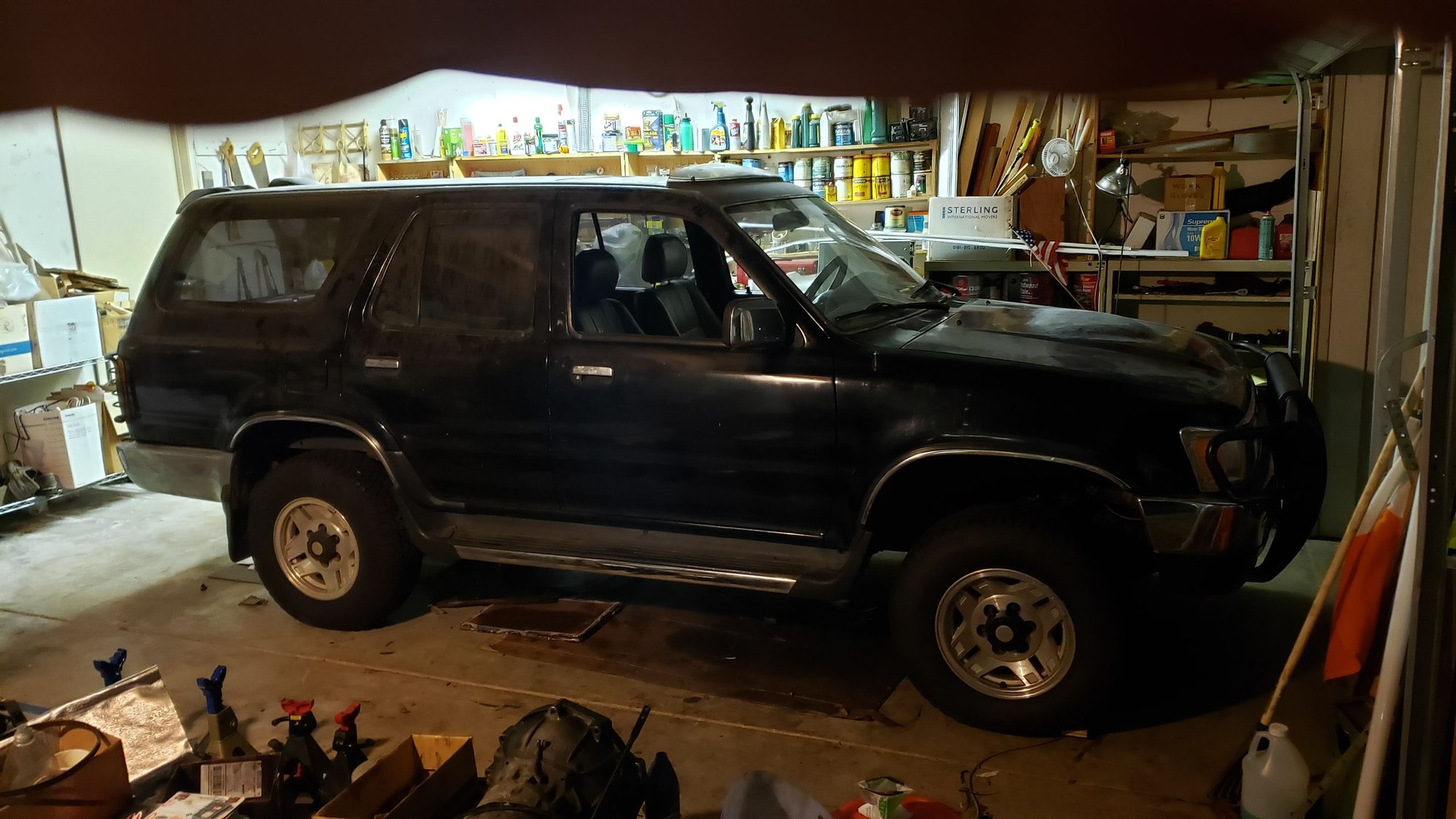

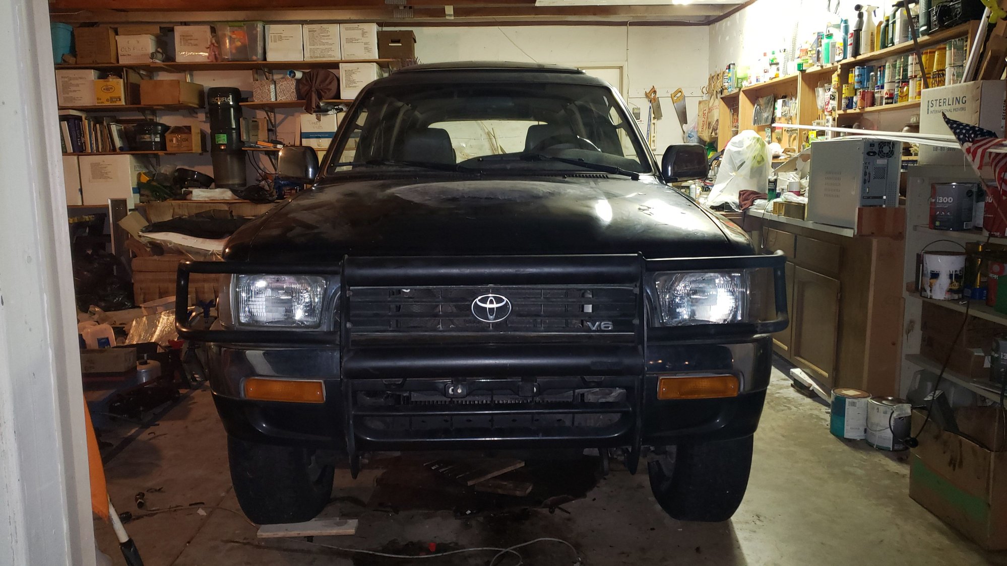

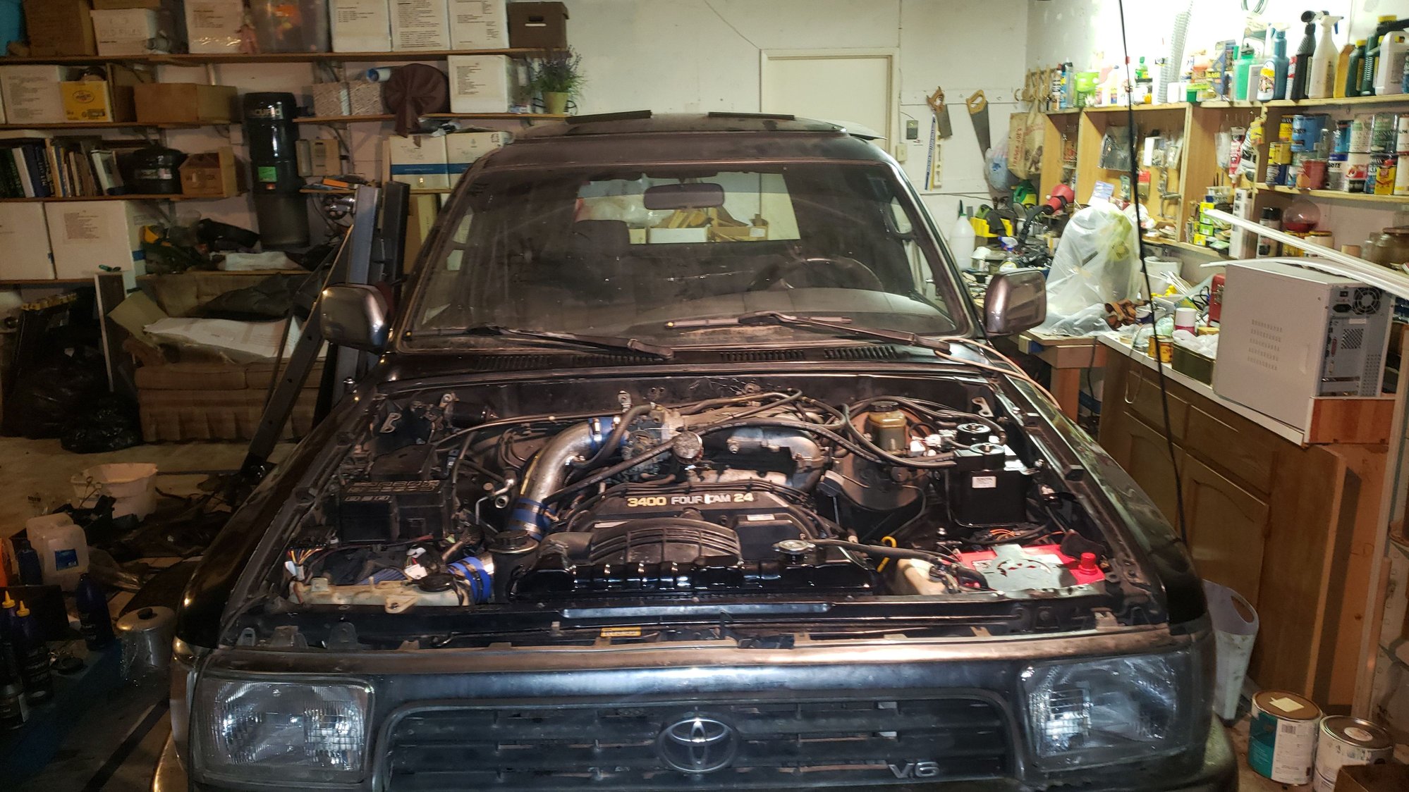

Inlaws garage
Who needs a hood scoop when you've got a 4lb deadblow and some sandbags
Goongala!!
Pretty much set up. Though you'll see a hopeful cruise control thats now gone.

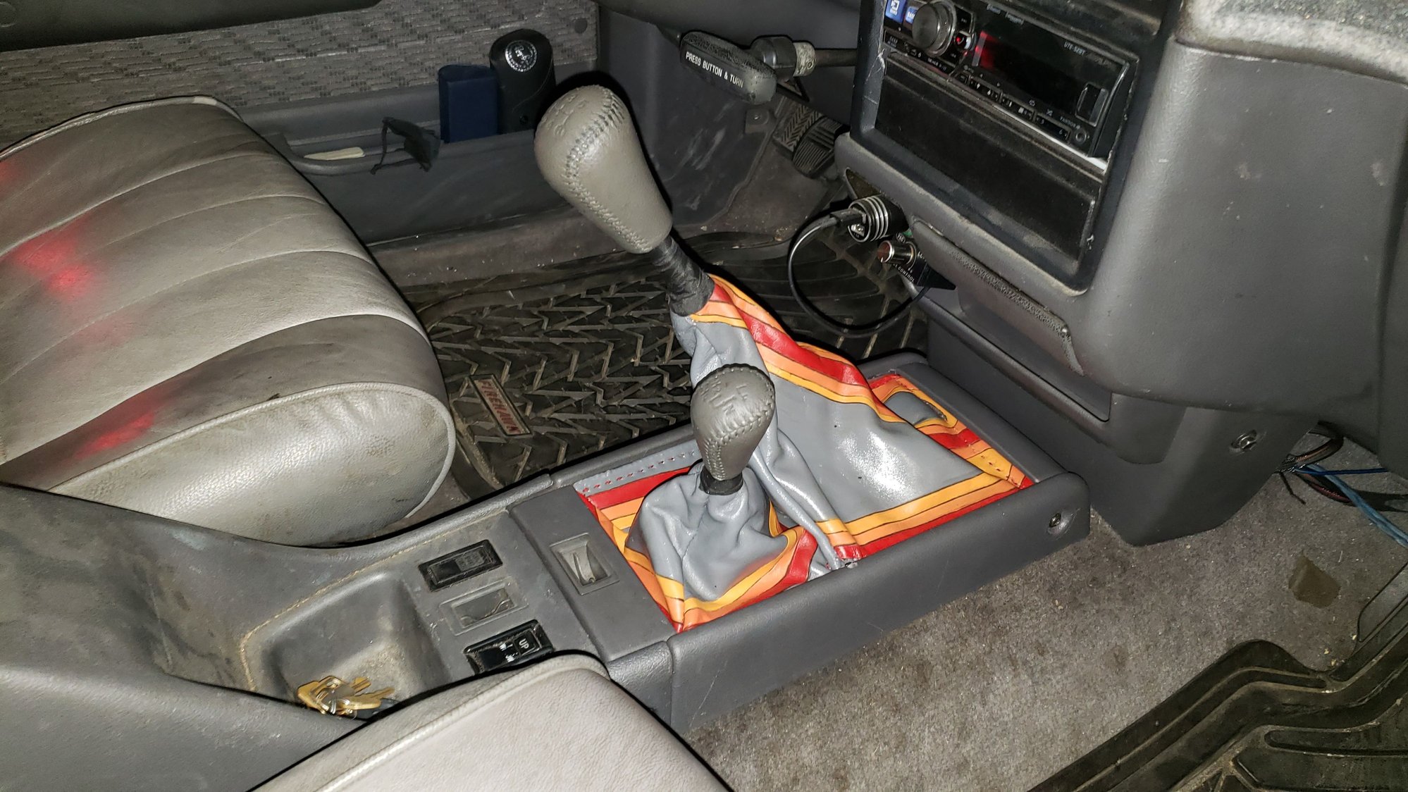

Also, pictures! Rad Yosemite picture, the truck in all its glory just outside of the redwoods, and then a super cool shifter boot a friend made for the truck.

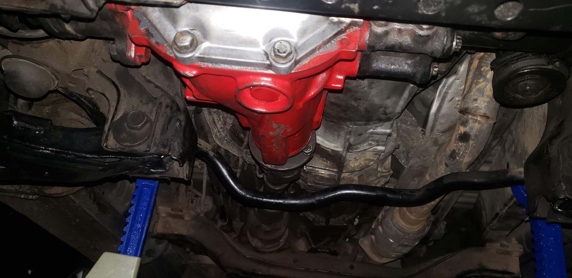

Truck update! Now a year later. The truck has been running great in general. I put an Eaton Trutrac (and manual locking hubs) into the front and re-geared the truck from 4.88 to 4.11, plus a complete overhaul on suspension with new lower control arm bushings, new upper control arms, rear springs, and brand new shocks on everything. A/C is in and running properly. Also, swapped out my rigged intake to a CARB legal K&N to make the DMV happy.

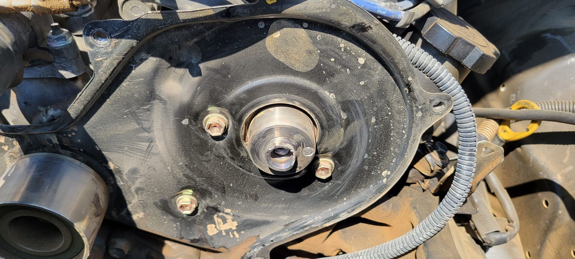

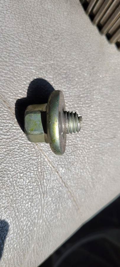

Ran into a catastrophic failure, when the camshaft timing gear bolt sheered off and destroyed some pistons in Big Sur. Found an awesome mechanic in San Luis Obisbo who swapped the JDM engine out and put in a 5 year warrantied long block. (holy ˟˟˟˟˟ was that expensive, thank god I'm employed again.)
It's worth noting, if you get a JDM, tear the engine down to the pistons and put it back together so you know it's correct. The mechanic in SLO said his best guess for failure was a quick timing belt job or camshaft job where they used a pneumatic gun to retorque the bolt instead of the slower more correct way with a manual torque wrench and the specific camshaft nut tightening tool from Toyota. So over time the bolt slowly came out until it snagged.

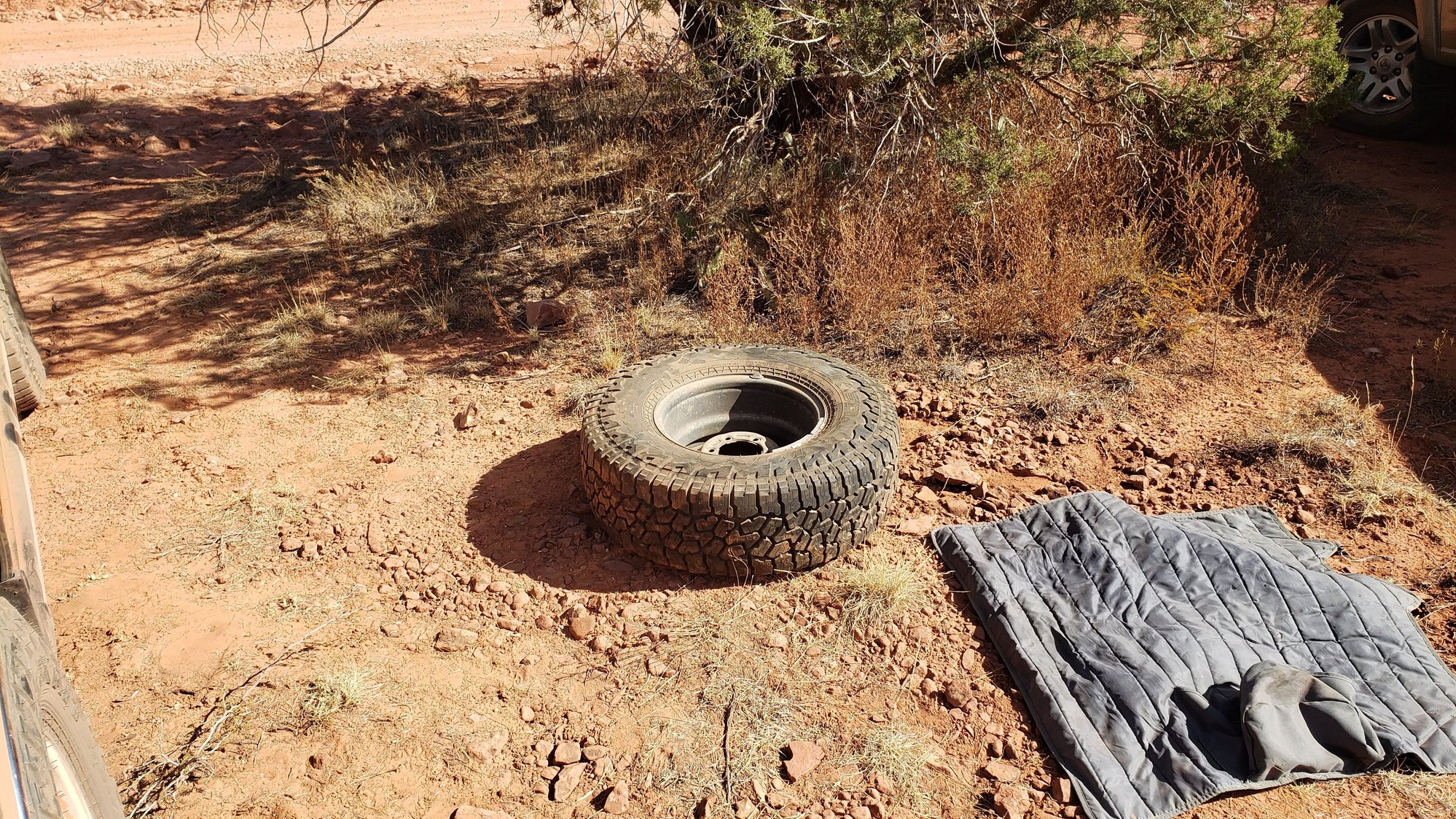

Lost the spare tire getting outclassed in Utah

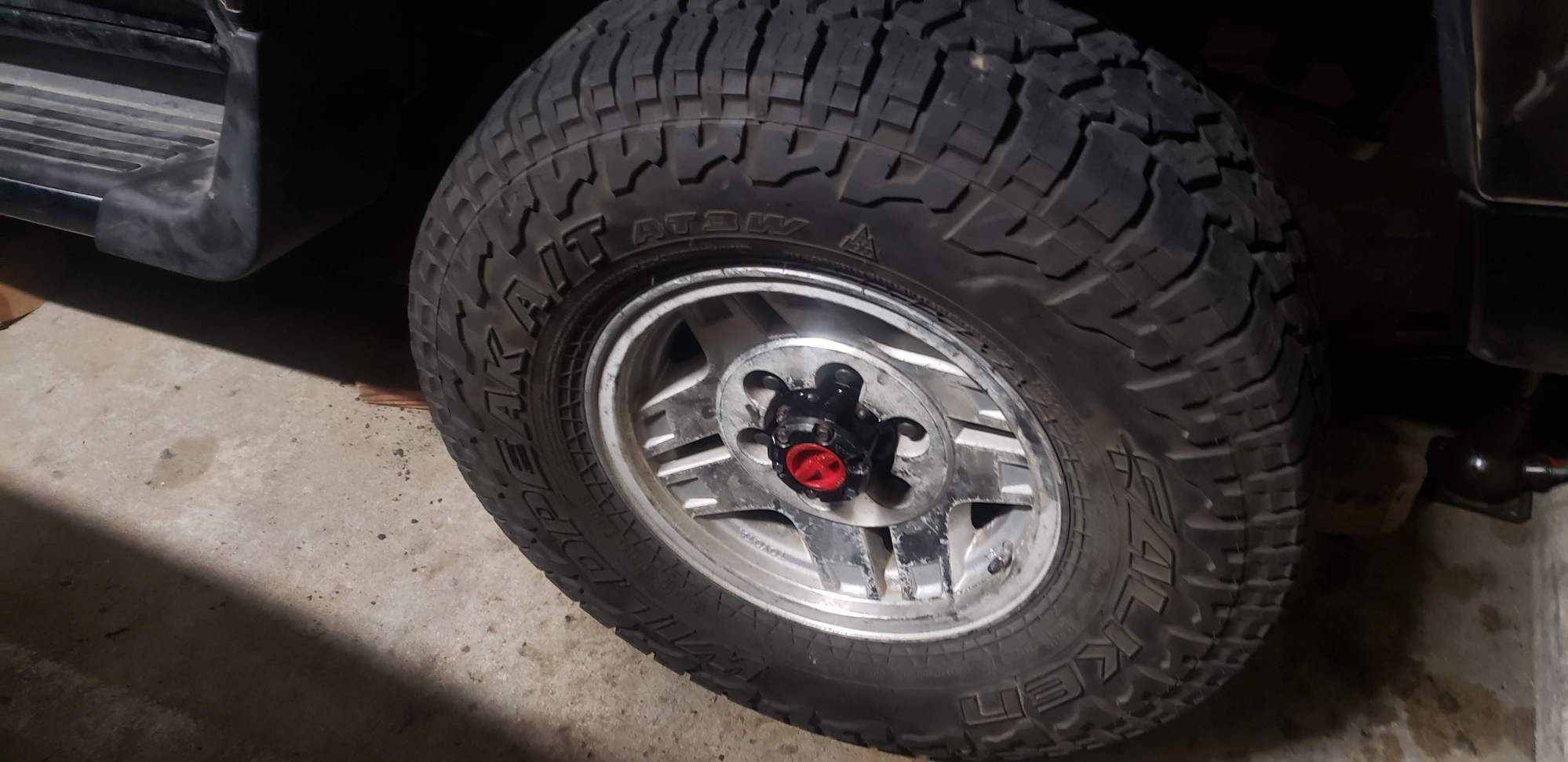

locking hubs to be able to keep the trutrac from always spinning the front driveshaft. Plus they feel cool
fancy paint job for the new(to me) diff.

that's a grade 10 bolt that twisted itself off
Camshaft timing gear just didn't wanna stay attached. The whole failure was rather anti-climatic as the truck just sputtered out.

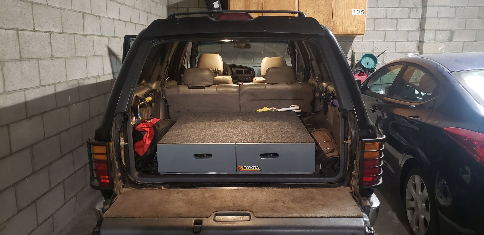

The trip to Arizona was also to build a tool drawer for camping and mechanic tools.

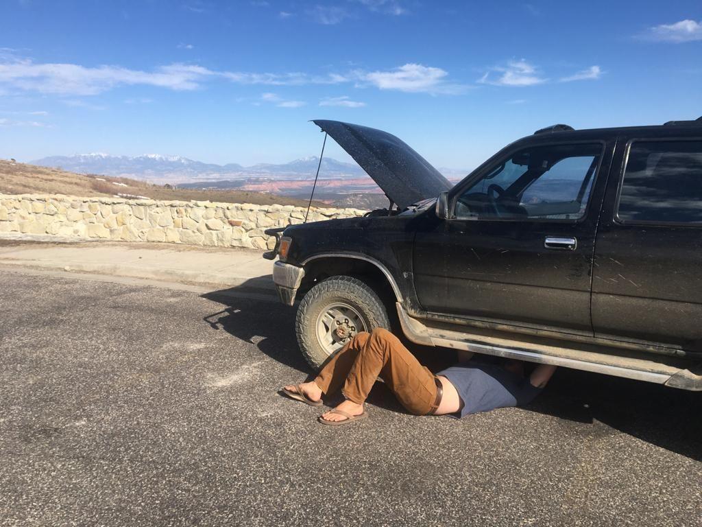

When I swapped my suspension I forgot to clip the O2 sensor harness back to the frame so I melted the wires, and had the truck spazz on me in Utah. I bandaged it up until I could do a more permanent fix.
