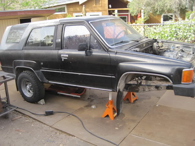

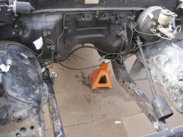

Here's the initial pics:
Blown ugly 22r - this thing had lost a hose, then been driven over a mountain next to Las Vegas in the middle of summer (PO had his ailing mother in the truck and didn't want to stop in the heat). He made it home, but with the truck knocking and clanging like a sonofabitch. Then it sat for 9 years, till I grabbed it:
Engine bay looking better:
IFS gone:

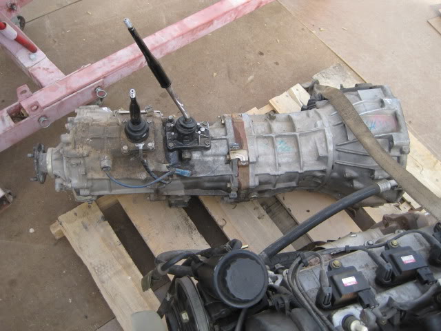

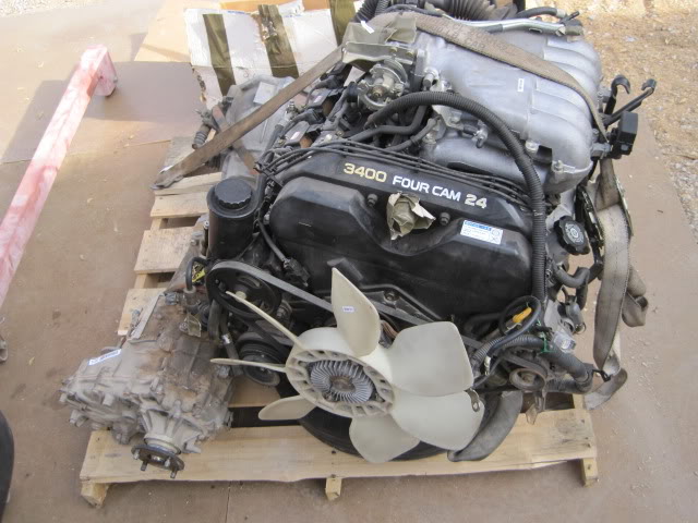

New engine, tranny, other goodies:
Side shot of the Runner:
Transmission:

1)Can ya'll confirm, this is the R150f, correct? Gonna replace the clutch etc. while it's out.
No help on this one...

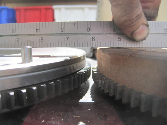

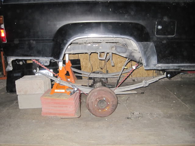

Alright folks, need some help:
Over the past couple of weeks I've been tinkering away - got the rear axle shaved and installed an e-locker, swapped on my chevy springs, reenforced the rear end, swapped timing belt and everything else in there, built my front spring packs and started on a new front drop crossmember to hopefully get my axle where I want it and shackle angles good - photos to come later. But my current problem is this: I ordered a bunch of parts from Davez offroad, including a new clutch and flywheel. The clutch I got looks great. The flywheel however, is a totally different size - the flange is thicker, so I would need longer bolts to make it work, but it's overall 'height' ie. if you lay it flat on a bench, is less than that of my original flywheel. Also, my new throwout bearing is significantly shorter. If you stack everything up - flywheel, clutch, pressure plate, then throwout bearing, there's about an inch difference in height. The clutch fork has a throw that's barely over one inch - I think I have some wrong parts here - maybe wrong flywheel and throwout bearing? Can anyone confirm this? I'm about 8 seconds away from just throwing the old gear back in and calling it good - I'll replace it later on down the road if it dies on me. Here are some photos - can anyone confirm/advise me what to do?
Any ideas?
Spruce
Any ideas?
Spruce

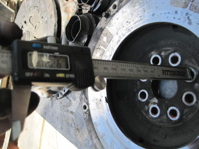

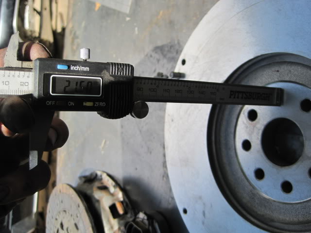

Putting out the next fire... Slapped the engine and trans together, and then dug through the parts boxes that came with all the other engine stuff, and discovered I don't have the bottom brackets/cover plate which bolt the bottom of the block to the bellhousing. So, the bottom of the flywheel is just exposed to the elements this way. Does anyone know if A) These brackets are the same off a 3.0? (My junkyards don't really have 3.4s) Can I just pull it all off something at the junkyard? and B) If I can't get it from the junkyard, does anyone have part numbers and or spares? Thanks,
Got the engine mounts fabbed - it's all ready to drop in - I would like to take care of this before dropping it in however, just for accessibility. But, we'll see...
Spruce
Spruce

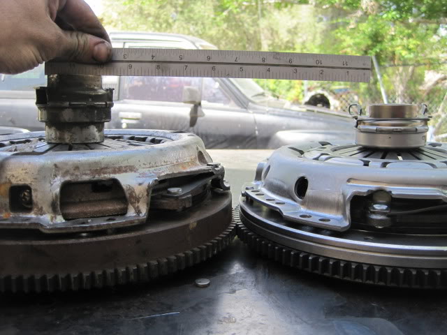

If you are taking about the stiffeners that bolts from the bell to the side of the motor I never installed mine.
If you are talking about the thin flat inspection plate that closes up the flywheel I never installed that either. On the to-do list but haven't gotten around to it. Sas is this next weekend so I'll probably do it then.
most people do about a 2in body lift to clear this egnine but thats in the 2nd gens with the 3.0, have you checked your clerence from the hood to the top of the motor? just another grimlin to tackle while everythings out. dont know if a 22re is taller then the 3.0, figured it would be smaller
For motor mounts I have carefully cut the pads off of a 3.0 frame and after removing the 4cyl ones, reweld them to frame using the motor to help line them up. Here is the basic run down for a 4 cyl swap;
Pull motor tranny,
cut old motor mounts off frame
replace the parking brake cable with 3.0 style to move speedo cable and parking brake cable lower on firewall
Install 3.0 transmission using 3.0 crossmember
bolt engine to transmission-no clutch installed for mock up.
tack weld engine mounts in place
remove engine and fully weld the mounts in.
fully furnished motor goes in minus upper intake
Use 3rz fuel filter and fuel lines to bolt in fuel system
use a combo of 3.4,3.0 heater hoses depending if there is rear heat in 4runner (also switch to newer heater control valve for more clearance.
Finish exhaust,
run wires blah blah blah.

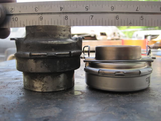

for the clutch stuff, you will need to keep either all 3.0 stuff(flywheel, clutch disk, pressure plate throwout, starter)
or run 3.4 stuff mix (3.4 flywheel, pressure plate, clutch disk, starter, and 3.0 throw out)
You must run the 3.0 throw out regaurdless your clutch setup.
I have also noticed that the 3.0 clutch slave is longer than the 22r/re clutch slave.
some people with the tach in the dash have the adjustable pontimiter which allows them to get the tach working with just a few clicks. Other wise swap to a v6 cluster with a tach and do the resister mod to the tach to get it working. Don't forget to install the 3.0 oil pressure switch from a 94ish 3.0 so it has the correct plug for the 3.4 harness. Otherwish the 3.4 sending unit will fry your guage.
I think that he needs all TACO clutch components.

I am putting a 3.4 and r150 from a taco in my 85 runner in place of my 22re. If you have any questions pm me. I have a thread on pirate where I'm doing somewhat of a build thread. It is a pain in the ass to make hte drivers side cross over work with our frame and the drivers side slave cylinder but can be done.
http://www.pirate4x4.com/forum/showt...1062193&page=2
My hood clears fine w/no body lift. Right now I'm in wiring fun land lol. I'm running 3.4, r150, inchworm adapter, crawl box, marlin adapter, 4.7 t-case.

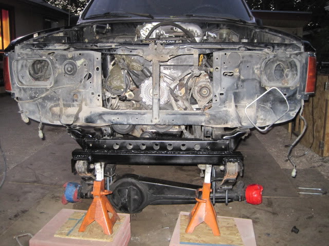

As it sits now,,,

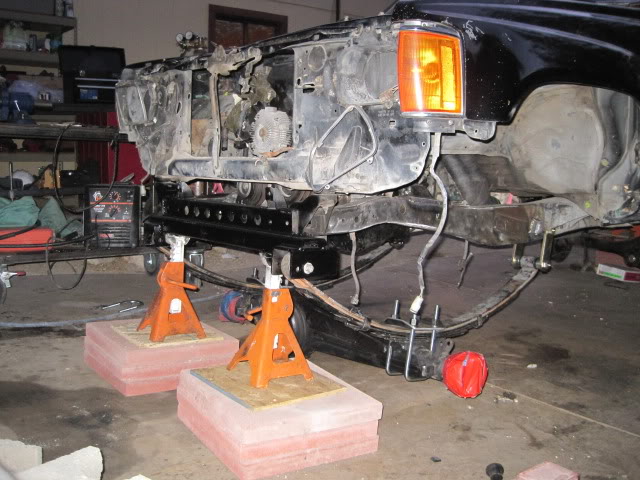

Been tinkering away here and there - here's the progress.
Finished fabbing the engine mounts, burned em in, and got the engine installed for hopefully the last time (probably won't be). Transmission is just held up by a ratchet strap at the moment - I'll be running duals and fab up a crossmember or maybe buy the Sky one.

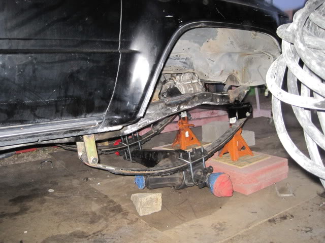

Got the chevy's fully done, but waiting on a U-bolt flip kit to hang the axle. Tried to use the oem U-bolts, and with some grinding could have got it to work, but I didn't want to do that. Ordered the kit, and as soon as it gets here it'll be hung.

I'm running rears up front to help get the axle forward. As such, getting springs/bushings to work with a standard front crossmember was a pain. Your standard rears from I think 84ish on have a 14mm bolt. A standard Trail Gear drop front crossmember uses 18mm bolts. I didn't want to scab on plates with 14mm holes especially, and as far forward as I've been hoping my axle would be, I don't think that crossmember would have been the greatest anyway. So, I fabbed one up - kinda ugly, but it'll work. Still need to box in the ends, and trim/reenforce the back part of the hanger. Got that welded up, and hung the axle housing

Oh yeah - I talked to the guy who originally pulled this motor and trans. It came from a 96 4Runner which rolled on it's side in an accident. The transmission may have been swapped out or something at some point, to explain the slave on the drivers side, or maybe they came that way sometimes??? In any case, this all came from the same Runner at some point. I got the exhaust to fish down through on the drivers side - it's tight, but I don't think it'll burn up the slave - gonna add a bunch of heat shielding to be sure.
Shaved the rear dif, and installed my e locker - not wired up yet. Gonna try and figure out a decent cable option - the chilkat one is sweet, but way too rich for my blood. Hopefully will come up with something without destroying the motors - I'd rather be able to sell them.
I drilled the holes for the shackle tubes a while back and finally got around to burning them in. They ended up being so far forward that the shackles hit the body mounts - nothing a grinder and BFH couldn't fix.
