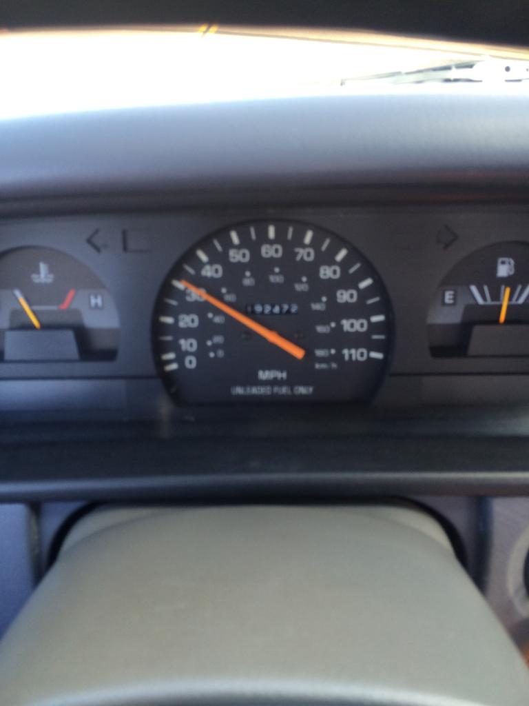

So the speedo on this truck from the moment I purchased it was odd. Bouncy etc...
Its a beater truck, didn't really care much the odometer still worked.
Then the odometer stopped but would record about a mile for every 100 miles driven. I decided to address the issue since I had a P0500 code to clear. I removed the drive gear from the trans and it looked very worn and even damaged in areas (see pic below) then spun it once out of the trans to see if it moved the speedo in the truck and it sure did. Figured no sweat, its worn on the teeth but when spun the speedo reads.

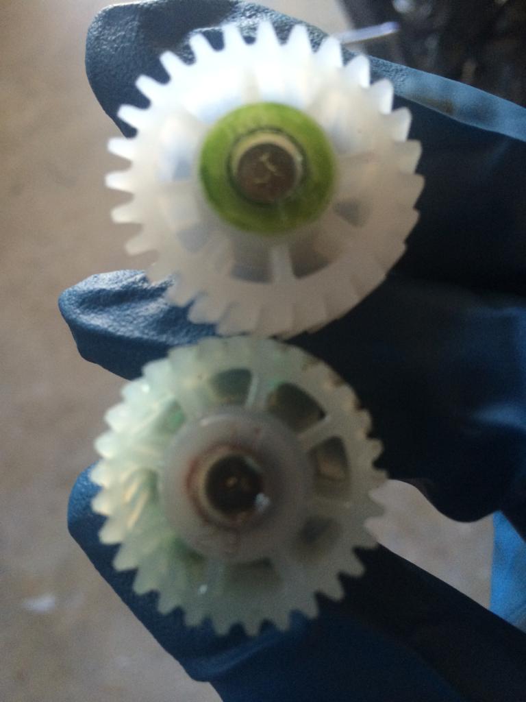

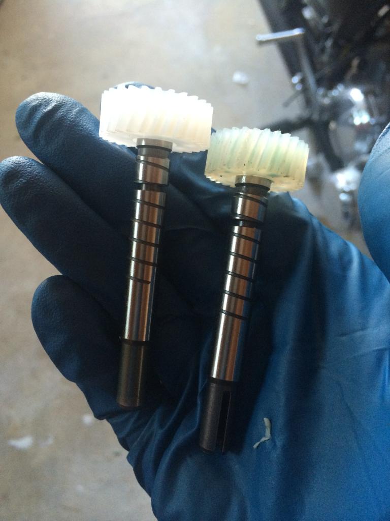

The new gear (11:27 ratio) worked.
Looks like I have a rebuilt trans from a 4runner or older Toyota truck in my T100
While they look similar you can def tell the one gear is larger. The white gear is the correct one.
