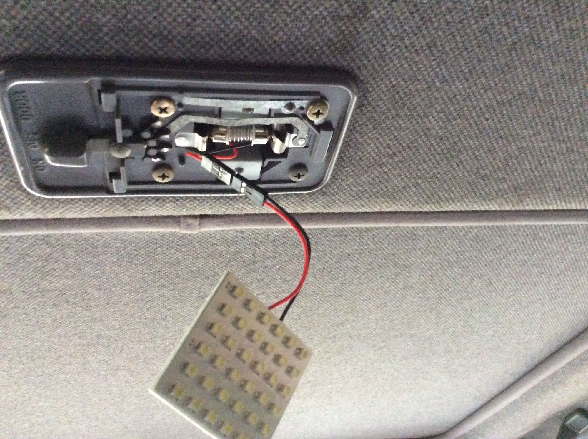

Looks like it should work. In the 2nd pic can't just push it in? You do know the piece on the right moves?
I bought a 36 led panel with a adjustable festoon bulb adapter from Low Range IIRC. Super bright. I'll get a pic of if it when I get home tonight

Let me know how the pics look I took them with my iPad.

BTW, jasonyota, you're my hero. That's the first adjustable led panel I've seen. It's on order now. Thank you!

Originally Posted by combatcarl
Thanks, that what I'm going for, then. I'll look around for one of those. Nice n bright?
Yes it's really bright. I believe I ordered it from Low Range Off Road
