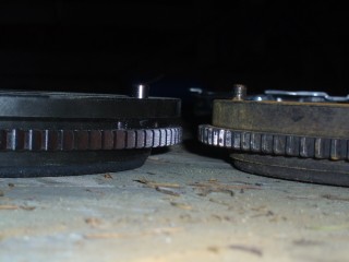

turbo flywheel (L) vs standard flywheel (R)
Attached Thumbnails 22RTE clutch/flywheel in 22RE setup????-p1010010-320-x-240-.jpg

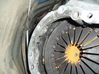

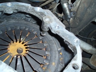

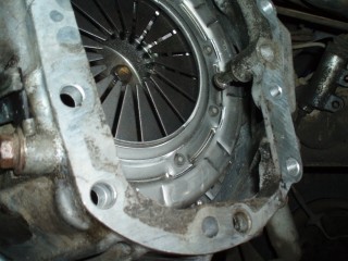

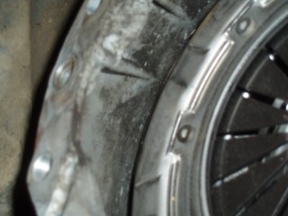

Bellhousing clearance
RE is rusty image 1/2" clearance
RTE is shiney image 1/10" clearance
Attached Thumbnails 22RTE clutch/flywheel in 22RE setup????-p1010013-320-x-240-.jpg   22RTE clutch/flywheel in 22RE setup????-p1010008-320-x-240-.jpg

More clearance pix
Attached Thumbnails 22RTE clutch/flywheel in 22RE setup????-p1010011-320-x-240-.jpg   22RTE clutch/flywheel in 22RE setup????-p1010009-320-x-240-.jpg
