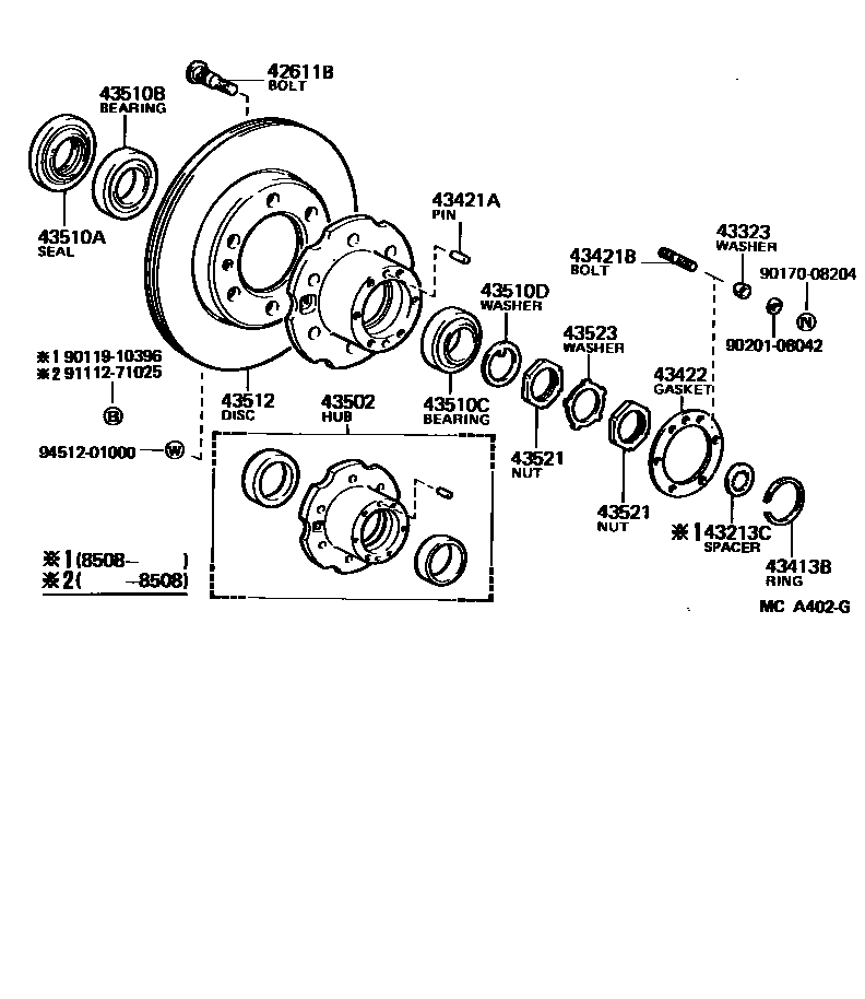

Also, the axle nut or spindle nut, there are 2 of them... the inner and outer before u get to the bearing. The nuts are fine but the tube or whatever it threads to is cross threaded. What is that part called? I cant find it on rock auto. Its the part that encases the cv axle. Is it called a spindle? Since its what the spindle nut threads on to.
43521 NUT, FRONT WHEEL ADJUSTING
43521-60011 you'll need two of them, the inner is referred to as the adjusting nut, the outter is the lock nut.
These connect to the front drive shaft, which you'll probably need to replace also. I expect a tap and die of that size is about the same price as a new shaft.
