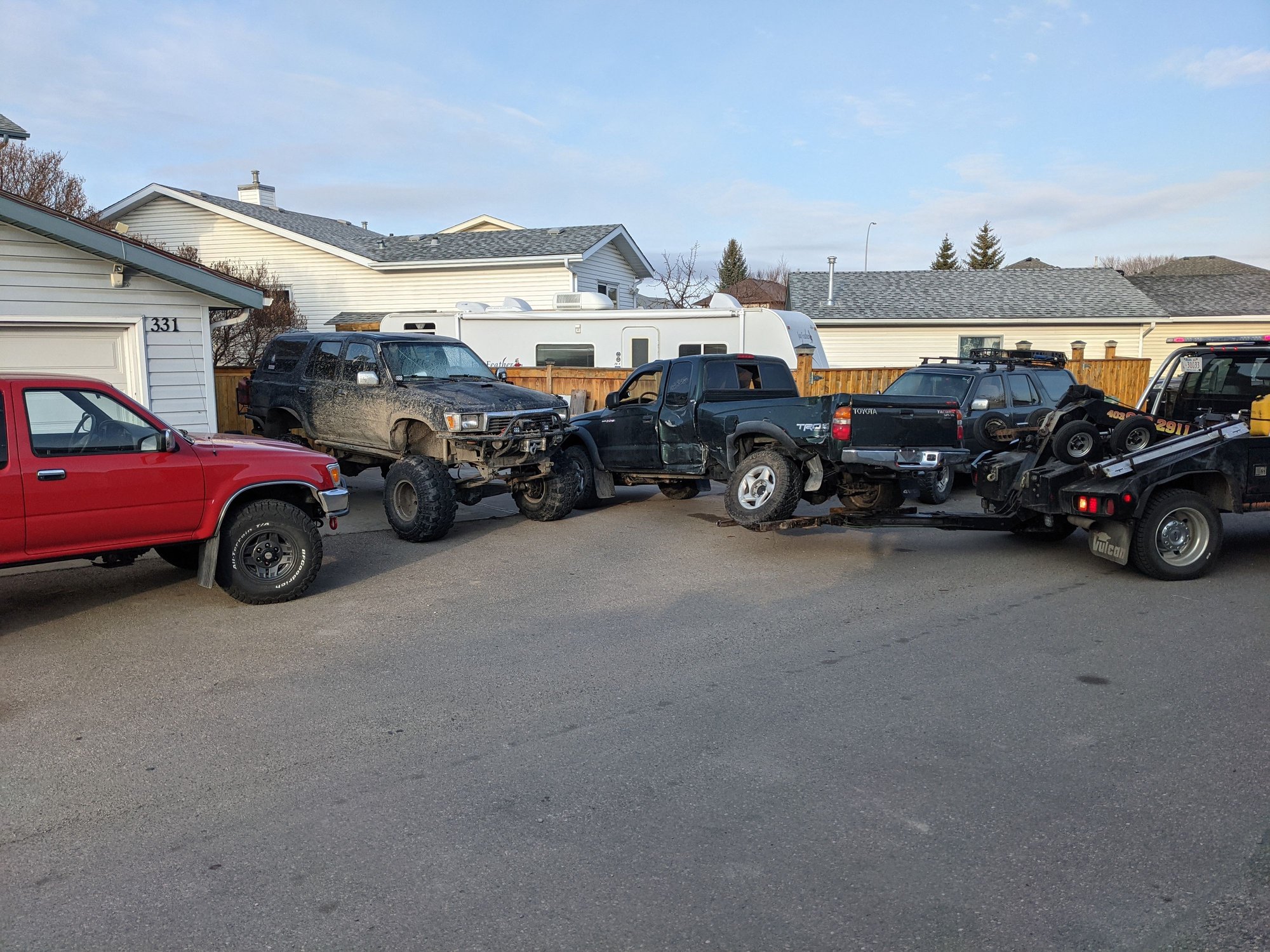

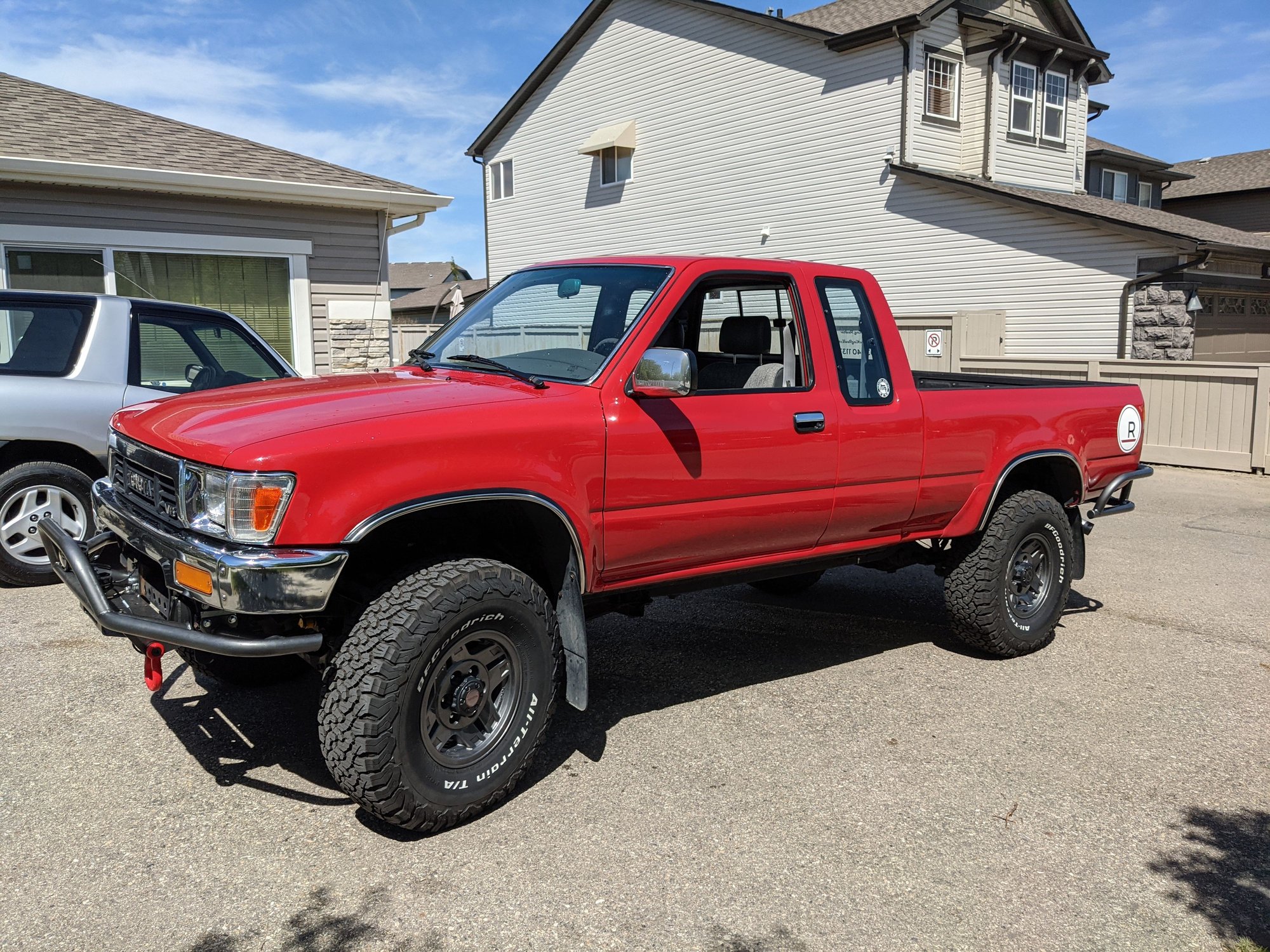

I picked up a wrecked 2004 Tacoma as a donor truck for my 91 Pickup. The donor has only 103000 miles and came with a TRD supercharger and headers.
How much clearance do I need under the hood? Instead of hacking the hood up I was thinking of doing a 1" body lift which will kill 2 birds with 1 stone and give me room for my 33s. Will that give me room?
Smashed up donor in green. Minty recipient in red

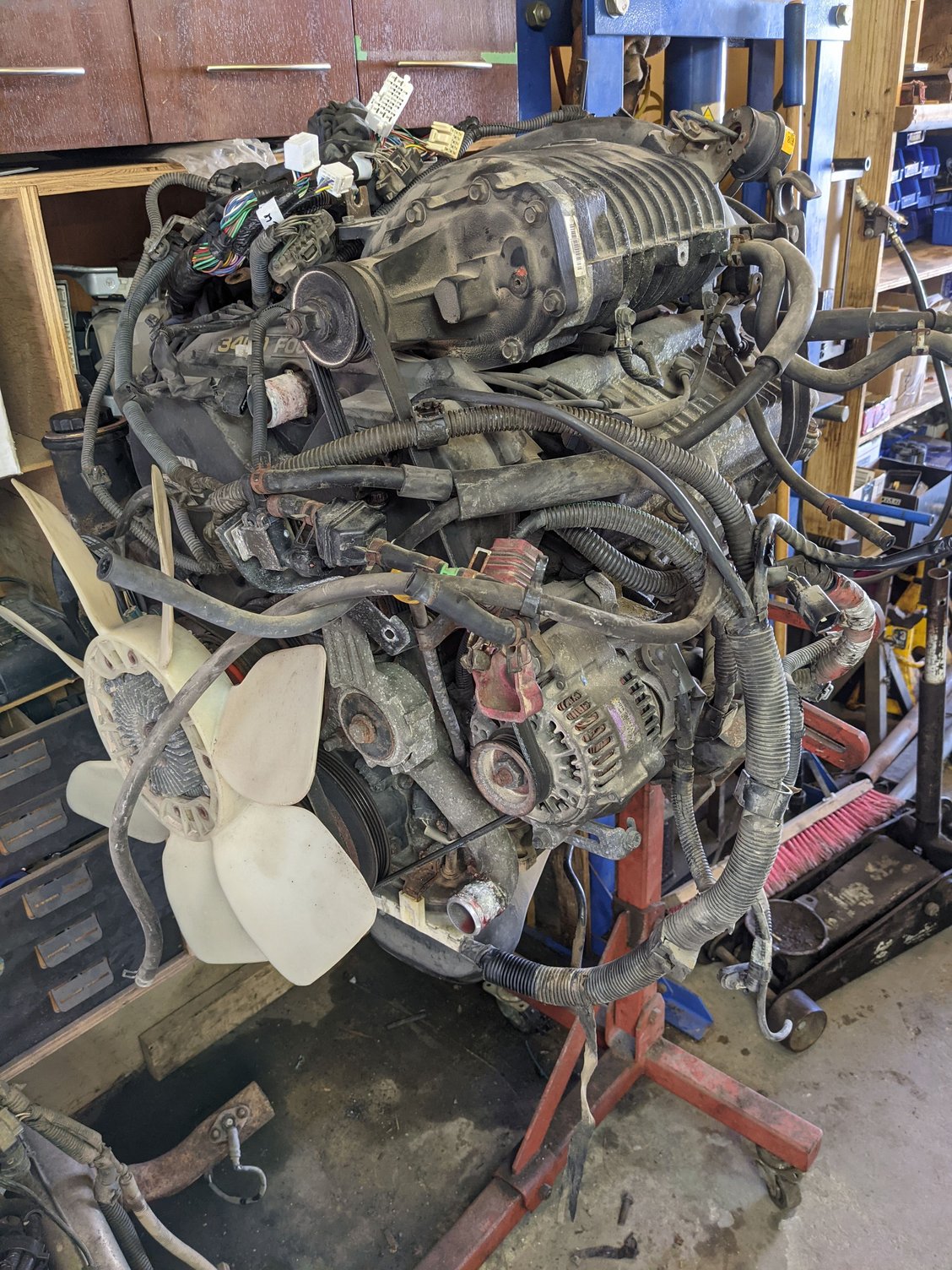

motor is out

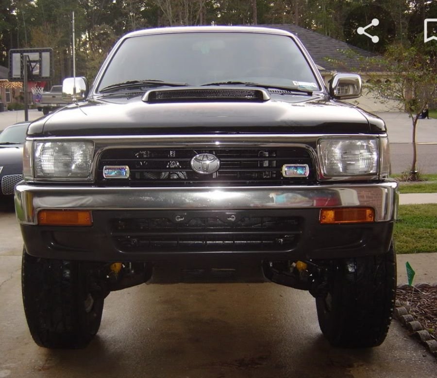

I'd just run a cut hood. I personally think the supercharger snout popping out of the hood looks pretty awesome. Definitely MadMax style
Old Apr 19, 2021 | 12:15 PM
87-4runner's Avatar
Joined: Mar 2012
Posts: 1,139
Likes: 414
From: Oklahoma
Make a cowl hood... most will think it's a fake till you smoke the tires and leave them setting there wondering what the heck is in that thing...hehe
it can look pretty sweet...

Ended up doing a 2" body lift. Couldn't use the TRD headers... they wouldn't clear the torsion bar brackets.
