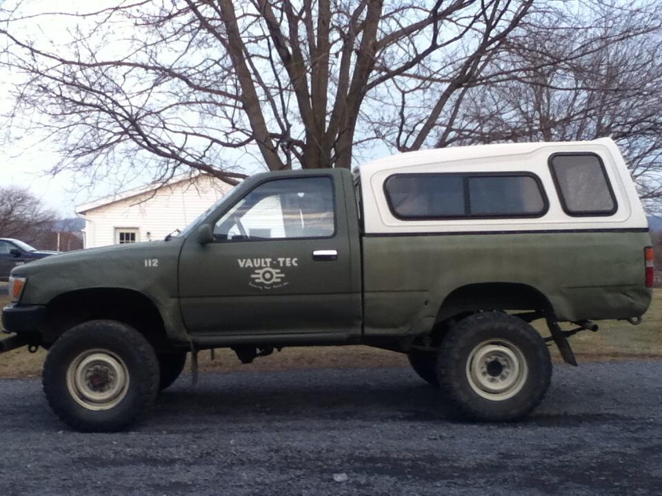

I have a 91 4x4 with a 22r swap. I just did a 3" lift on my truck I bought my BJ spacers on ebay and they seem pretty good. If gave me about 3.250 up front. In the rear I used two extra leaves from a spare set of 4" bds Yj jeep srings. They gave me 3" of extra lift in the rear. This worked out perfect because I don't like lift blocks and I haul a lot of fire wood so they will handle the weight better now. The install was very easy and i came with everything needed. Grinding the UCA was the biggest pain and it wasn't even that bad. It took about 2.5 hours from taking of the last lug nut to lowering the jack when I was done. I still have to fix the alignment.....and I have a set of 33 10.50 15's and some new wheels to put on this weekend. Here are some before and after pics.
http://www.ebay.com/itm/230793060031?_trksid=p2057872.m2749.l2649&ssPageName=STRK%3AMEBIDX%3AIT
BEFORE:
Size:  210.3 KBName:  IMG_3674_zpsw0qxhgri.jpg
Size:  262.5 KBName:  IMG_3675_zpsfy5yziru.jpg
AFTER:
Size:  100.1 KBName:  12606986_10153851822550768_1991203812_n%201_zpstbcuzhpt.jpg
Size:  99.3 KBName:  12596100_10153851822560768_1773314030_n_zpskr40danc.jpg

I think SDORI is one of the original 1.5" BJ spacer vendors and still sells them. I'd go with them personally, oh wait I did.
I say if you're gonna install BJ spacers and then loosen your t-bars and drop the front back down 1-1.5", no need to touch the rear. My truck was super flexy when I did that and removed my swaybar blazen8 of blazeland has shown a bunch of research here on IFS and says skip BJ spacers, they're kinda pointless...I don't disagree with this.
I like the "Vault-Tec" logo. Awesome game
