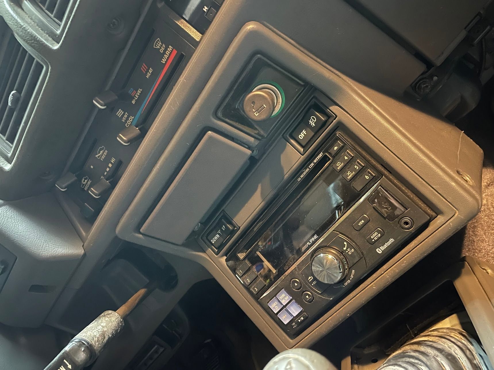

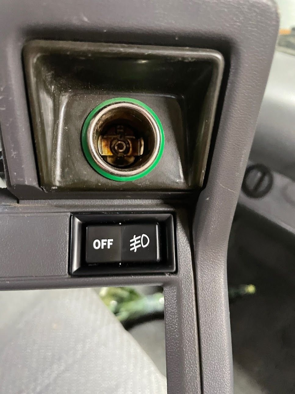

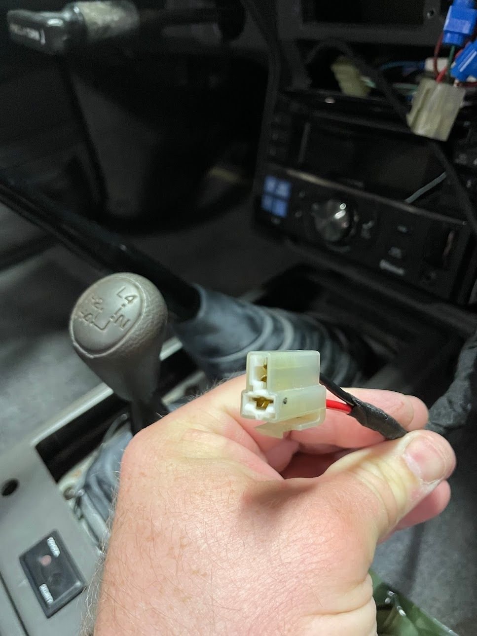

Been wanting to get some aux lighting on my rig for a while but I hate the crappy switches that come with them. Read somewhere that the 70-series Land Cruiser fog light switch works. Well it does, but it's upside down. You have to trim the opening to match the guide on the switch. Otherwise it works perfect. I also picked up some connectors from an 80 series at the junkyard and so now the connector to the switch looks factory.

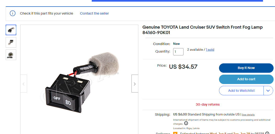

Part number for the switch is 84160-90K01

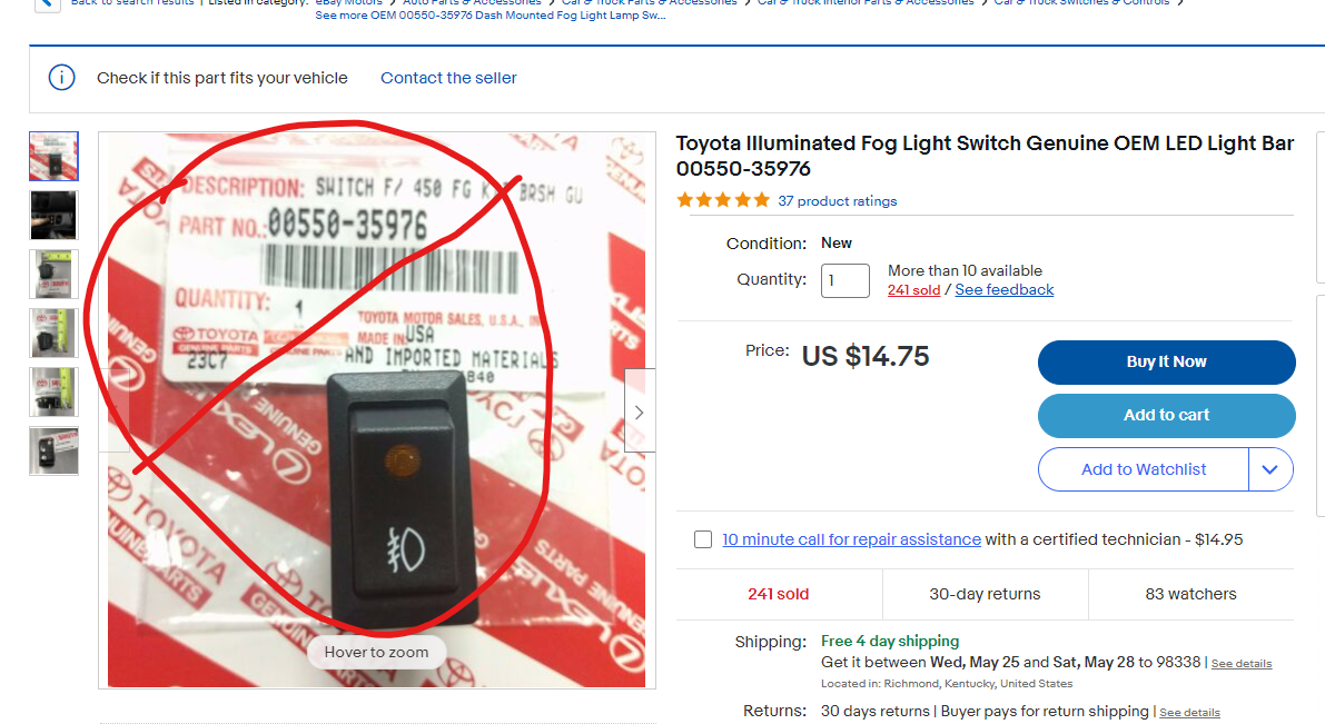

There is also another OEM, more universal switch floating around (00550-35976). It's cheaper, but my OCD got the best of me and I pulled it out because it doesn't sit right in the insert and looks like crap in my opinion.

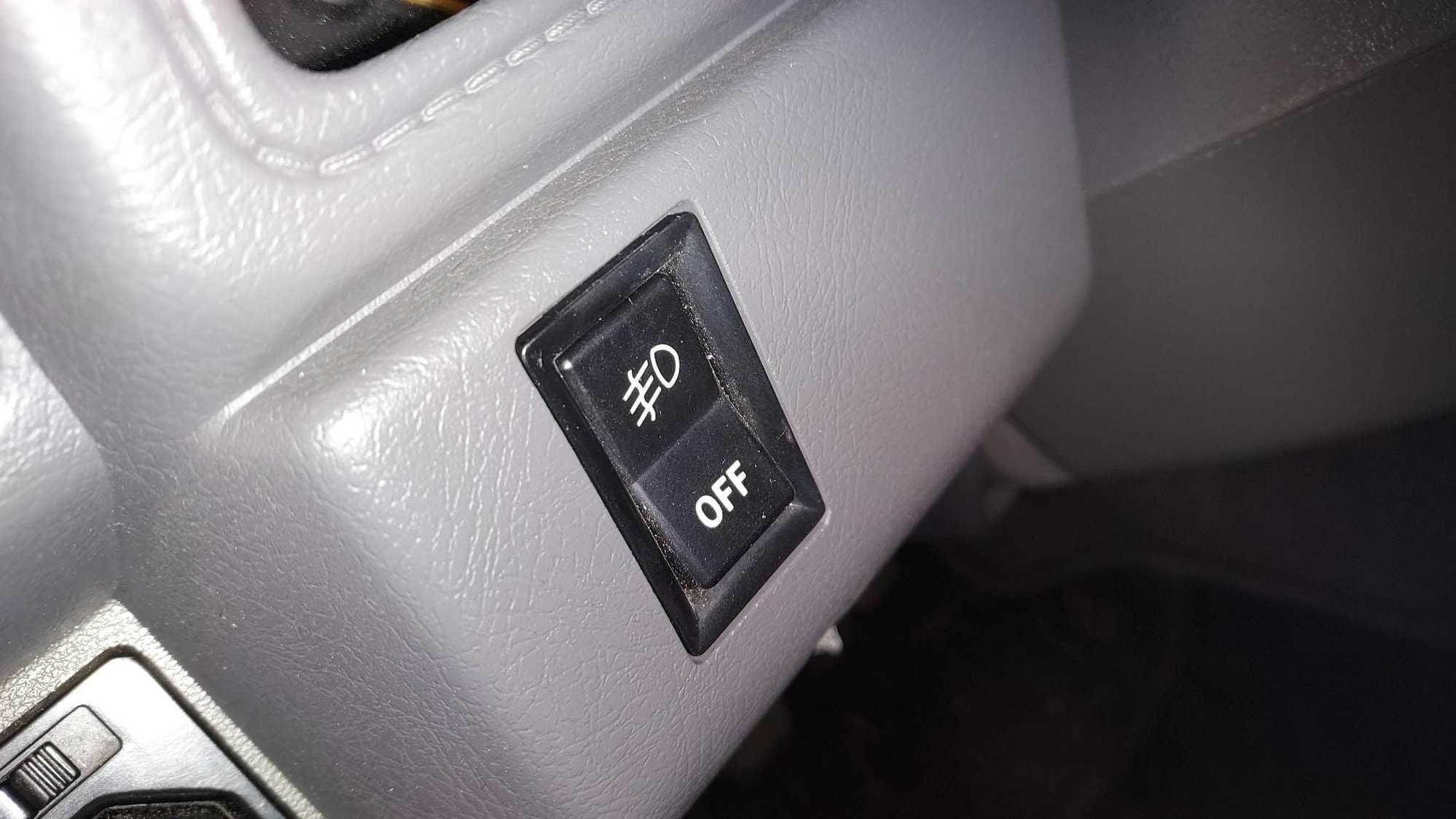

It looks good. Other option are the fog light switches from the Toyota Hiace, no trim required in this position (my 4R does not have the "Clutch/Start/Cancel":
that looks good. Didn’t even know about that switch. But I do have the clutch start cancel switch so it wouldn’t have worked for me. Does that one light up at all?

I do not know, I did not install it yet, I will report after that.
