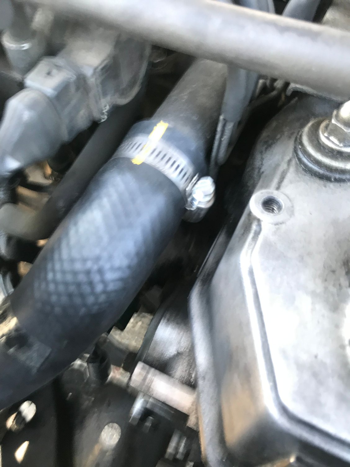

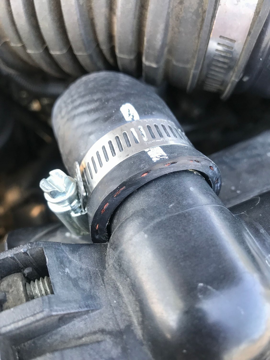

SIZE 20 worm drive clamps for the radiator hoses are the perfect length a lot of time peeps use size 28 not good to looooooong .just a FYI for u guys

Or just use the correct size spring clamps.

Those spring clamps are scary if you don’t have the right spring clamps wrench
no thanks lol

A wide set of vice grips usually work fine, but the spring clamp pliers with the flexible head on a wire are amazing for getting the ones in tight places. You can get a fairly decent one for cheap. Worm gear hose clamps will chaff your hoses over time.

Worm drive clamps can be over tightened. PO on my truck used them all over. They can cause flat spots and turn the round nipple into a D shape. In my case, that actually caused a leak. Springs clamps work just fine.
That being said, I do keep a few worm drive hose clamps with my ZipLock of spare nuts and bolts in the truck just in case.
