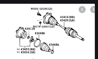

Anyone have the correct p/n for the 17mm nut that connects cv axle to the differential flange studs?

Do you meant the 6 nuts on each side? They are 17mm or 14mm? Those nuts are
90179-12047

Yes those are it, I couldn't find a diagram for squat that contained the studs or the nut.
Thank, very much
