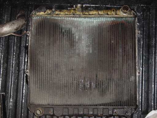

tampabayota's Avatar
Joined: Jul 2006
Posts: 460
From: TAMPA BAY
mine has an extra outlet tube i think it went to the turbo im not sure
Attached Thumbnails Any one know if turbo engines require a special radiator-dsc00033.jpg

The turbo radiators have an extra connector for coolant return, as mentioned above. If you bought a 3-core radiator, you could have any radiator shop braze the connection on there...
