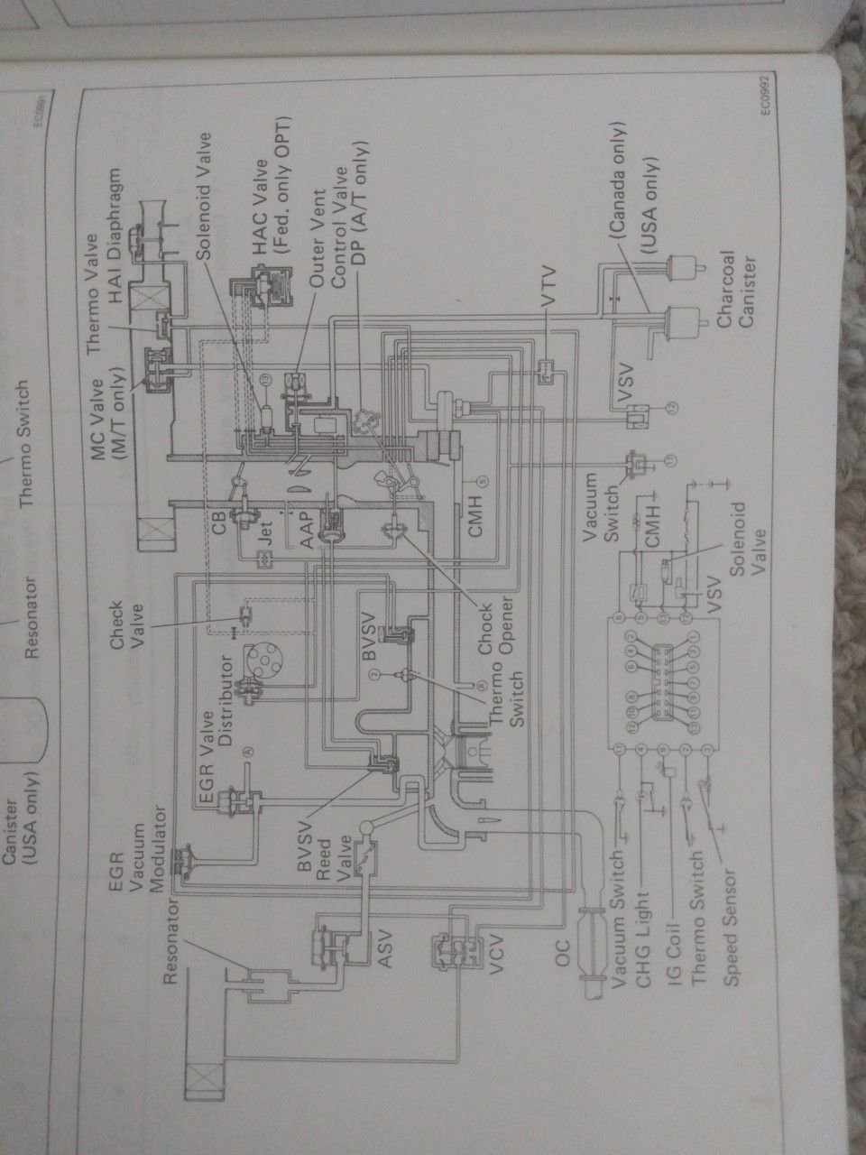

Just installed new carburetor but I need the location of the vacuum lines…anybody have suggestions. I try YouTube and no luck whatsoever.😔

From my 1986 Toyota 'orange' shop manual, carb section:
