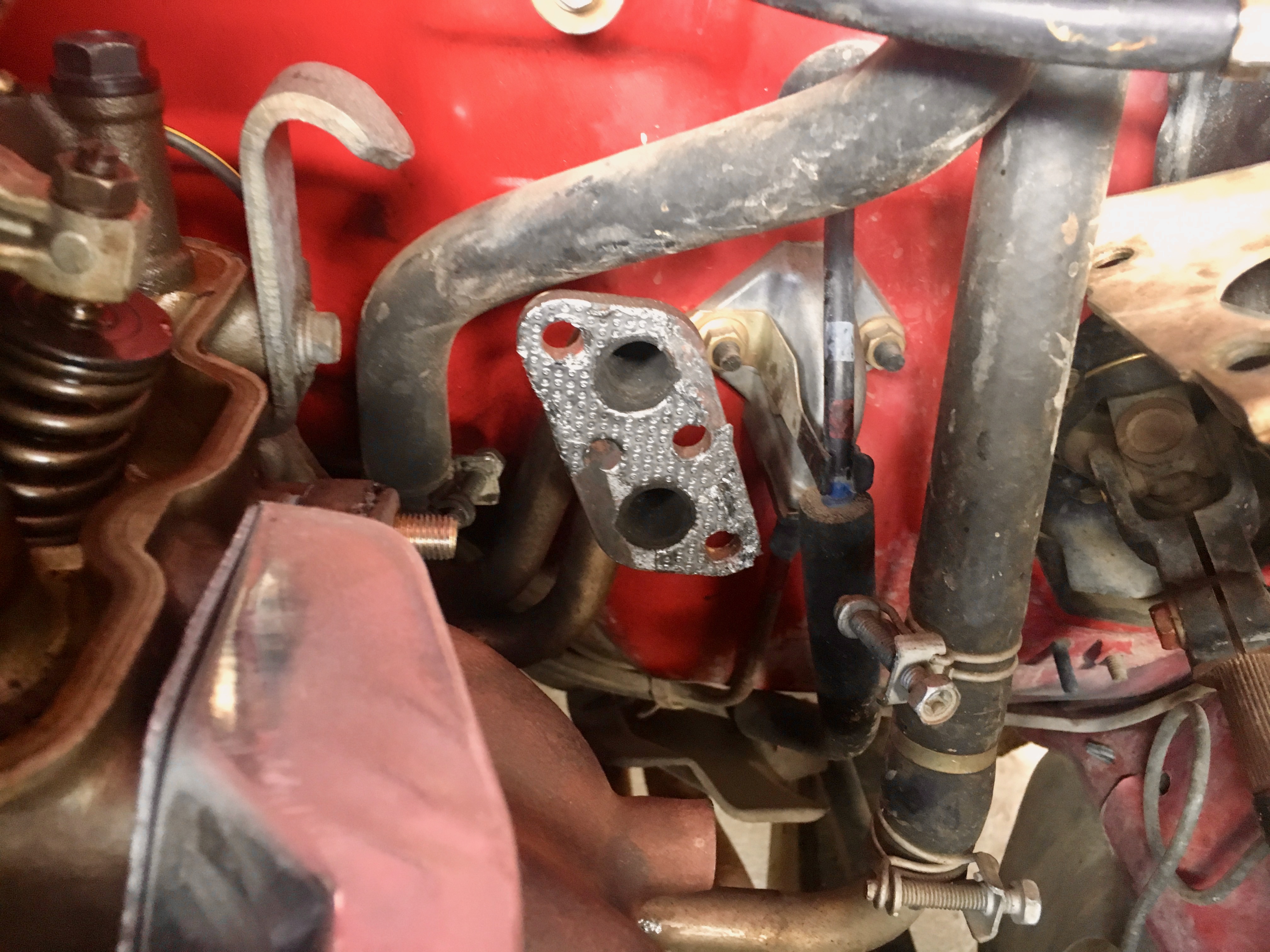

22R What is this gasket called and where can I get one?

Id say that looks like the EGR system.
lookup EGR gasket 22r(e) 19xx
i got one off of Rockauto or partsgeek.com i believe
OR
use permatex gasket maker, if your good at applying gaskrt maker its really the same.

That set of tubes is part of the exhaust manifold air injection / air suction system. The EGR passages on the exhaust side are inside the head casting itself.
From https://22reperformance.com/faq-diagnostic-info/
The gasket you have pictured is called "Gasket, Air Tube, No. 2" (I know, very descriptive!) reference number is 17377 in the diagram below.
Here is a link to the part. I believe this gasket is a dealer only part and might be easiest to find at your local Toyota dealer.
http://parts.lakelandtoyota.com/p/TO...737735020.html

Perfect, Thanks old87yota.

With a sheet of gasket material from the auto parts store and literally 2 minutes of your time you can fabricate it. put the gasket paper on the part, lightly tap with a ball peen hammer and it will "mark" the edges where you need to cut with scissors/razor blade. otherwise, it's like a $2 gasket.

I got one from 22REPerformance for $7, I think being 3 inches away from the exhaust manifold and then running directly in it I will go ahead and put the correct high temp gasket in there.

but thanks for your double up paper gasket short throw I did it in 5 min mod, you ppl scare me.
