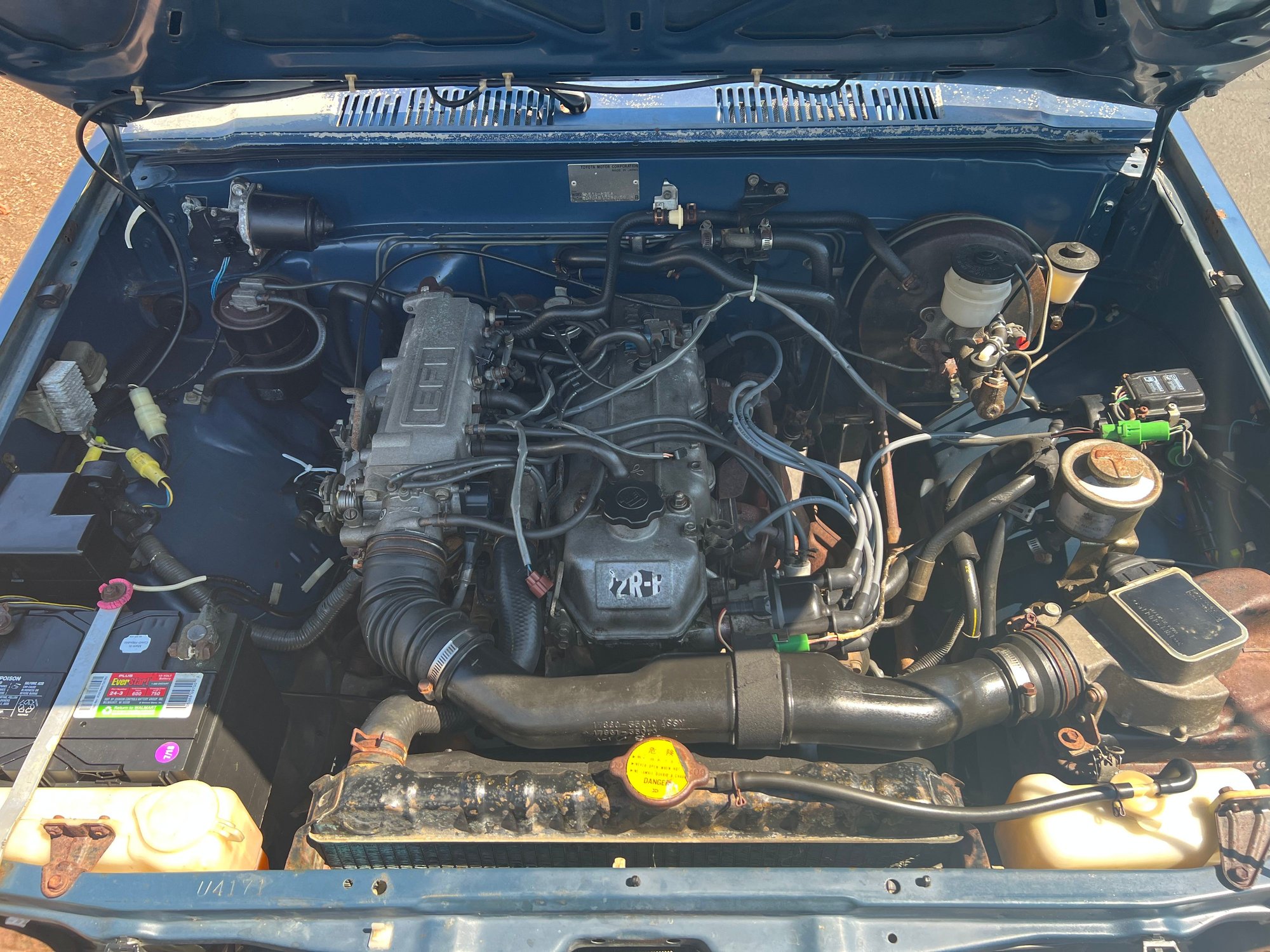

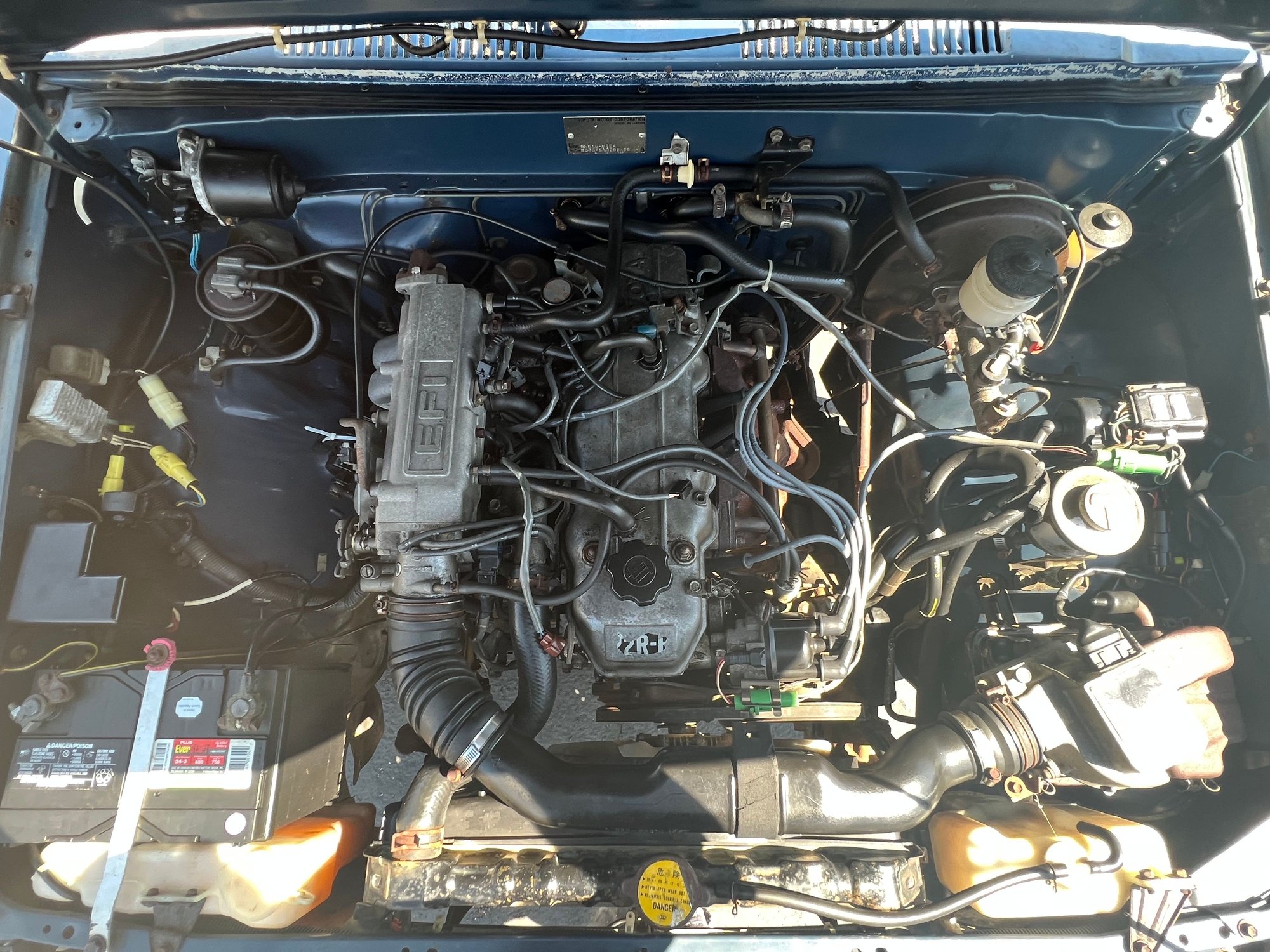

From looking at the valve cover picture from your other thread about connectors, some engine parts have been swapped out in the past. Your valve cover is from a 1984 or earlier engine. The rest of the engine may be from an older truck as well.
Post up some "engine bay" pictures and take a picture of the engine block under the exhaust manifold ( as best you can).

I hope these are good enough. Sorry that wasn’t as much room on the exhaust side to look through. (Update) Just figured out that they used a 22r block. It looks like a pre 85 block because I didn’t see the laser block thing people were talking about. So would it make an 83 or 84 block sense they were able to put the efi system on?
