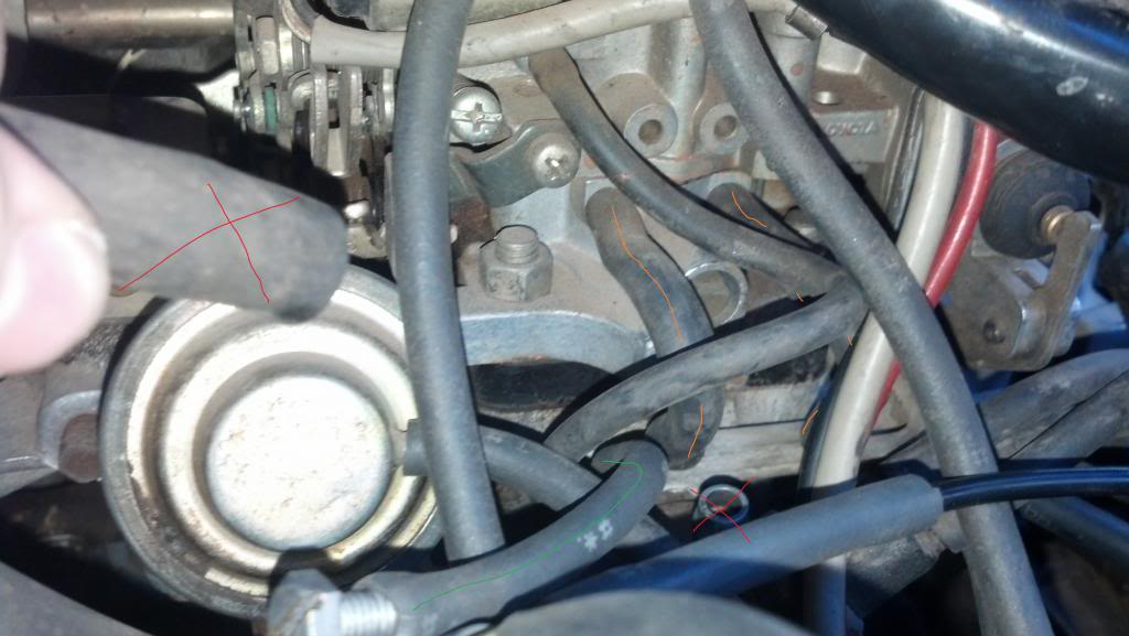

I got more lines figured out! It idles great again but has a slight hesitation off idle whenaccelerating
Only have one questionable area left I think, this photo is the area and the two short lines each about 2.5 inches long(orange) and the remaining port that is plugged with a short line and screw(green). Don't worry about the fat line undone, I pulled it for the photo.(red x)

Replaced aap and moved lines around according to my 86 FSM, still not crystal clear as my truck seems to resemble both the cali and federal/canada diagrams. Runs good but sounds slightly rich once warmed up and leaving from a stop. Runs great cold though.

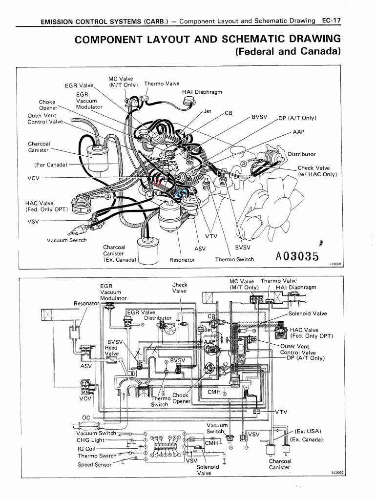

Oh its there and it says cali but my metal hardlines match the fed. I have an extra hardline port near the passenger side of carb in red and near the 90* bend at the front nearest the battery I have the small 180 in blue.
