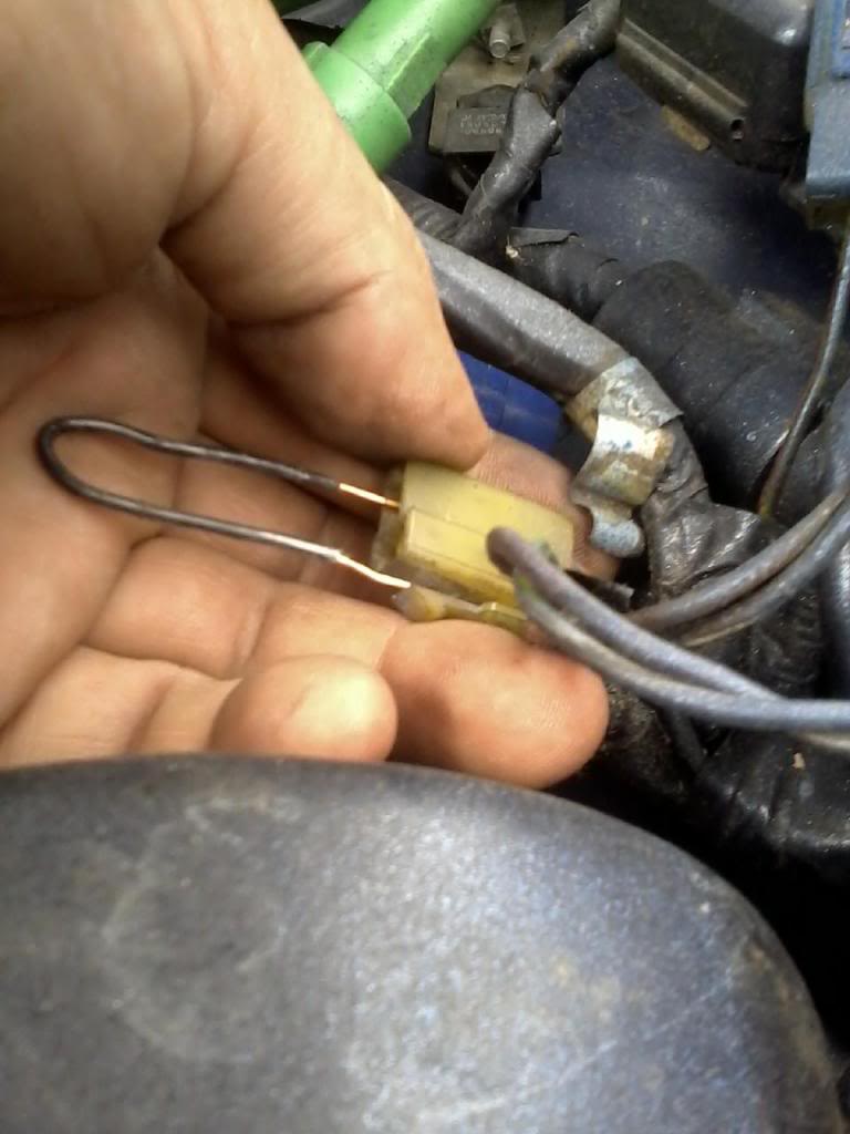

Do the fuel pump jumper and see what you get.
Here is how you do a Fuel Pump Bypass on the 85/86.
Jumper wire the Yellow Plug on Drivers side. ( Jumper wire should be in both contacts for testing, I just didnt have it in for picture purposes and mostly a referece for me at a later time.)
If it doesnt engage the fuel pump you most likely have a broken wire somewhere. You should be able to hear the pump run with the key on and the motor not running.
Since you have already changed out the Circuit Opening Relay behind the passenger speaker I doubt that is the issue. I remove all of those crimps that you have posted in the pictures above. Remove the crimp, solder and shrink wrap them. I have seen a crimp pass a resistance check but still not operate. Like was explained to me, if it is a 50 strand wire, all broke but one, it will pass a resistance check but not able to send enough current to operate the equipment.
