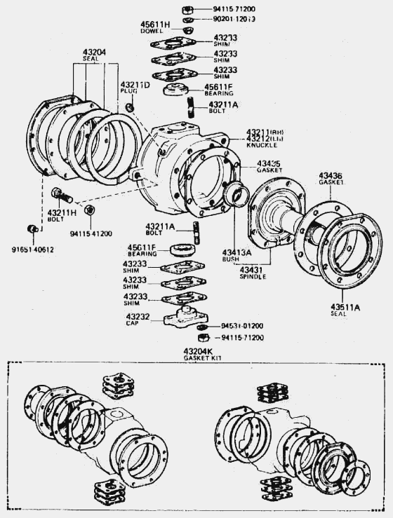

Hi all,
Yesterday while rebuilding my front axle I forgot to install the backing plate eliminator which resulted in the dust seal being bent. Something seemed off when it twisted, then I noticed the plate sitting next to me
Anyway, I had the kit so I finished off one side of the axle. Now I need a replacement for the other side. I don't want to buy a full kit and I'm unable to find the generic PN for auto zone, O'Reilly, Napa, etc. Any pointers? All I find at auto stores are the actual grease seals, axle seals, etc.
Toyota PN: 9031393011
Or seal 43511a in the diagram

The SKF master seal interchange pdf, Here::
https://grizzlyseals.com/wp-content/...ence-Guide.pdf
Says that Toyota 90313-93011 is SKF # 37442
Here's one on EBAY : https://www.ebay.com/itm/Steering-Kn...4AAOSw2oheF76q
You might be able to do better on price somewhere else. IDK

Thanks! I was able to find a kit for 35 on Napa. I also found on davezoffroad but with shipping costs it didn't add up.
I ended up reusing the old one which was in decent shape. Not ideal but I didn't want to wait a week to get it done.
Posting parts I found below in case someone else needs them.
https://www.napaonline.com/en/p/ATM2...ndex=Universal
https://www.davezoffroadperformance....dust-seal.html
