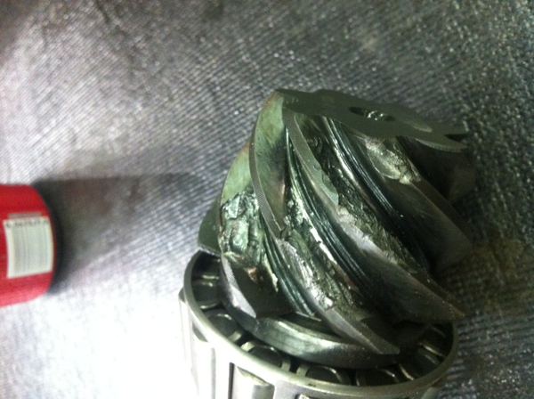

as a side note i had 5.29's in it, the truck chewd them up and spat them out.. costed me 1200 bucks for the set and they were garbage. the 4.56's are good, both on and off road.
You either bought cheap gears or they were set up wrong. And no 4.56 is the wrong gear for 35's and 22re.
Rebuild the motor and get 4.88's or 5.29's and it will be sweet.

well i bought yukon gears, set up professionally at national 4wd. followed break in procedure to the letter and it tore up the pinion in the rear...... i got new gears for 400 bucks
so i went with that instead. thinking maby dual t-cases or re gear trans?
i am trying to do this on a budget.
