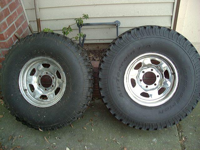

Old Nov 9, 2013 | 12:14 PM
85toy4runner's Avatar
Joined: Feb 2012
Posts: 223
you might want to wait and see if you can pick up a set of these , they are factory toyota solid axle wheels

Old Nov 9, 2013 | 12:19 PM
mikeyd6789's Avatar
Joined: Nov 2013
Posts: 244
From: Virginia
I think your right!...thanks again for all the help!
