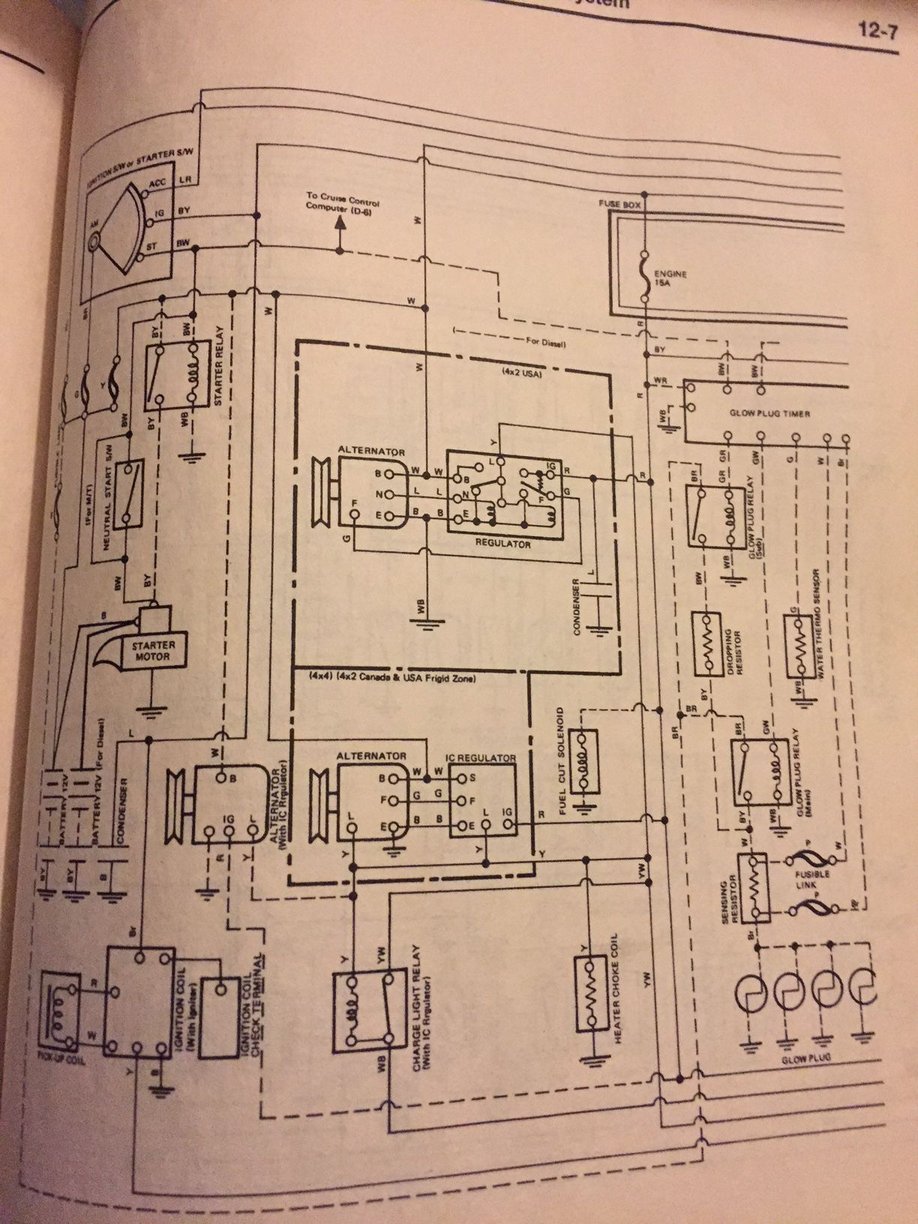

Hey guys, I'm new here and figured I would make a contribution. Before I could find my Haynes manual i searched all over the web and absolutely could not find a wiring diagram for my truck. Since I've found my manual I decided to upload some photos of the diagrams to help out others.
Manual labels these as "early model" and the manual covers 79-95 models, so I'm not sure how many years this particular diagram covers.
Diagram 1 of 4
Diagram 2 of 4
Diagram 3 of 4
Diagram 4 of 4

Applies to/covers nothing. Given the source. As in the accuracy is HIGHLY suspect.
Thanks anyway. It's the thought that counts. Not really. But whatever.
Old Apr 24, 2016 | 12:36 AM
Trying to use those will give you a basic understanding of the circuits if you have no idea.
Wire colors will sometimes change between years.
You want the Toyota Electrical Wiring Diagrams for the year vehicle your working on.
Takes quite a lot of the frustration out.
The guy is trying to help out others - more so than your condescending remarks do. If you can't play nice then please step out of the sandbox.
RadfordBeats - I would caution you that you could use this as a general guide for circuitry, but I would not rely on it 100%. A wiring diagram from a manual that covers 79-95 models cannot be considered very accurate because Toyota varied several aspects of these trucks in regards to electronics, emissions and engines. Wire colors alone can vary from model year to model year. Send me a PM if you would like a more accurate manual with wiring diagram - I have complete Toyota Factory Service Manuals for 1983 and 1985 Pickups that I can send to you.
