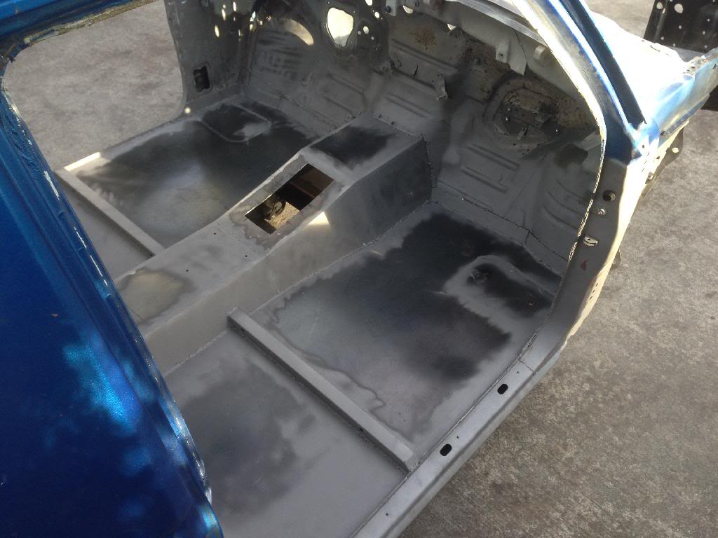

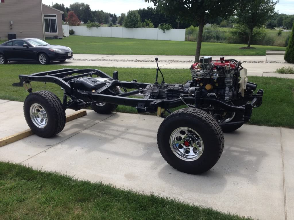

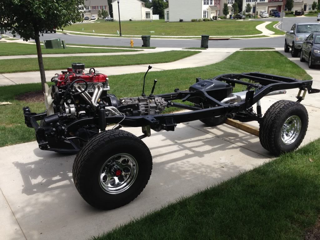

$8K will get a lot done on these trucks. To put it in to perspective, I have spent over $12K on a full restoration on my truck and I have done the following so far:
*Completely rebuilt engine (Head job, bored 030 over, polished crank, new cam, rebuilt rockers, new timing kit, new belts, new timing cover, new water pump, new oil pump, desmog kit, new distributor, new fuel pump, new motor mounts, new fly wheel, new alternator, new starter, etc... It is a COMPLETE rebuild)
*New clutch
*Completely stripped and painted frame
*Old Man Emu springs
*Bilstein 5100 shocks
*New shackles
*Rebuilt steering knuckles
*Heavy duty steering tie rod
*Rebuilt and painted front/rear axles
*Rebuilt hub locks
*New front brake calipers & disks
*Rear disc brake conversion
*All new fuel and brake lines
*Rebuilt driveshafts
*Stripped and painted fuel tank
*New alloy wheels and 31" tires
*New stainless headers
*New exhaust
*Replaced floorpans in cab
*Deposit on a fiberglass bed
*And a bunch of stuff that I'm sure that I'm missing

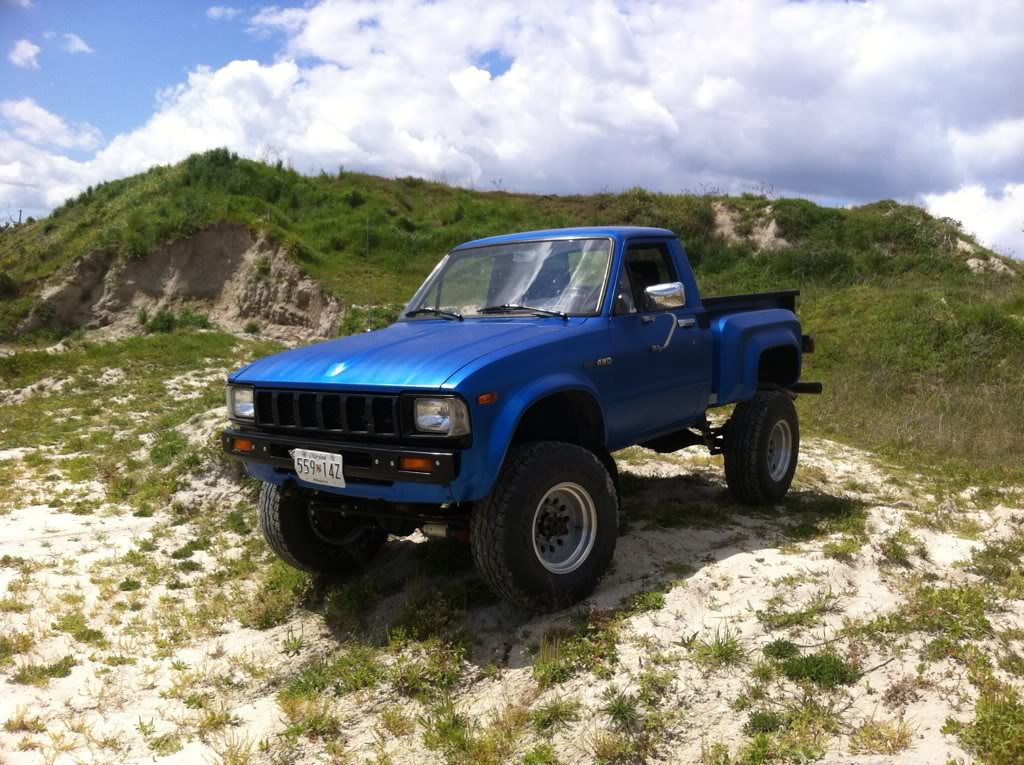

Here are some pictures:

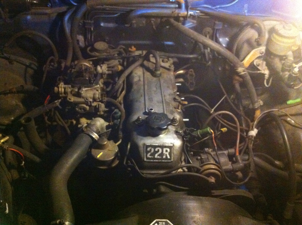

This is what I started with

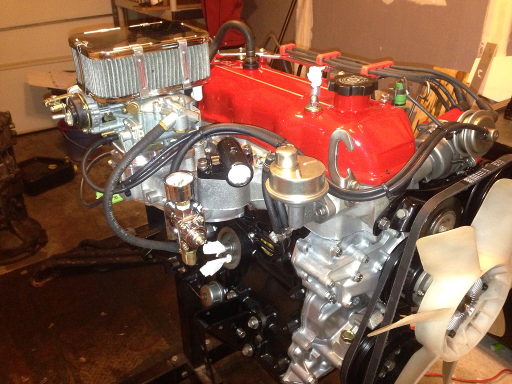

Rebuilt engine

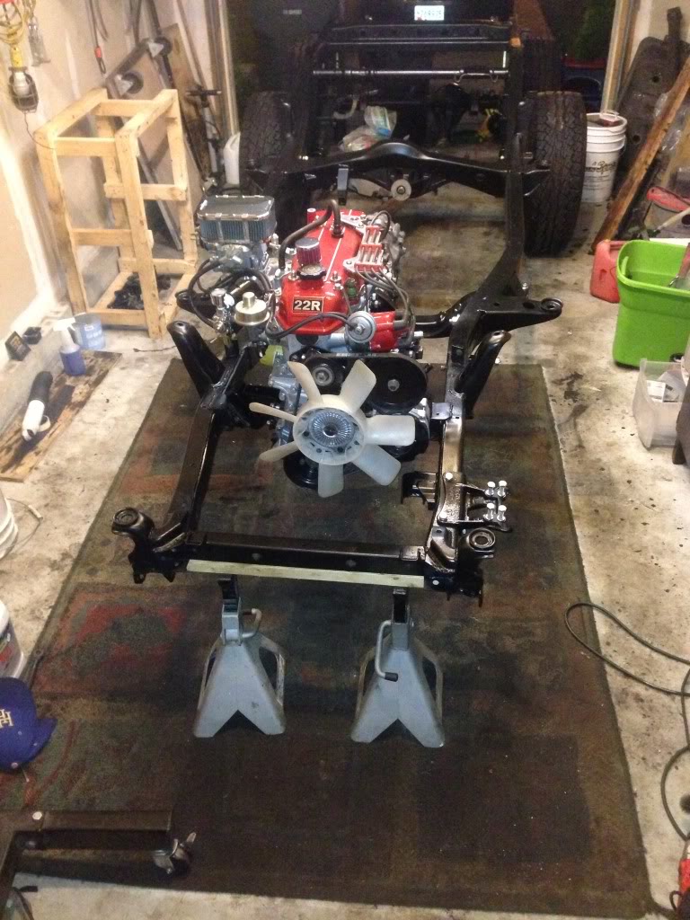

Competed chassis

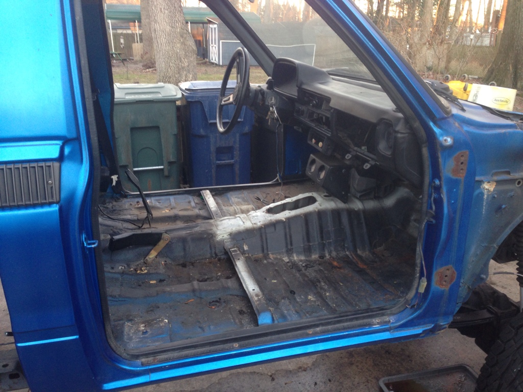

Original cab floors

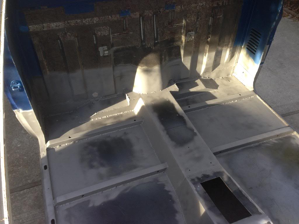

Replaced floorpan
So essentially, you have a healthy budget... now you just need to prioritize your spending. Personally, if the motor currently runs ok then I would start with the suspension first and work your way up. If you don't mind it being out of commission for a while, I would highly recommend popping the cab and bed off to make life easier for you. Plus you can take care of any rust and shoot the frame a lot easier.

As for that engine, if you can turn a wrench, I would recommend rebuilding it yourself. I have rebuilt dozens of Kawasaki and Suzuki motorcycle engines and a few Chevy and Ford engines, and the 22R is by far the easier engine I have ever rebuilt. It can be done for around $1,400 after parts and machine shop bills. Mine was about $2,000 but I went way above and beyond a standard rebuilt. There is no way in hell that I would spend $5K for an LCE engine that I can build myself. At least the 22rePerformance.com engines are somewhat economical.
