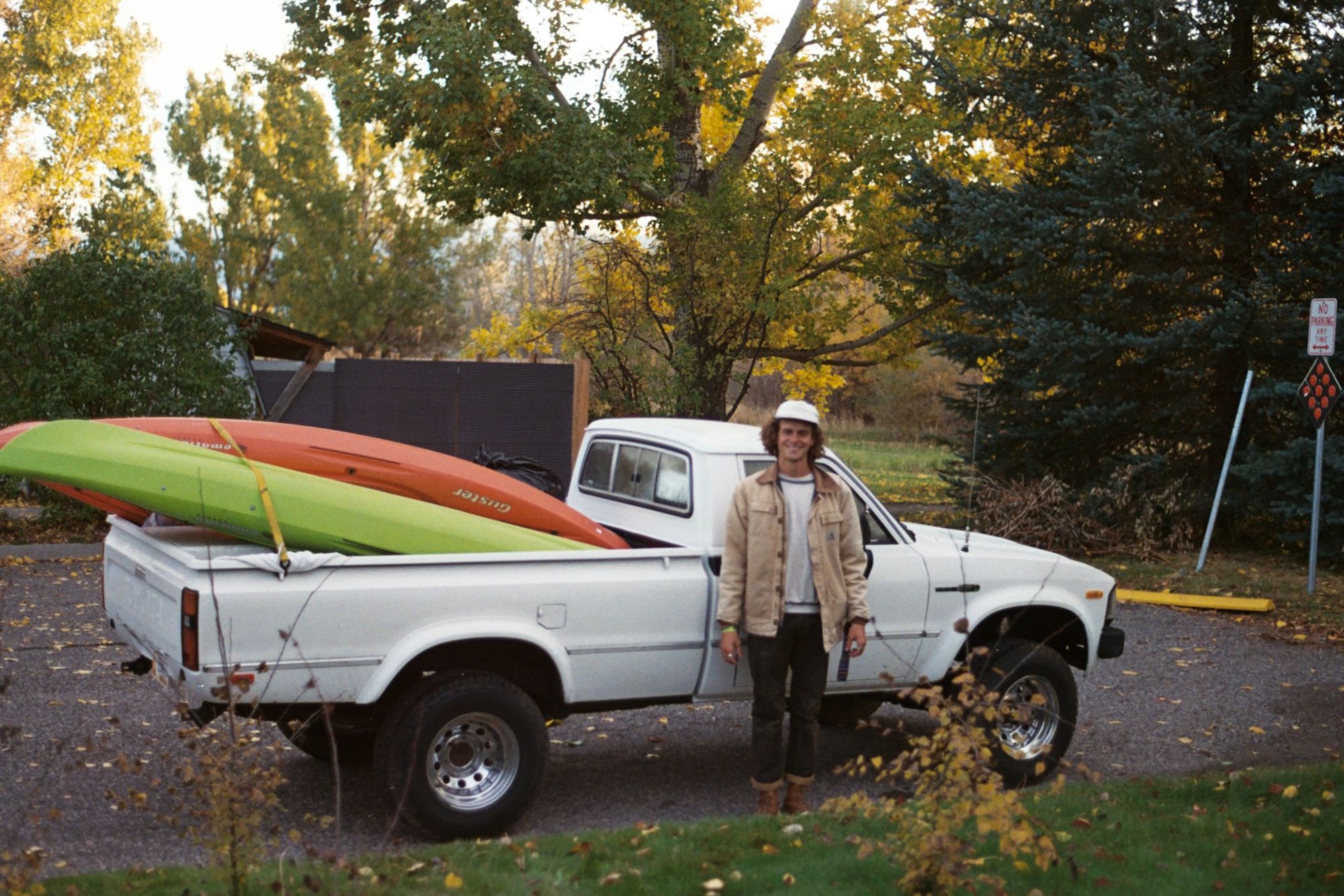

Hey all, new here but been reading for awhile.
Recently got a new to me 83 Dlx 5spd. Stoked as I’ve wanted one for ages, sold my trusty 99 Tacoma with 315k on it to go back in time with this thing. Love this truck, loads of plans for it but first some long overdue care and fixing of things.
