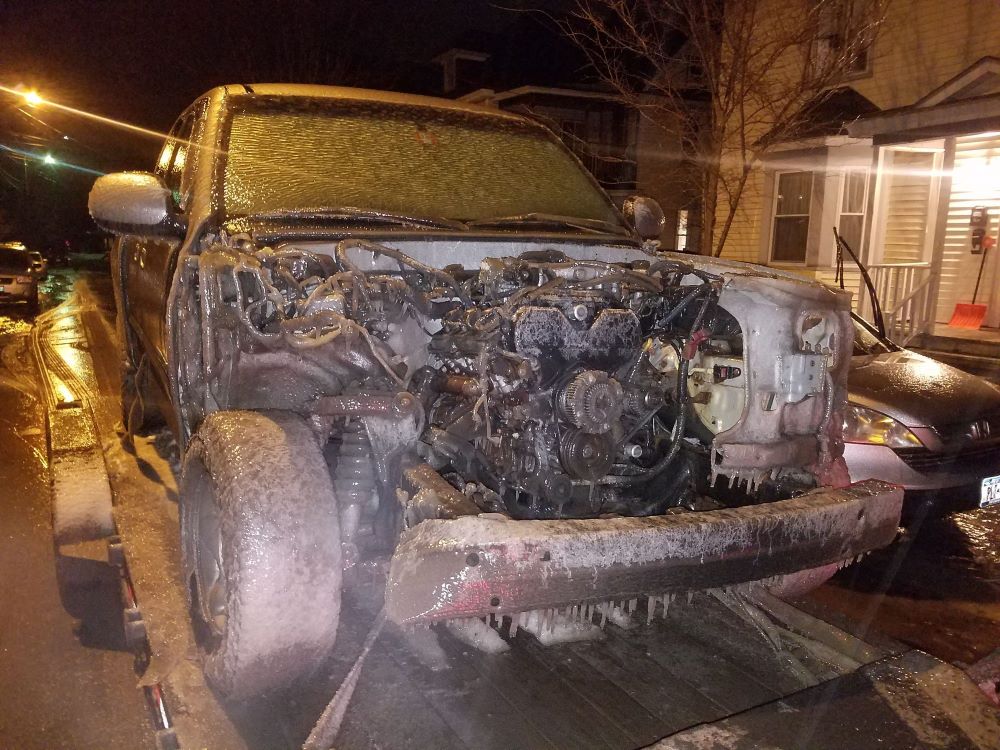

“I found a 2004 3.4 5-spd Tundra 1.5 hours away from me with 90k miles. It had been hit in the front but ran perfectly. I had to pick it up during the largest ice storm in the recent past. I rented a U-Haul and borrowed a trailer. After a few hours of white knuckle driving through the mountains of Vermont, I had it home. The ice build up pictured is from my ride back and I am not sure I would do it again, given the opportunity. I was able to get the rig for $800 + $120 for the rental.”

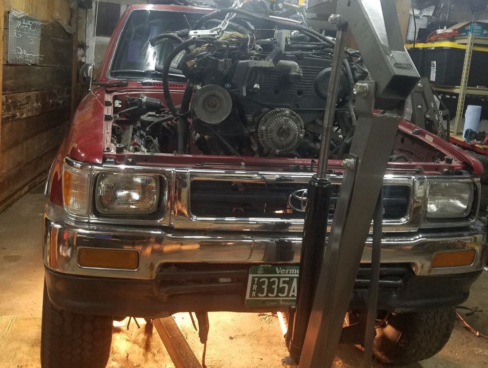

After that harrowing trip, the OP was able to get both Toyota trucks in his garage and start the process.

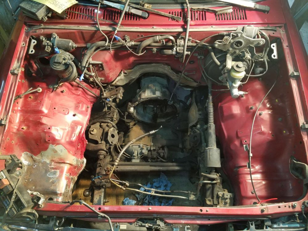

“I was unsure about what wiring I would need, so I took everything. In the interest of saving time. I cut the accessory lines with my angle grinder and the front diff shaft since it was rusted. I then took a sledge hammer to the front so I could pull the trans + engine in one solid shot. The wiring was a pain, but the rest went smoothly.”
