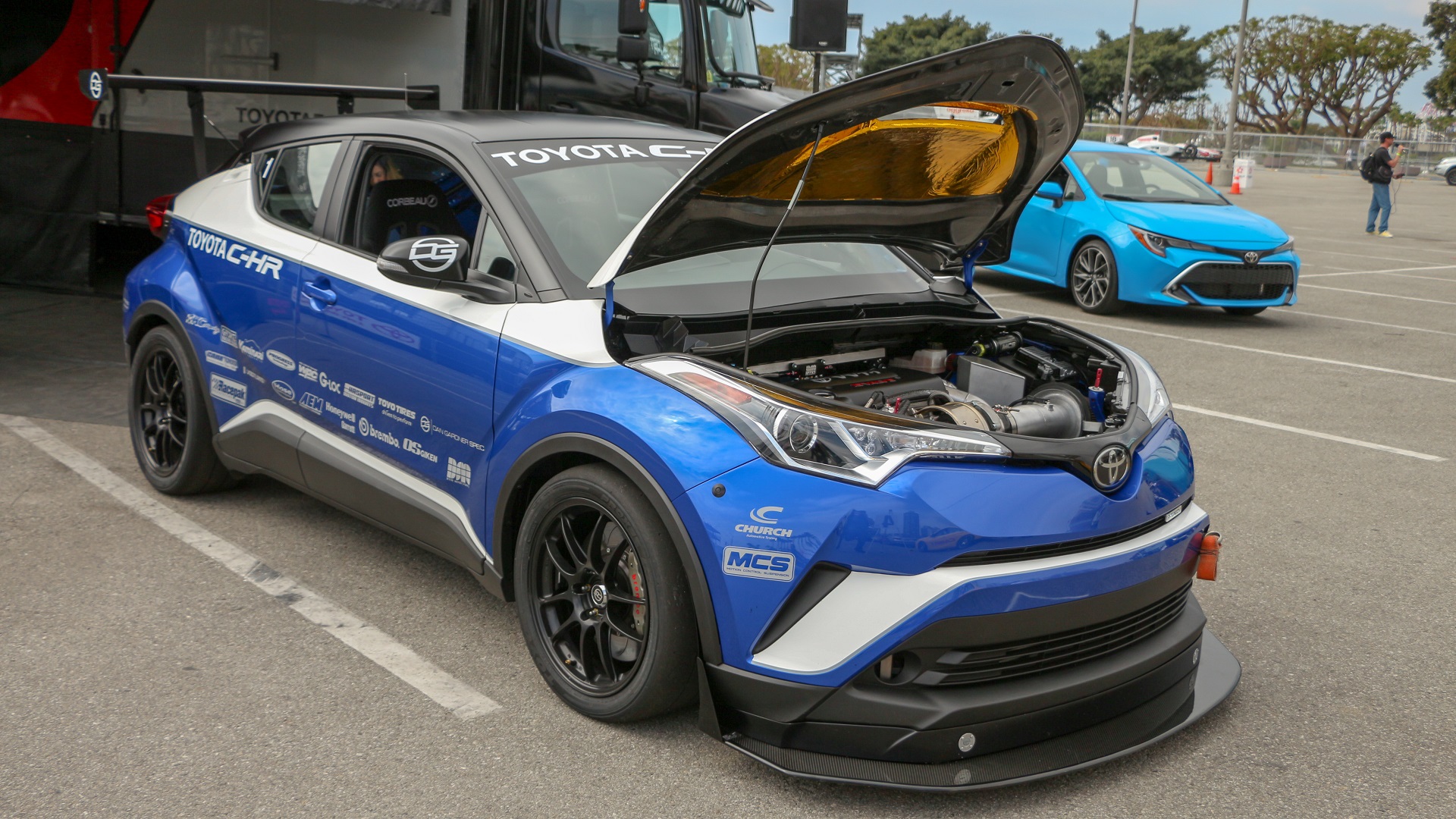

The standard C-HR is an entry-level compact SUV with funky, modern styling and an emphasis on being easy to park in big cities. Throwing 600 horsepower at one has taken that cool styling and put a decidedly aggressive spin to it.

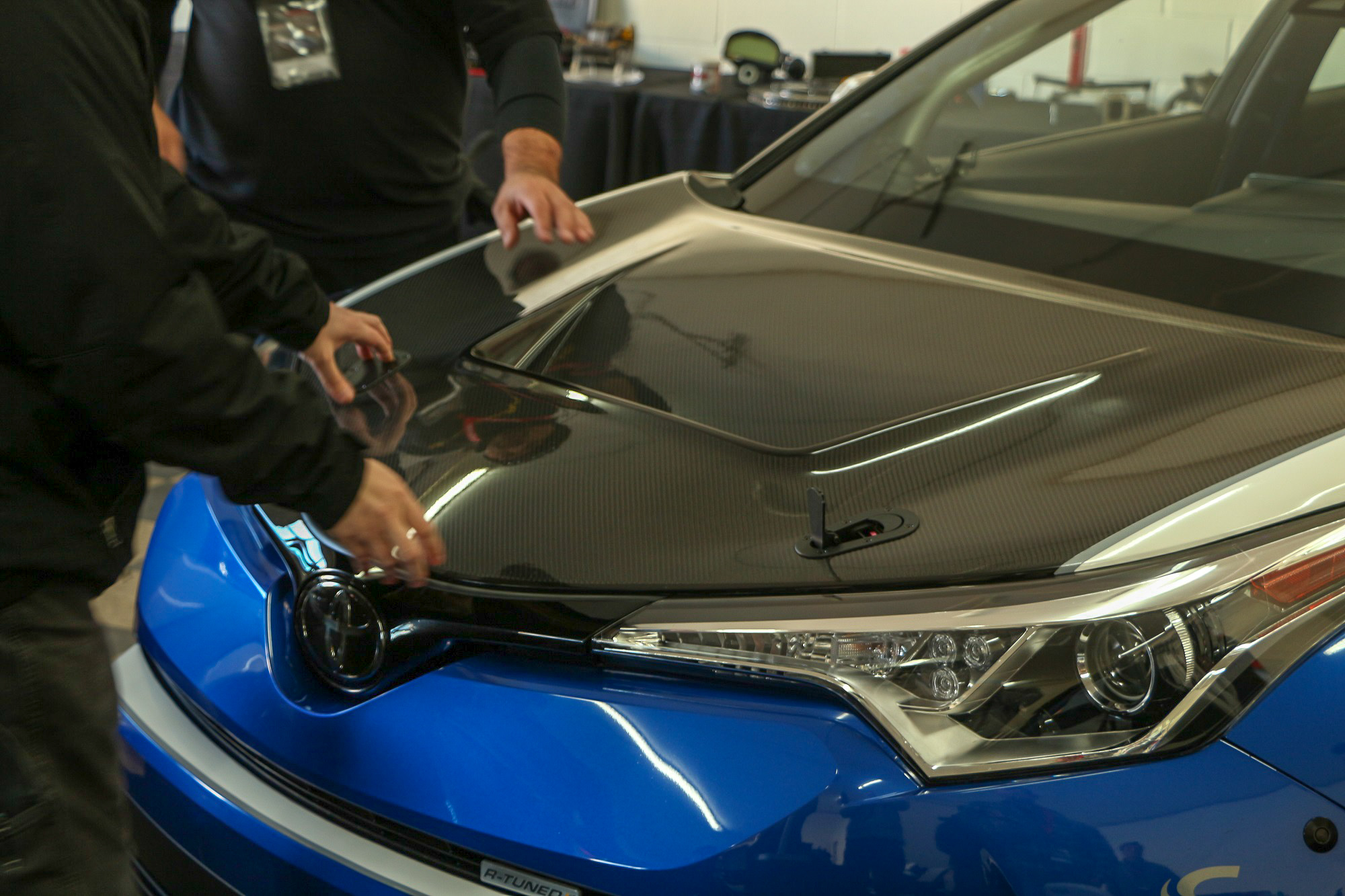

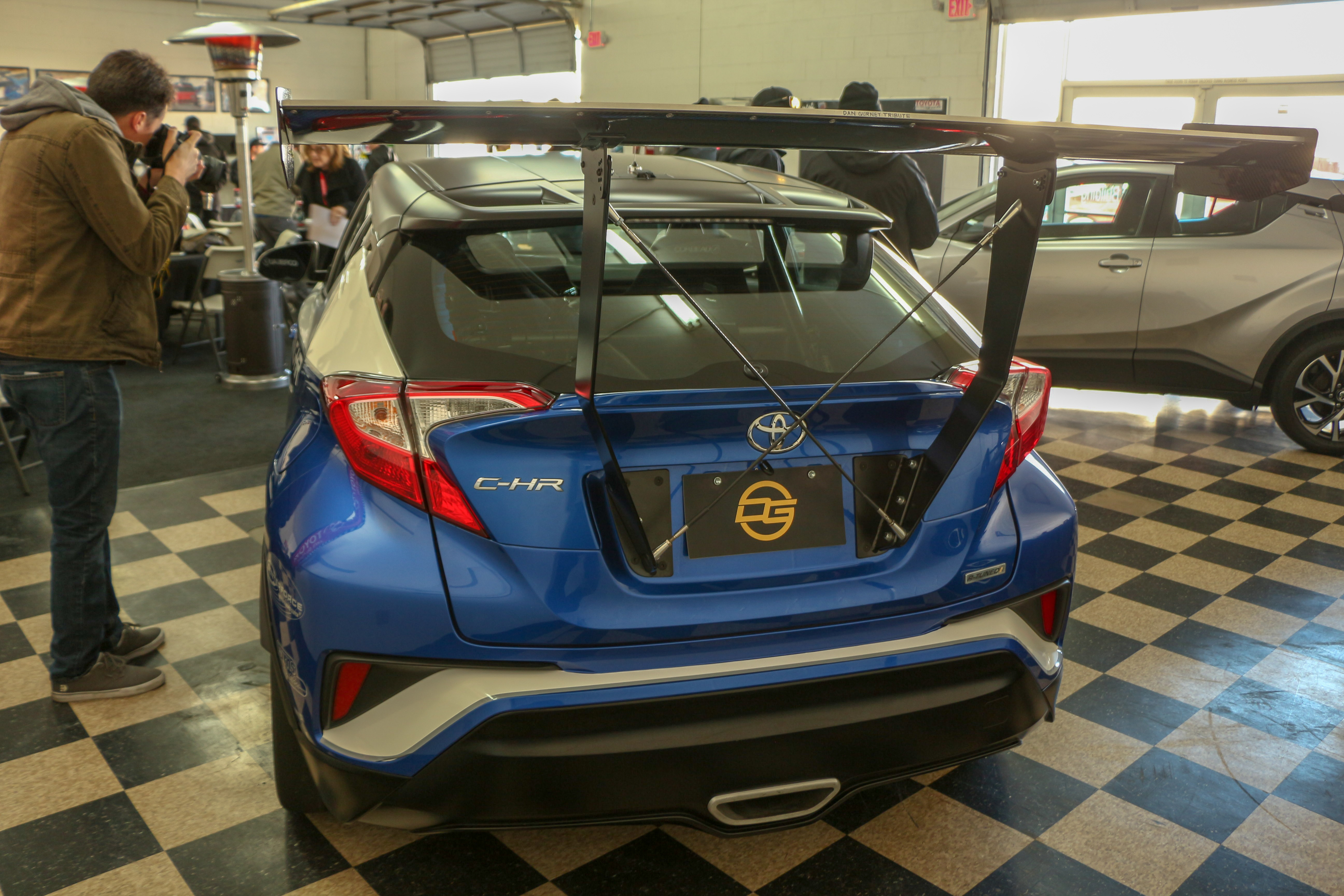

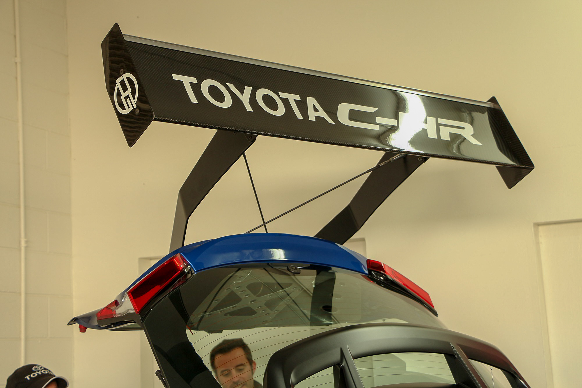

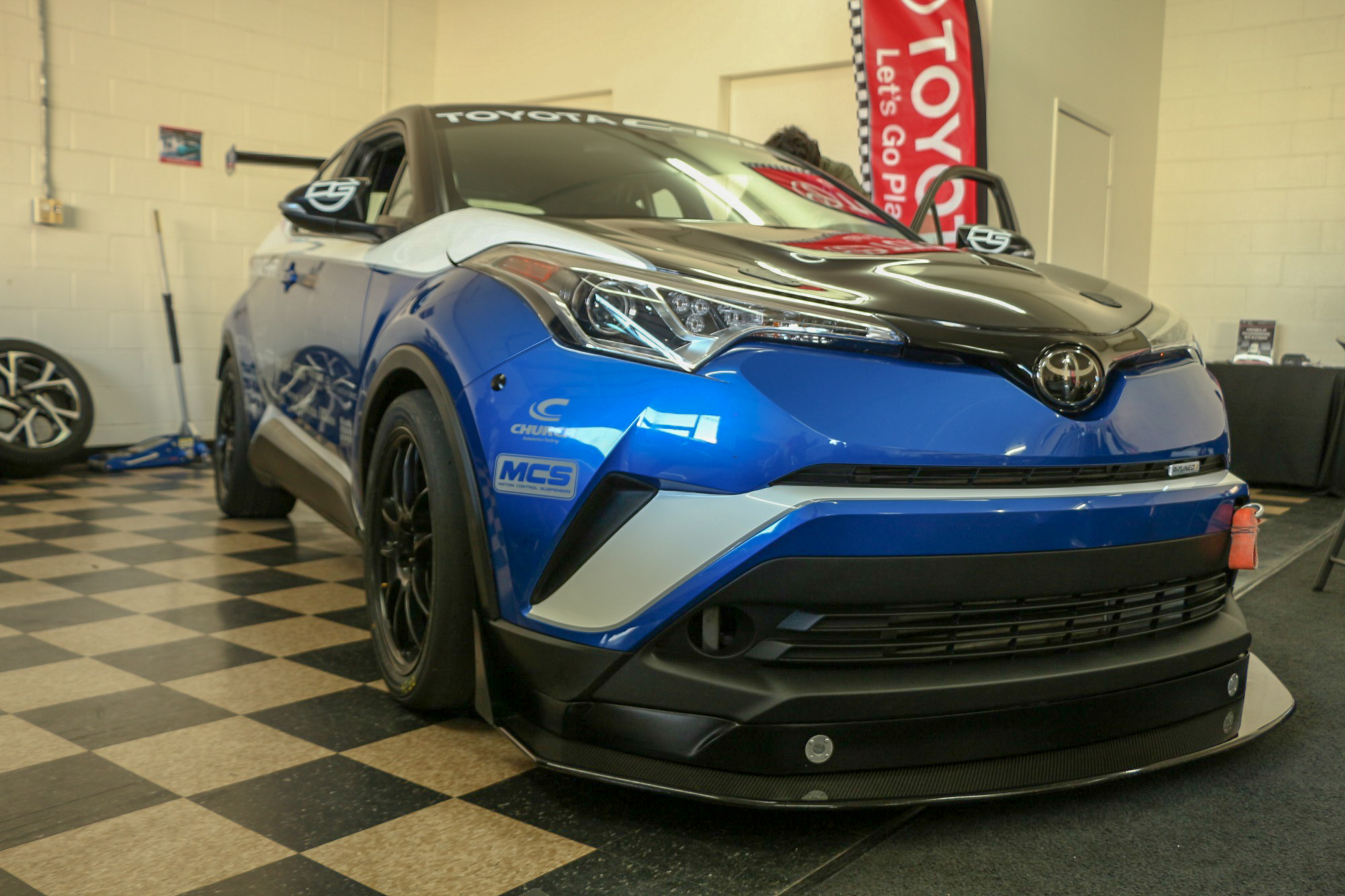

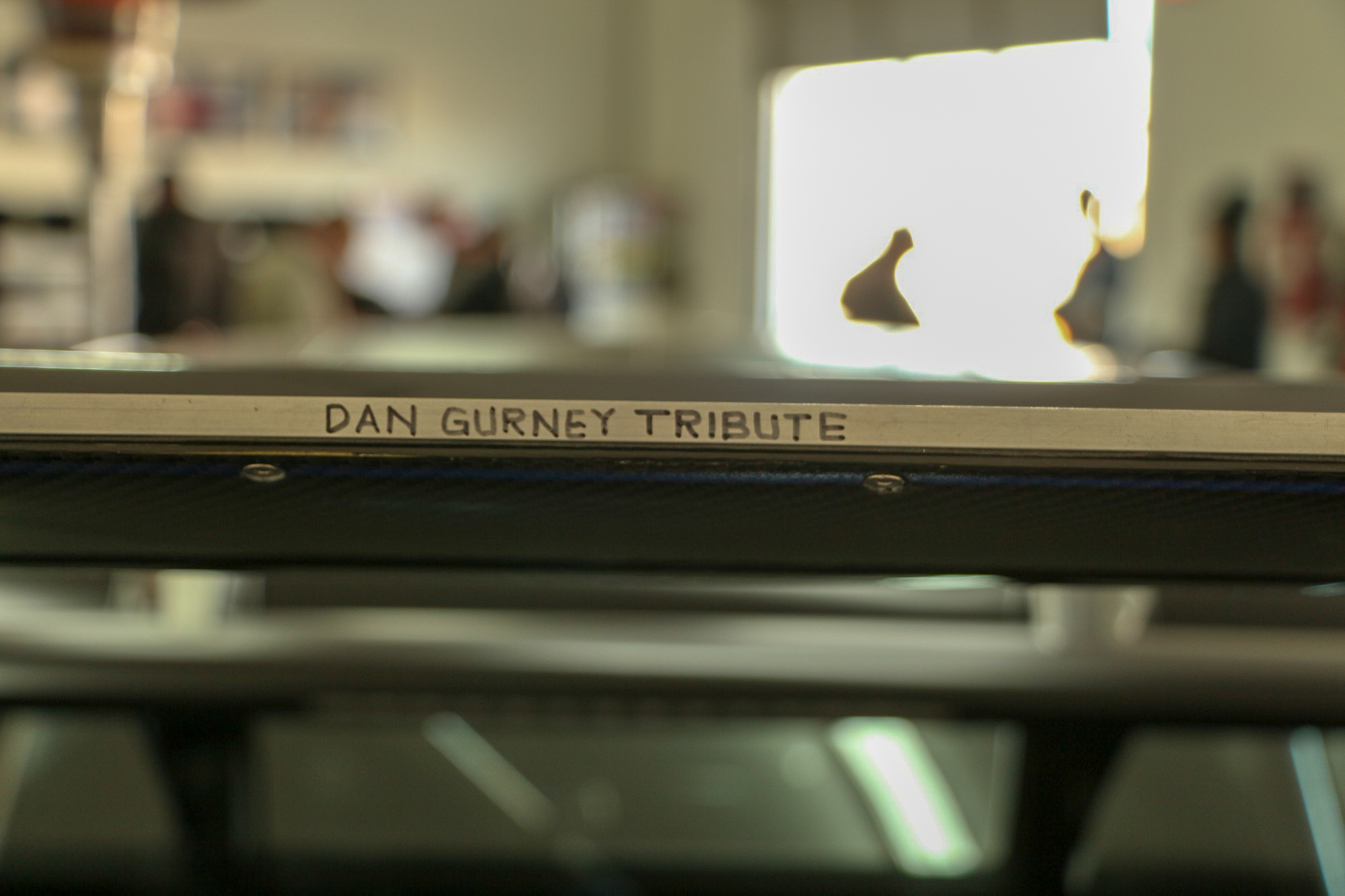

Visually, the C-HR R-Tuned screams “Look at me, I’m a race car!” but, in reality, it shares many similarities to the regular car. Dan Gardner, the DG of DG-spec, emphasized that this started off life as a regular production car and actually retains many original parts. It sits several inches lower than a standard C-HR, thanks to adjustable MCS coil-over suspension. Up front there is an air dam, mated to a large, carbon fiber front splitter. A carbon fiber hood, produced by Kaminari, is also present. Out back, a multi-element rear wing is utilized. It is trunk-mounted with cross bracing to minimize flex on those very high risers. Remember, if it’s not at the roof line, or above, rear wings aren’t nearly as effective. Mated to the carbon fiber wing is a Gurney flap, with “Dan Gurney Tribute” etched onto it.
