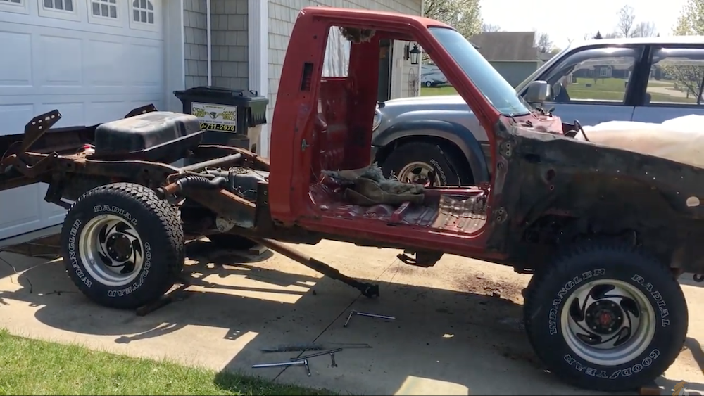

First off, Brian informs us that the cab of this rustbucket is unbolted and ready for removal. With the exhaust broken off, engine mounts, steering column, and all lines removed, this experiment is ready to go.

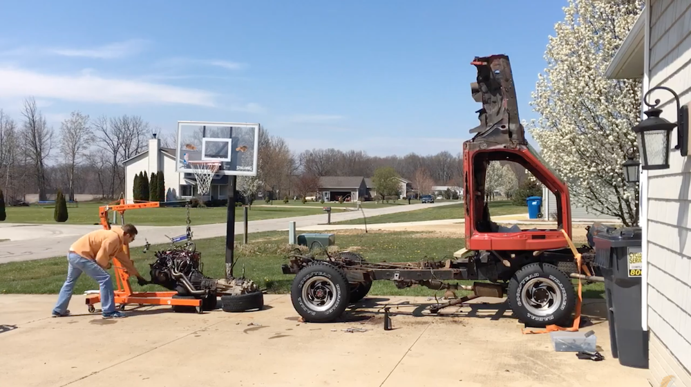

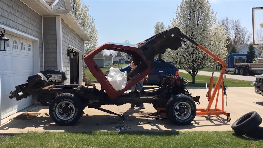

Next, Brian takes his engine hoist and uses it to lift the front end of the cab. A neighbor joins in on the fun and helps Brian to set the cab upright on the rear of the truck frame. Brian supports the cab with a 2×4 and ratchet straps to ensure no disasters occur.
Upright cab on Toyota 4x4
“Look at that!” exclaims Brian “Easy access granted. I can yank this whole thing right out now.”

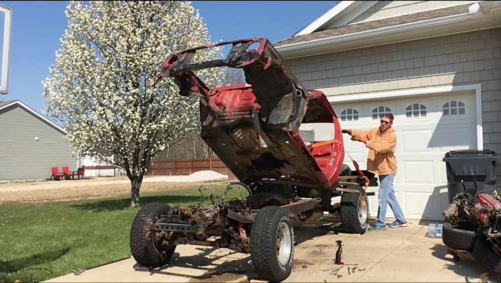

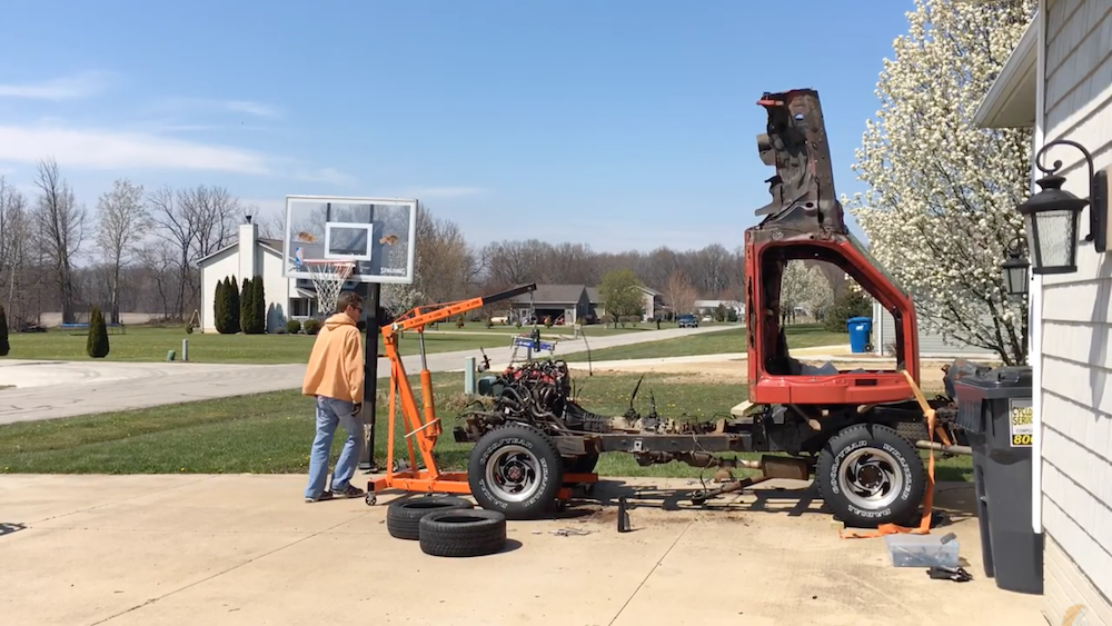

After a “Don’t try this at home,” warning, Brian preps for the removal. Using a load leveler, Brian works the hoist to pull the engine, trans, and transfer case all at once. Brian tops off the spectacle by not so gracefully shoving the cab over to let it fall back into place. After a quick degreasing and pressure washer bath, this unit is ready for install.
