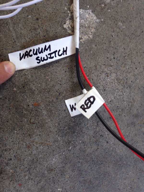

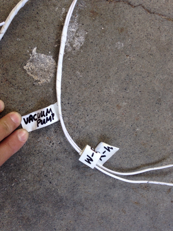

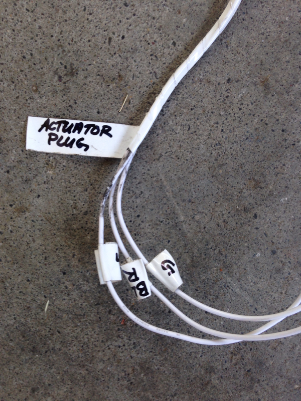

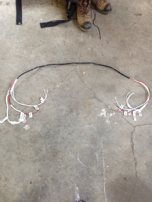

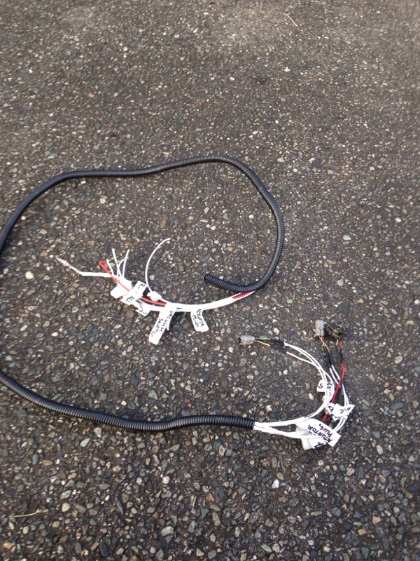

Here are a couple of pictures of my extension harness. I had to put my cruise module on the passenger side

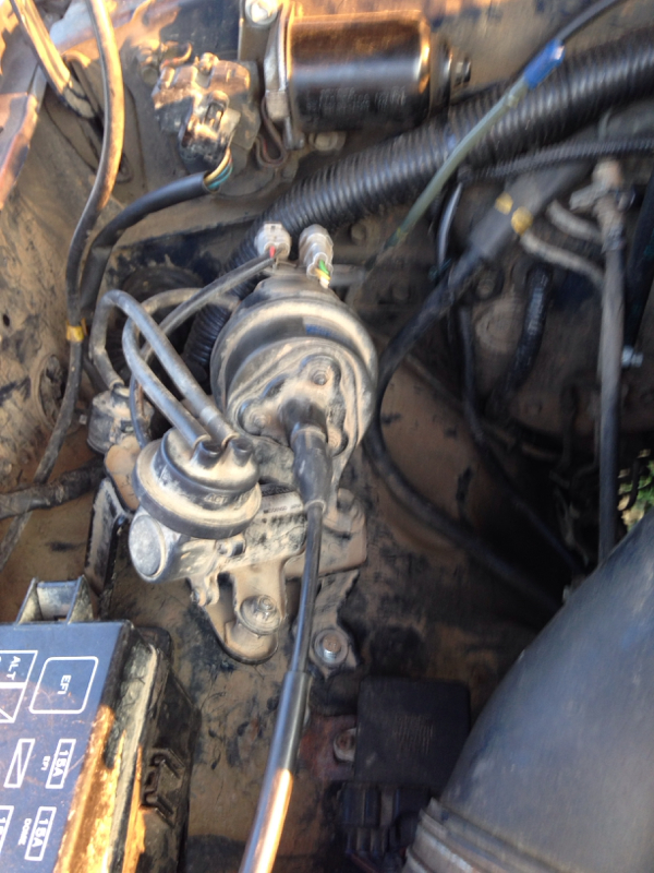

Cruise control works great now! I did the following:
- Mounted the bracket on the passenger side in such a way that the cable for the actuator was running facing the throttle body and not hitting the hood.
- Made about a 5 1/2 foot extension harness out of white 18ga automotive wire. I built the harness by cutting (7) wires, (2) for the vacuum pump plug, (2) for the vacuum switch plug and (3) for the cruise actuator plug. Cross referenced each wire color at each plug and labeled each of my extension wire's accordingly using white face tape and a sharpie and leaving myself about 8" to solder my connections. I bundled each plug extension wire's separately with a label of what it was. Once I completed that I tapped all bundles together. I cut my plugs that were on the driver side leaving about 2 1/2 inches of wire so I could solder them. I soldered the plugs on and shrink wrapped each connection. I took ribbed wire loom and ran the harness in the loom and tapped it on each end then supported it along the firewall. Next I soldered the harness to the factory harness cross referencing the wire's I labeled and shrink wrapped each joint and the whole connection per plug. I ran the rest of my wire loom over the joints and tapped it up.
- I mounted everything to the bracket on the passenger side and began grinding using a dremel tool, the ball end of the cable down to a "barrel" type end that would fit on the throttle body. You have to be very careful and do a little bit of a time and mark it with a sharpie where you want to grind.
- Next, utilizing the vacuum line that you take from the 3.0L, I ran that to a vacuum line that was coming right out the back of my upper intake manifold.
Your done, happy cruising!
