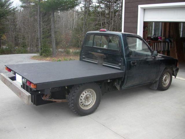

Thanks, it's a lot of fun. I keep meaning to build up some boxes or something to make it more versatile but never get around to it.
The electric motor has a lot of torque and I can haul all kinds of stuff around. We cut firewood in the winter but that's all over for this year (way early) as the frost is going out of the ground already. I schlep my gear into the woods with this thing.
The electric motor has a lot of torque and I can haul all kinds of stuff around. We cut firewood in the winter but that's all over for this year (way early) as the frost is going out of the ground already. I schlep my gear into the woods with this thing.Contributing Member
holy crap, what is that like a 75 gallon fuel tank under there!

Er, it's a battery box. There's 4 batteries in front of the rear axle on each side of the driveshaft and 8 behind the axle. (There's also 4 under the hood.) Total weight = 1320#. (!) If doing it today I'd probably go with lithium: same energy would weigh 900# less!!! BTW, there's the equivalent amount of energy as 1/3 gallon of gas in those batteries. EV's are about 5X more efficient than ICE's in how they use their energy.
