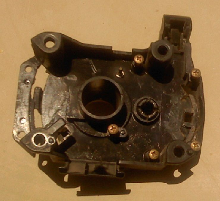

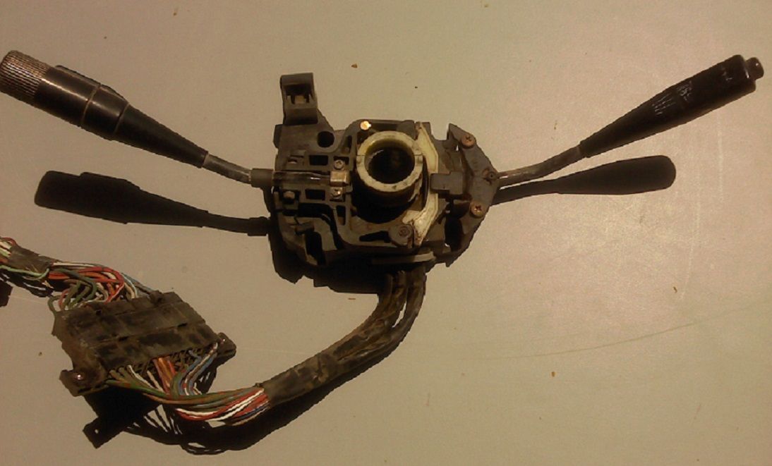

So, first a look at what I am starting with. Here is the whole switch, as you would see it if the steering wheel etc were removed. The hazard switch is on the upper left and the brass pin for the horn is just below and to the right.
https://cimg6.ibsrv.net/gimg/www.yot...d6caf637c1.jpg
Below is a closer look at the mechanism. The white plastic ring around where the steering column goes through is the turn sig cancelling cam – it is able to move up / down along the steering shaft. There are 2 alignment pins protruding out (hard to see in this pic) that go into corresponding holes on the back of the steering wheel. The white plastic piece to the right of the column hole is part of the turn sig actuating arm and moves to the neutral position when the cancelling cam pushes the white plastic piece.
Also note the Phillips head screws, an important item because the various parts attached (headlight turn sig stalk and wires / wiper washer stalk and wires) can be removed from the base of the unit and replaced separately if needed.

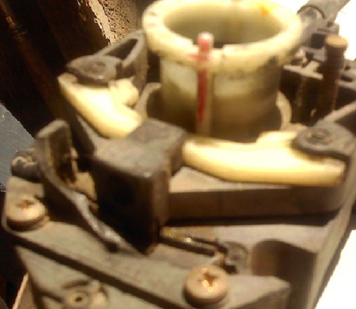

Below is a closer shot and from the passenger side of the cancelling cam, with the lobe of the cam marked in red (there are 2 BTW). The round cam part, which turns with the steering wheel, attached via the pins, rubs against the white plastic piece to return the turn sig to the neutral position.
Also note that we have our first issue with this part. Between the 2 Phillips screw heads at the bottom of the picture there is a piece of the base unit broken off. I don’t know if this has a function but I believe it might because there is residual grease at the base of it suggesting there is friction happening there. However, I believe this is where the modular-ness (it’s a word now) can come into play and help. If the base of the combo switch currently on my truck is good I can still use that should I need to change out any of the modules. We shall see later once the rest of this is taken apart and tested.

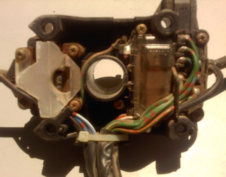

OK, last bit for now. For those of you who love looking at backsides, this is the backside of the combo switch. On the upper right is the hazard switch and to the left of the column hole is the horn wire (light brown). On the bottom is a factory zip tie that holds the wiring from the modules together and to the base of the unit. You can also see 4 holes, 1 at each corner, where the screws that mount the combo switch go through to attach it to the steering column assembly.
Again note the Phillips head screws that hold the modules to the base. The ones in this pic hold the wiring (in what appear to be little covers) to the base. There will be more on that when I take the modules apart.

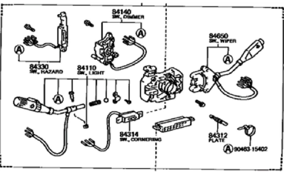

UPDATE to my first post. As I started to separate the modules I found the part number on the combo switch I’m working on – it is on the connector. The original part number I posted – 84310-35190 – is correct for some years (1984 – 1987) but not others. The part number on the part I’m working on – 84310-35180 – is correct for the same years (1984 – 1987) plus up to 1989. That info came via the links below.
The part number tag, on the connector, on my truck’s switch is gone. It doesn’t matter at this point as I’m going to keep working on what I’ve got.
I also found a diagram of the combo switch which I have posted below.
84310-35180
https://www.toyotapartsdeal.com/oem/toyota~switch~assy~turn~signal~84310-35180.html
84310-35190
https://www.toyotapartsdeal.com/oem/toyota~switch~assy~turn~signal~84310-35190.html
https://cimg3.ibsrv.net/gimg/www.yot...d70153596b.png

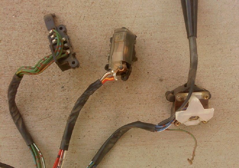

And I’m back for PART 2 of this project – disassembly of the Combo Switch. Most of it is fairly easy as the modules are held on with Phillips head screws that attach to the base of the switch – they come off easily.
https://cimg3.ibsrv.net/gimg/www.yot...8247852c63.jpg
The difficult part may be taking the base apart into its individual parts. The turn signal (t/s) arm is attached to a pivot which snaps on through a hole in the base. It is the smaller round thing to the right of the steering column hole. As part of removing the modules I removed the t/s arm from the plastic pivoting piece. A WARNING here – the t/s arm has a very small detent ball at its end it could easily fall out and roll away – guess how I found out. It is there for a reason so put it in a container for small parts
https://cimg9.ibsrv.net/gimg/www.yot...5cb4b87540.jpg
I cleaned off the residual grease from the pivot so I could work without the tools and parts slipping around and to keep things relatively clean. The pivot just snaps into the base and I lucked out and found a piece of PVC tubing that fit over the ends of the pivot. It contracted the pivot enough so I could then – gently – pry the pivot piece away from the base without damage. But it takes more than that to separate the pivot piece from the base. There is a lip / track that holds and guides the t/s stalk end of the pivot piece and I do not want to break it. So at this point I will not separate them.
Also, you may recall, in the first part of this project I found there is a piece of the base broken off. I took a quick look at the combo switch in my truck. It looks like the only function of that piece is as a stop. As a stop it is also redundant because on the other side of the pivoting piece (the lip I mentioned above) there is another piece that also acts as a stop. So the base I’m working with here seems to be functional.
https://cimg9.ibsrv.net/gimg/www.yot...bfe78c3c90.jpg
https://cimg2.ibsrv.net/gimg/www.yot...5bff2f65ac.jpg
What you are seeing are the modules separated from the base. From the right are the; wiper / washer arm with a white cover over the contacts module with the horn wire close by, then the t/s contacts module with a clear cover over the contacts, then the hazard light contacts module, then the t/s arm on the left.
The next step will be to open the covers over where the wires are soldered to the contacts and determine their condition.

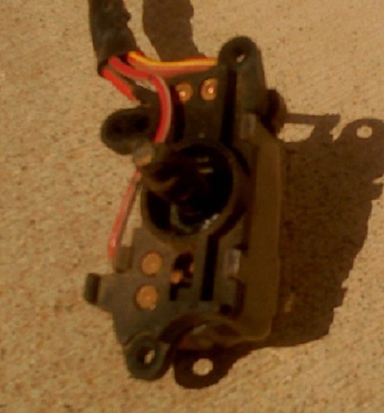

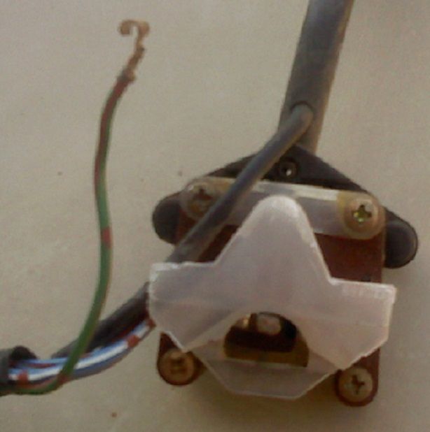

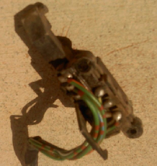

L5wolvesf Jun 12, 2018 11:06 AM
I took some additional close up pics before I open the modules.
https://cimg8.ibsrv.net/gimg/www.yot...7d6ac7c7fe.jpg
Turn sig module. Note that there is a spring loaded pin which looks like it fits into the pivot hole on the combo switch base. I’ll look at what it does once the module is opened up. You can see 2 tabs on the right that hold the clear plastic cover on. What you don’t see in the pic is that on the other side 1 of the tabs is broken off – 30 year old plastic is going to be brittle.
https://cimg7.ibsrv.net/gimg/www.yot...f0d85585e9.jpg
Wiper / washer module. The white plastic cover comes off to expose the wiring connections. The green / red wire on the left is the horn wire and the round connector goes over the horn pin.
