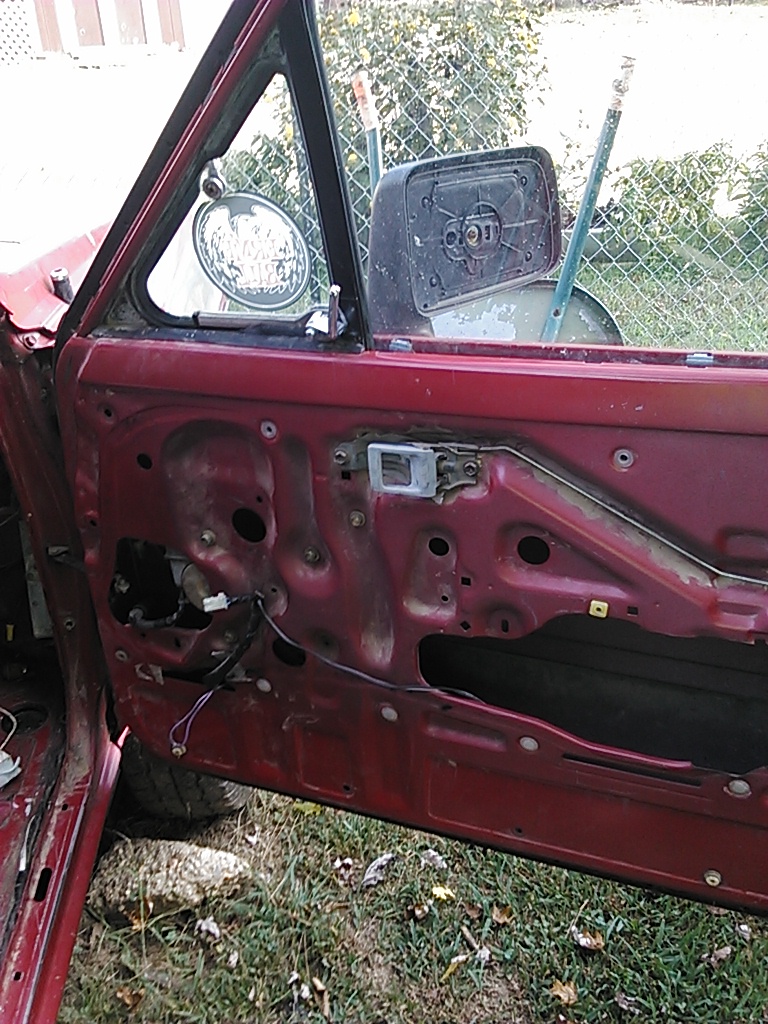

1 Attachment(s)
I could be wrong, but I think the very top of the line SR5 had them. I am betting Chefyota old truck had them as well. The truck I have also has electric locks and mirrors. Other then rear AC ( which I have never seen ) I think this truck here is the most loaded runner I have ever seen.
Attachment 129787

The blue truck that is under the tree has wing windows and they are electric has or well had a sun roof moon roof what ever they are called.
