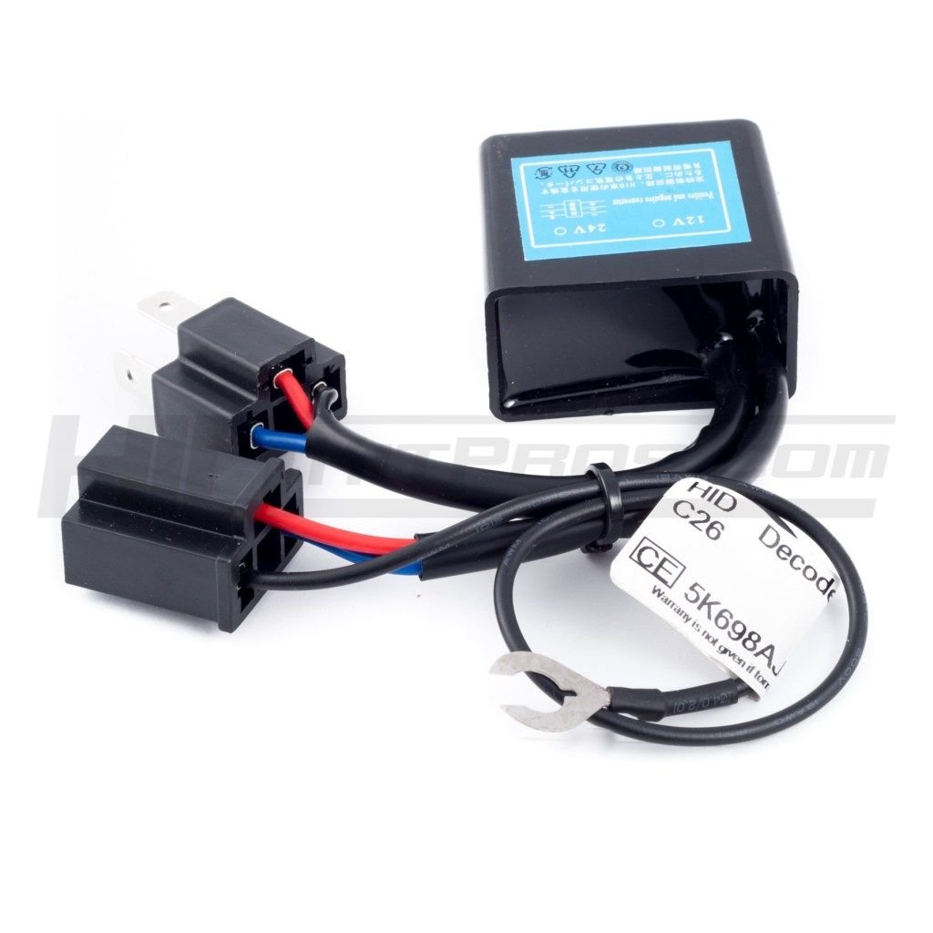

On a separate note, here's a much more elegant solution for those looking to install LED lights, over using a relay harness. Use two of these, one on each headlight and it swaps the polarity from double ground to double positive. The stock wiring and relay are plenty beefy enough to handle the load from LED lights, which are usually 35 watts or less. Around 2.5 amps, which is nothing. Stock bulbs are 35/60, so well within the safety margin. I would also argue that this method is less prone to failure of both lights at once compared to a single relay harness upgrade, since the two systems remain independent.
https://hidkitpros.com/shop/h49003-s...g-play-module/

I can't tell from the web-site description of your Lumawerx device if it removes (most of) the current from the headlight switch, or if it just "reverses" the polarity so you can easily use polarized headlamps.

The product I linked to does indeed only fix the switching and does not provide any benefit for going to higher watt lights or to reduce the load from normal lights. Since LED lights are all far under the max capacity of the wiring system, it's all that is needed for going LED and is likely more reliable, IMO, than relying on a single extra relay harness that is controlled through just one of the existing headlight sockets.
