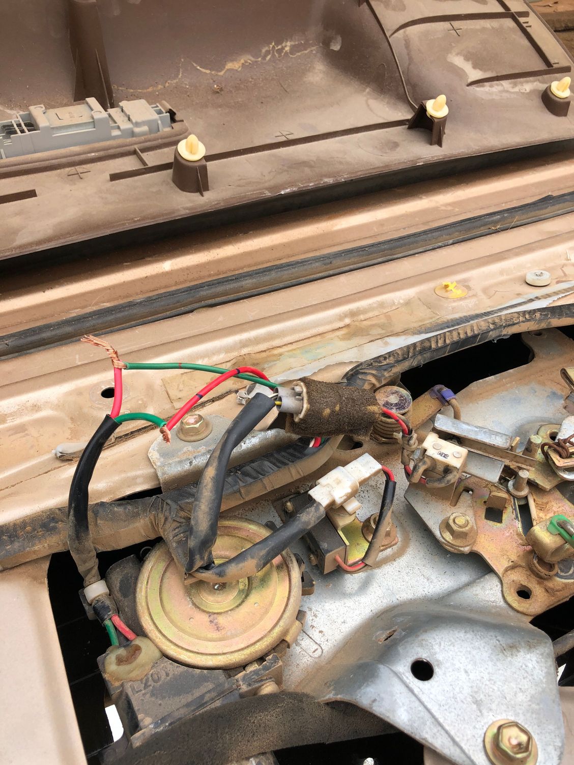

https://cimg0.ibsrv.net/gimg/www.yot...ce589e15c1.jpgThe crossed wires and two other things with harnesses

OK.... Rear Window Control Relay is in there, and it is responding to the switches. However:
1) Something is keeping power from getting to the motor, or
2) Wiring to motor is broken (but it runs one way correct?)
So most likely, it's an interlock problem. Most often, when an interlock senses an unsafe condition, it will send ground to the control module input. Need to find where each inputs into the control module and disconnect them one at time.
Might as well open up that panel to make it easy to inspect / probe / test, etc. Leave it off until we finish troubleshooting.
I know, I hate hidden fasteners, too. Fortunately, they're easier to get rid off on the firs-gens :)

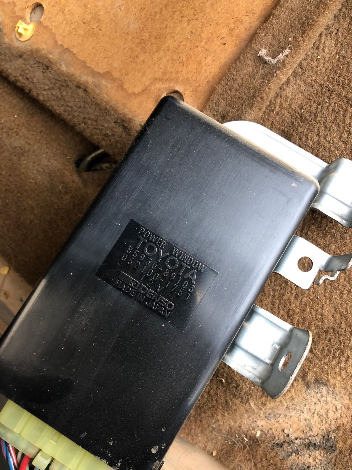

https://cimg7.ibsrv.net/gimg/www.yot...2fba3dcd13.jpgI’m guessing this is probably my problem?
Ducas21 Jan 16, 2018 01:27 PM
The relay is working. Makes me think that it’s something small and easy I’m missing here. It clicks both ways. The motor only try’s to move one way. I found 4 other 4runners at the local yard. I can always go there and see if one has the relay tomorrow. I need a front switch anyways. It only click going up on that
