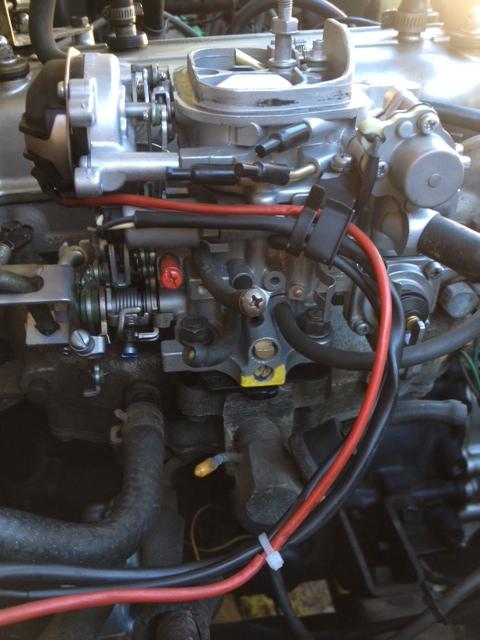

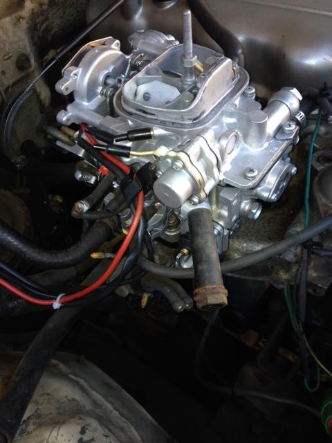

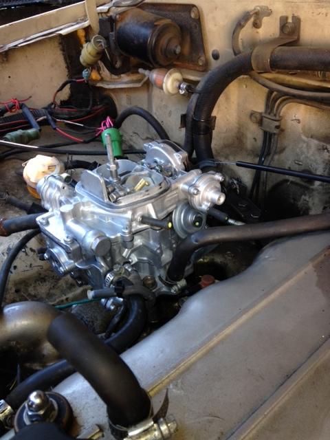

The truck - 1982 SR5 brand new motor (1800 miles) fresh head, new fuel pump, new fuel filter, DE SMOGGED see pics below (egr blocked off, canister etc etc), BRAND NEW CARB! New dizzy, new wires, tuned up about 500 miles ago new cap, rotor, plugs. New starter and the battery is about 5 years old.
The issue - This is the THIRD carb in this little truck in one year. One carb I rebuilt and the other two from Carb Exchange new rebuilt fresh everything. The problem still persists.
I get in the truck cold and it fires right up. I put it in gear and drive it down the highway to my destination. Usually about 20 miles. I then shut of the truck go about my business for about 30 min. I get back in the truck and go to start it and it cranks and cranks and wont fire for at least 10 seconds of cranking. Finally it stumbles and fires. Black smoke comes out of the exhaust and there is a fuel smell. The butterfly on the choke is straight up and down like it is suppose to be. The fast idle and idle mix screw settings are spot on. There is no fuel in the AAP on the carb. Timing is spot on and it idles perfect. The truck has good power and no hesitation once it is up and going. Compression tests on all holes show 160. No exhaust or vacuum leaks or intake leaks. Everything else is hopefully to spec.
ANY experienced carb person PLEASE chime in!

I don't think it is limited to the carb. I posted up pics of the carb so someone might recognize a line or something screwy. I have swapped parts back and fouth. I work part time at a shop that builds the 22r series motor.
