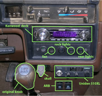

jsnby Feb 9, 2007 10:07 AM
Save the din slot.....use it for switches :)
http://jsnby.is-a-geek.com/galleries...8/IMG_0095.jpg
I have the 75wsxt....you can see the cord/plug location I chose in the lower right hand side of the picture
