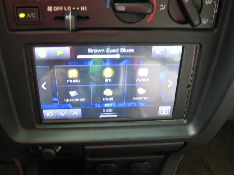

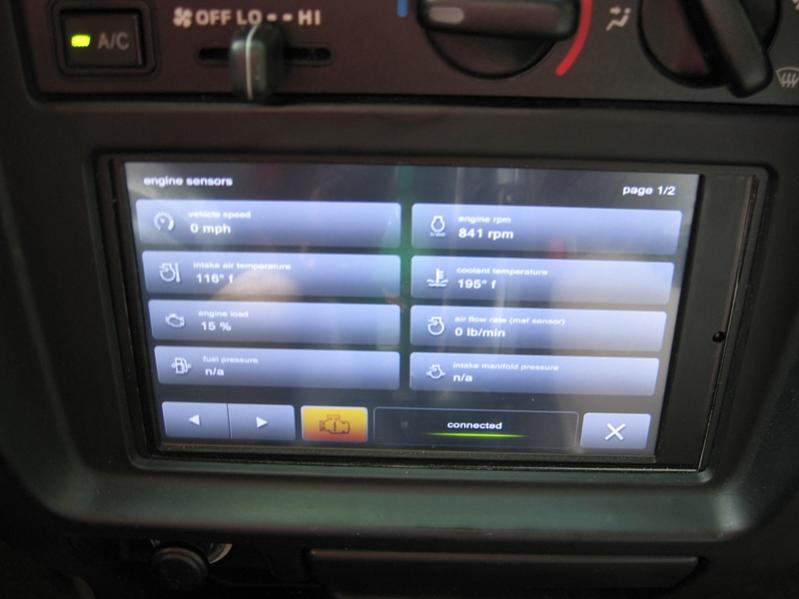

mickwheeler May 17, 2010 06:06 AM
CarPC photos
3 Attachment(s)
Here are a few photos of my touchscreen... I use Centrafuse (by Flux Media) as my front end, iGuidance for navigation and the OBD (built into Centrafuse).
Attachment 81579
Attachment 81580
Attachment 81581
