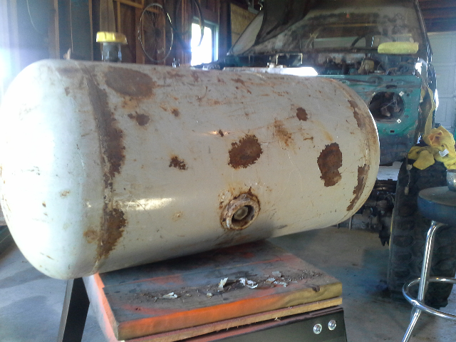

I've searched before and pretty sure I have never found a thread on this being done. I may be wrong and if so I guess I note it to my amateur status here. Hopefully I can get some good advice and maybe give some people some ideas.
#1 cheap and durable fuel cell that looks good
#2 I want to do the work myself
#3 search the scrap yards
I found a $20 propane tank with all the fitting insets I should need to make this work (fuel line out/on bottomish, larger hole for fill spot, small hole for breather). My only presumed issue will be the fuel line outlet a quarter of the way up on the tank.
Questions comments and concerns would be greatly appreciated. Also I have somehow overlooked all rules and regulations please let me know.
Attachment 94170
Attachment 94169

Interesting idea... you want to be very careful doing things to old propane tanks there may be residue left behind and interior rust can be an issue also. You'll need to be sure the tank is absolutely empty before you try to do any cutting/drilling on it.
BAGear Sep 4, 2013 08:37 AM
I've definitely released all the pressure I assume I could just put an air hose up to one side. other than that I imagine I would just throw a match and run right? Theoretically could be a good idea (not the match thing) but I figure I'll coat the inside and powder coat/rustolium the outside.. nice thing is with all the fittings I should not have to do any cutting or drilling.. thanks for the food for thought
gigatech88 Sep 4, 2013 09:53 AM
As stated above be careful cutting into it. You can fill it with water and then cut. I turned one into a air compressor tank for my service truck. Don't try to.purge the tank with air. Use some type of inert gas. Purging with air makes it more dangerous when cutting.
If you're using it.for gasoline id recommend cutting it in half. Prepping the inside with tank restorer used for motorcycle tanks . If the inside looks alright and you'd rather not cut it just add more fuel filters to be safe.
junkpile Sep 4, 2013 01:09 PM
A good idea, just be careful! Like gigatech88 says, fill it with water before cutting into it. An old crazy neighbor of mine decided to make a huge set of wind chimes out of some old 100# tanks. He took the valves out and let them set/air out for a few weeks. Figuring he was good, he proceeded to make a rough cut in the first one with his torches. The tank ignited and took off like a rocket, shooting over 100 yards into my yard, and landed right where I normally am working on my projects (luckily I wasn't working on anything at the time!) Kinda cool, but SCARY! He filled the remaining atnk with water and cut them with a sawzall and had no more problems. Moral is, be extra careful, and make sure you are doing it right. Good luck on the fuel tank though, looks like you have the right idea!
Stetson_md Sep 4, 2013 01:24 PM
I can tell you from building bbq smokers outta propane tanks it needs to sit open for about 3 months for it to be safe.and you will need to paint the inside or you'll have rust chips in your gas in about a week . Youd probably do better with a water heater tank cause there generally coated on the inside already

BAGear Sep 8, 2013 04:49 PM
Pretty new at posting and on a tablet so not Uptodate on quoting people . But here it is by order of entry.
Wyo9 (i lived in Laramie for 4 years)
Q1. Its a buggy so im aquiring scrap materials for the bed. Expanded steel with braces and hinges so i can see and access the under parts. Building braces to mount the tank against cab frame. Pic1
Q2. No pump on the current tank so i figure im good?
Q3. Vents. P.O. has a 5 gallon jerry can with no vent and it works just fine. picture to is all the fittings on top. I will be venting it. Biggest issue will be the size of fill hole. 1" vent will help?
Q4. Fitting were a beast pic 2 & 3. Soaked in PB and used a BFW with a BFH and just torked those puppies. Chris Ledux was my keep um goin music.
This truck just got a major death wobble and my front axles past due for a major rebuild (thinking LROR rebuild comments?) So I have the time lol.. its my therapy from my home business

BAGear Sep 8, 2013 06:47 PM
http://i1093.photobucket.com/albums/...o/DSCN3716.jpg
Tank one 1" port(fuel inlet), two 3/4" ports(vent and gauge), one 1/4" port(plugged) mounts for bracket.

Cleaned the tank out last night with some rust annihilater product. Not bad in there AT ALL!!
Going to do it again tomorow then coat the tank. Havent decided on product yet.
