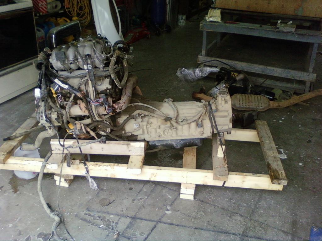

slacker Aug 26, 2014 04:47 PM
1 Attachment(s)
Rons swap engine has arrived ..
this is a automatic swap .. so best choice for this swap is the T100 .
I was able to find a 96 with 200K kilometres
delivered today :)
Attachment 129805
