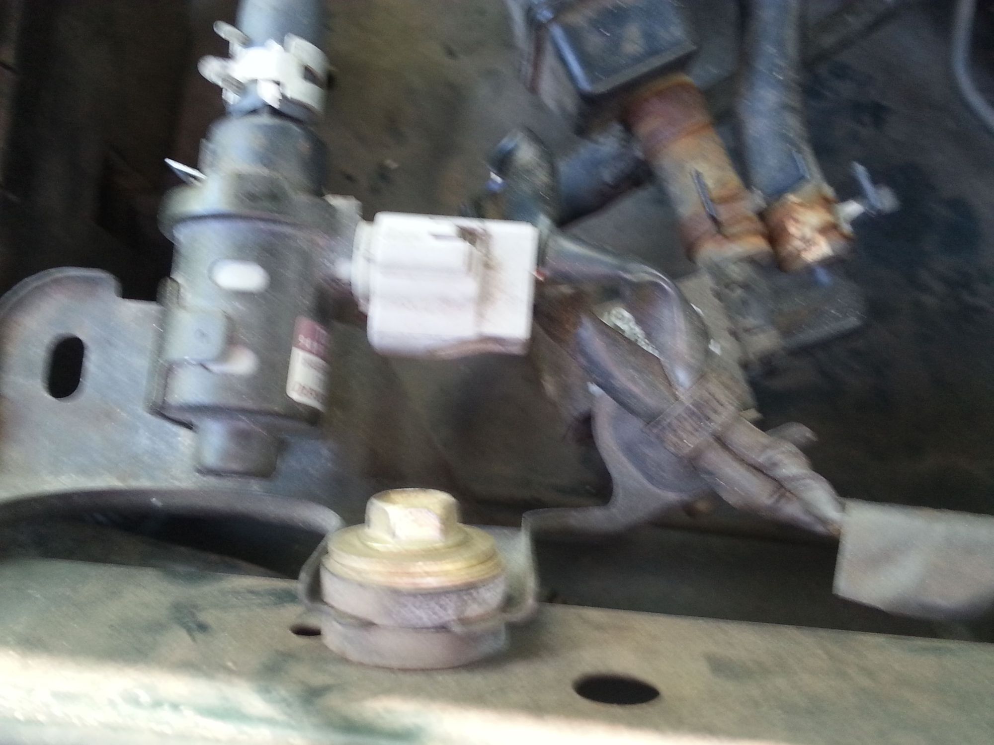

https://cimg2.ibsrv.net/gimg/www.yot...64035b60fa.jpg
Does anyone what these are called

40vern Apr 8, 2016 04:53 PM
the thing in the picture that I posted that is grey, I hooked it up to the battery with some clips and it make a clicking noise. the one that is black and has allot of rust around it it did nothing. but I may not make a noise at all
I don't have a pump now so I will have to look at it more later.

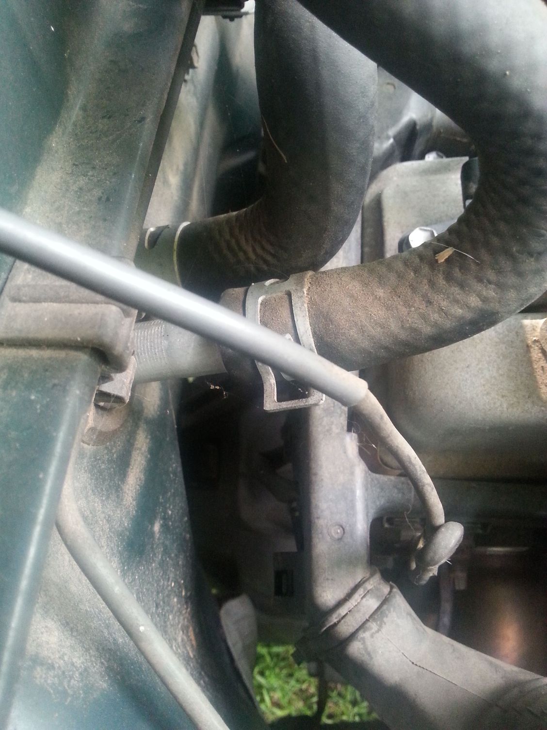

40vern Apr 28, 2016 04:35 AM
https://cimg4.ibsrv.net/gimg/www.yot...bad8de9792.jpg
Originally Posted by beast760 (Post 52319258)
I am sorry but I don't see anything their
40vern May 3, 2016 06:21 PM
Originally Posted by 40vern (Post 52316539)
In the pocture the little square thing under the wires. Well that little box I took it off and connected it to the battery. I replaced it with one from the junk yard. The one from my truck would not click at all. One from the yard will click. The serial numbers did not match up but I will give it a try.
40vern May 4, 2016 03:59 AM
if this will make the light stay off I will try and buy one from Toyota if it does not cost to much. probably will replace the some of the lines and the rusty hose clamps.
40vern May 22, 2016 10:43 AM
well I have driven the truck for about 1000 miles and the light is still out. I guess the part from the junk yard is what fixed the problem. the one that I took off of my truck would not activate when connected directly to the battery. I no the numbers did not match up exactly but the electrical connector was the same. so I am hoping that all is good
