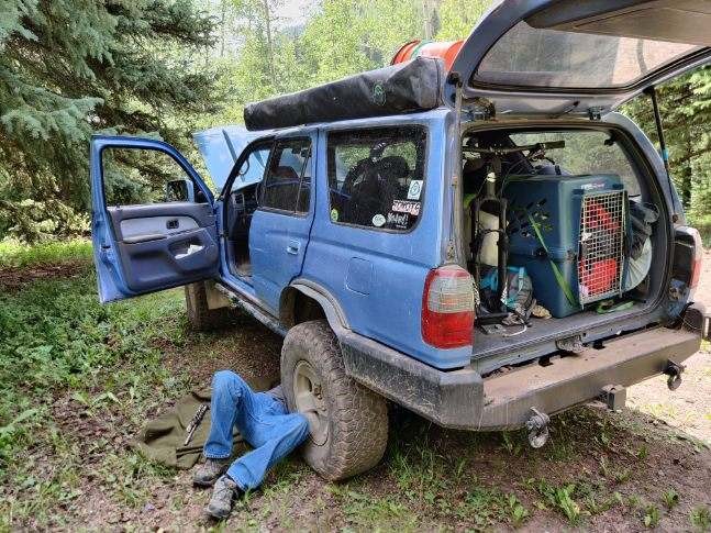

They get used.
Attachment 207318
And with the fill plates....and a lot of dust
Attachment 207319
And without the fill plates- it was fine, but you know, dog, coffee...
Attachment 207320
