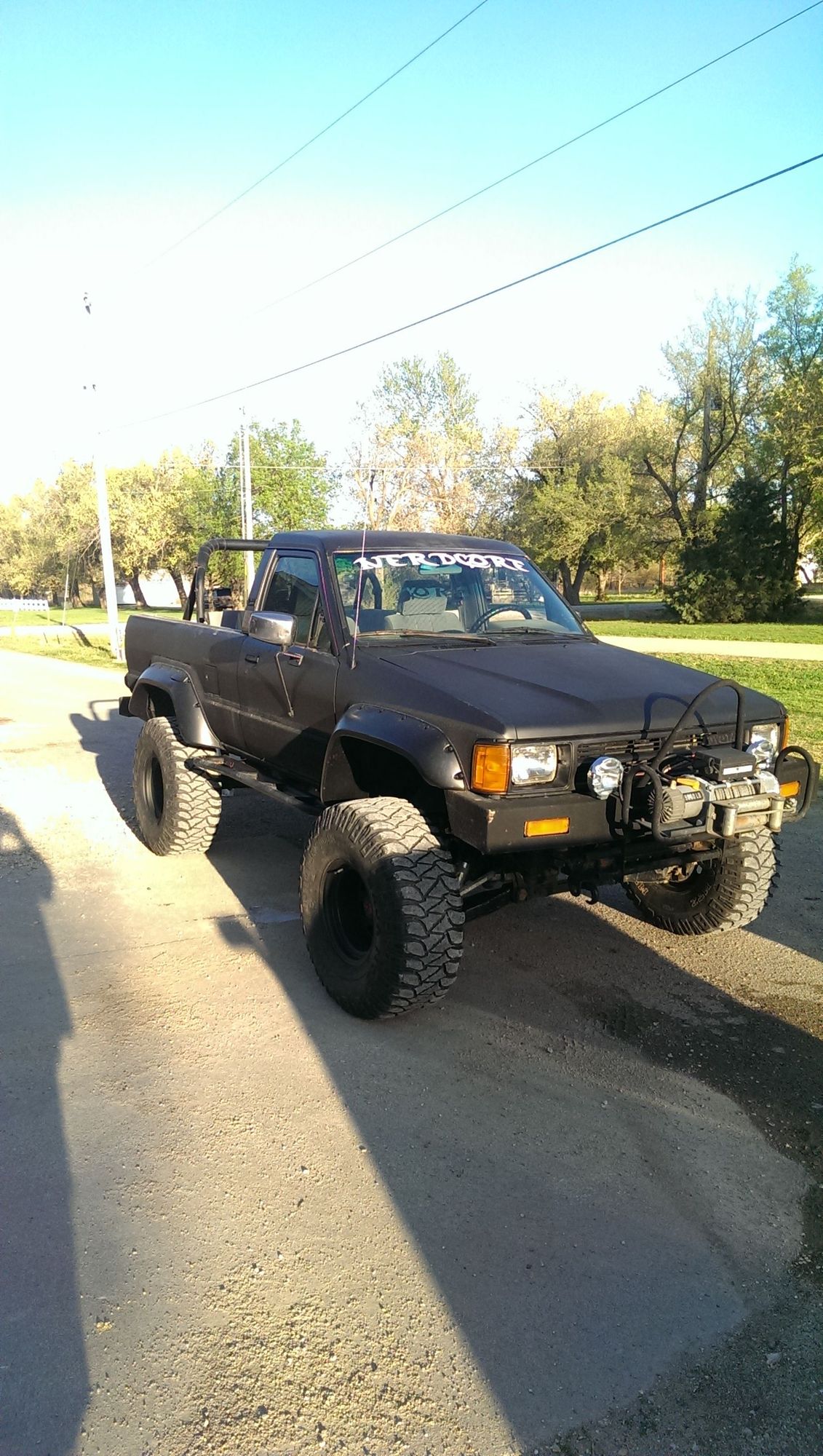

What I started with....
https://cimg0.ibsrv.net/gimg/www.yot...3138556e27.jpg
Had a 3" body lift and some swampers on it. In pretty decent shape all in all.

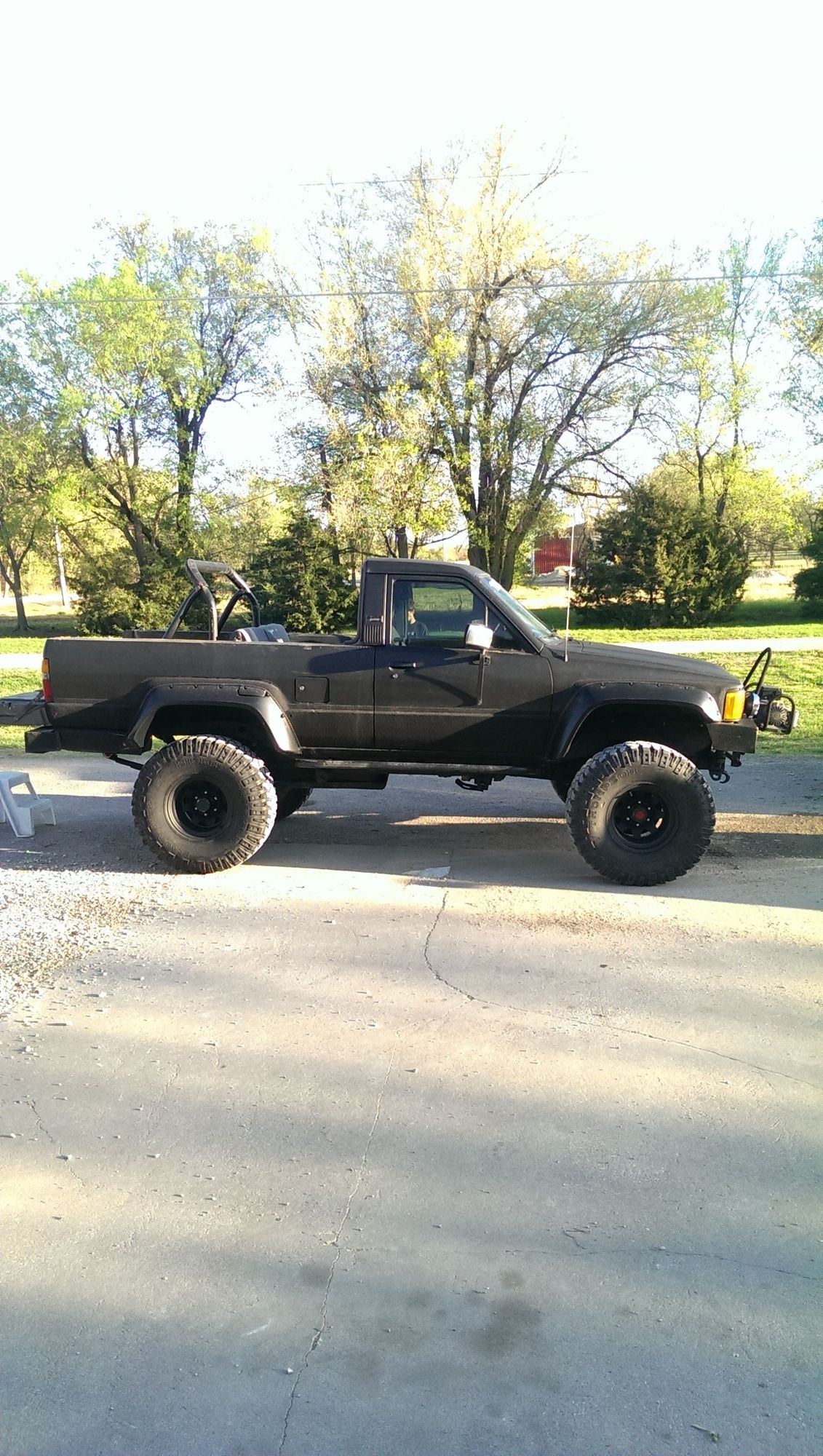

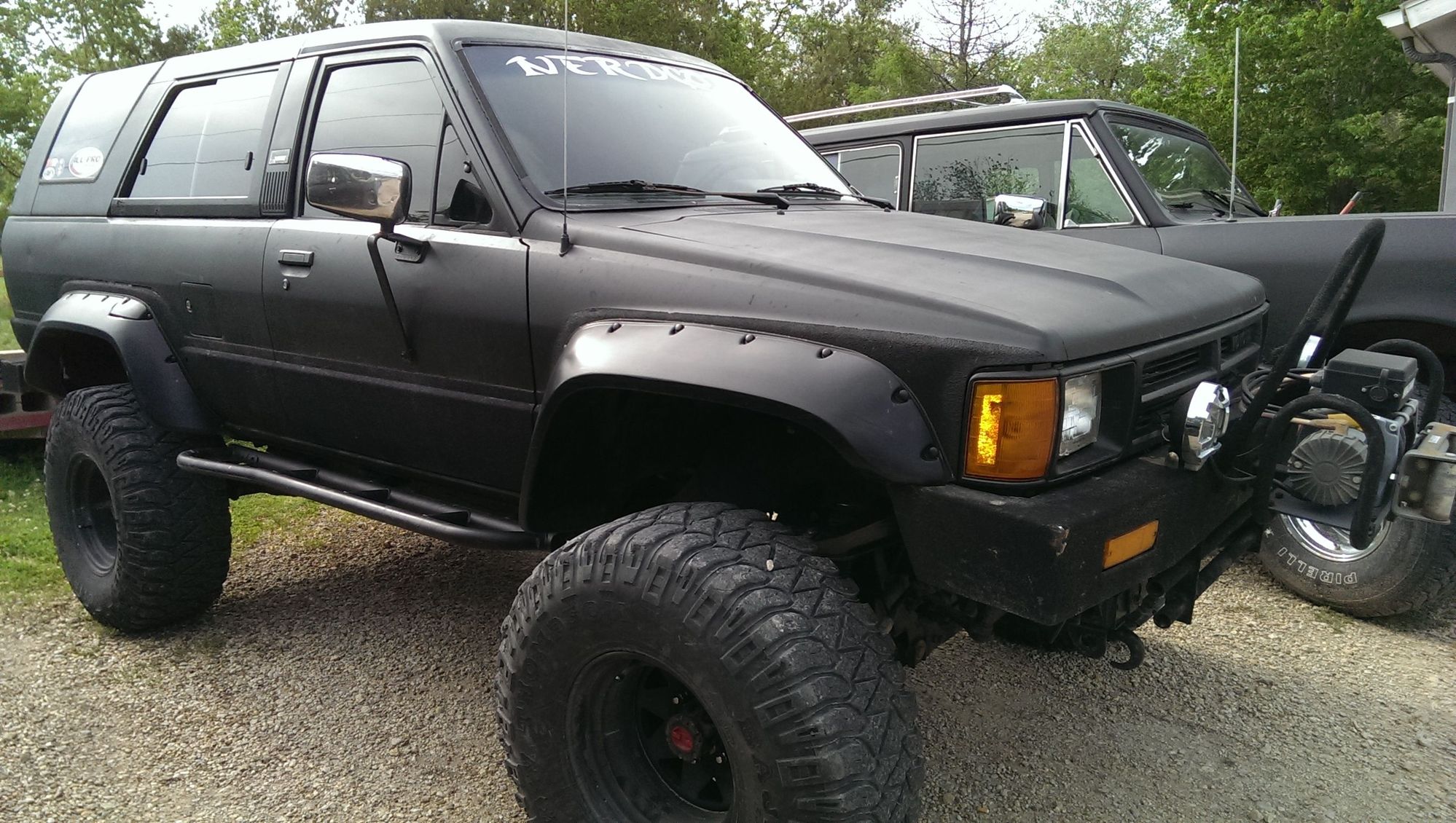

First thing I changed was those worn swampers, gave it a quick black plastidip paint job, some fender flairs, and added a Blazeland long arm kit onto it, keeping the IFS under it just to show that IFS can compete with a solid axle.
That put me here....
https://cimg2.ibsrv.net/gimg/www.yot...9151633410.jpg
https://cimg3.ibsrv.net/gimg/www.yot...aed8e69c6b.jpg

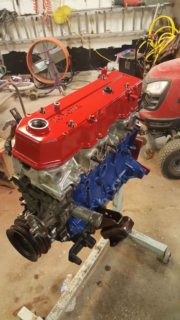

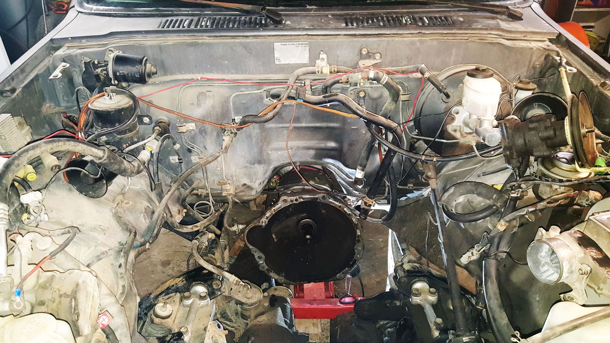

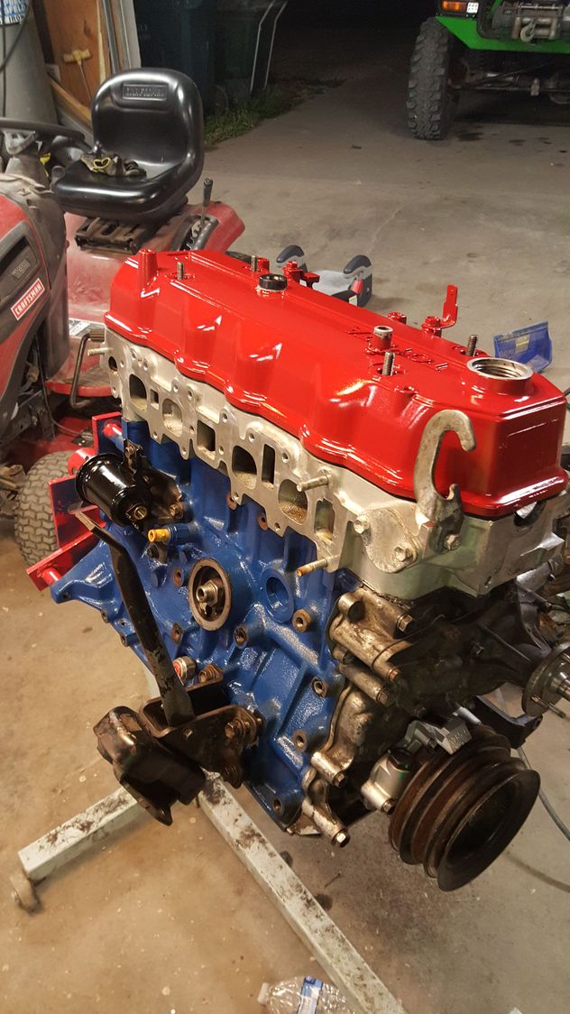

A few months later i decided it wasnt enough so out came the 300k+ mile engine. I considered the 3.4 swap but wanted to keep my 1st gen more original and decided to rebuild the engine myself. This was a monumental decision for me as i had never ever even taken a motor apart let alone rebuild one. The Cam change I had done was even a stretch for my abilities.
But it was gonna happen.....
https://cimg8.ibsrv.net/gimg/www.yot...a3ae8abe98.jpg
https://cimg9.ibsrv.net/gimg/www.yot...947ed26956.jpg
I wanted to have a bit more power but nothing over the top so I decided to go with a mild build up on the bottom end. Off to the machine shop it went for a good clean up and to bore it out 30 over.
Ended up going with a quick valve job to the head with some oversized SS valves from engnbldr and his Street RV head kit as well as his rebuild kit for the engine.
My rods were a little bit worn and ill be honest i dropped one and screwed it up so I also decided to get some LCE Street H Beam Eagle rods as well.
https://cimg3.ibsrv.net/gimg/www.yot...b424702f03.jpg
https://cimg4.ibsrv.net/gimg/www.yot...2fd8fa284c.jpg
https://cimg5.ibsrv.net/gimg/www.yot...a0759eb0cc.jpg

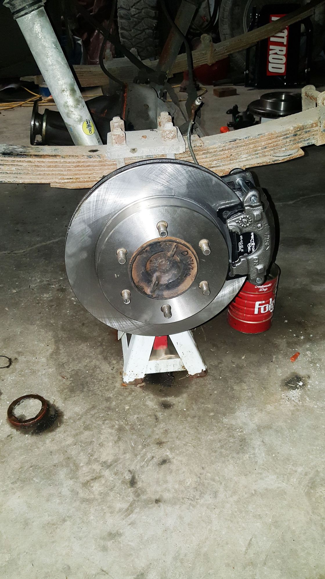

After I got the engine installed it was time to address the brakes. So in went the rear disc kit from All Pro.
https://cimg1.ibsrv.net/gimg/www.yot...fab3ebe978.jpg
Those sure looked pretty.

All in all I am very happy with the way it has turned out so far. The engine fired right up after the rebuild and is just not getting fully broke in. The power is WAY better than before and I can actually accelerate up hills on the highway now without downshifting to 3rd. The RPM's rev up way faster and a lot higher than before as well.

Im just proud that i managed to rebuild the engine and not have it blow up on me, let me tell ya that first crank was about as much stress as i could handle.
