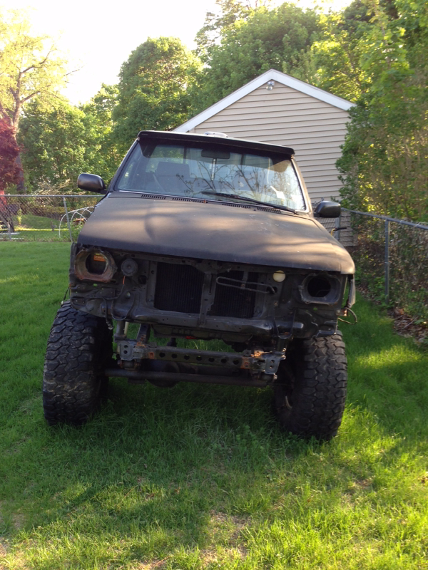

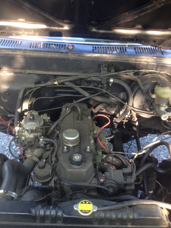

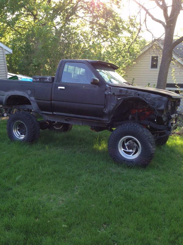

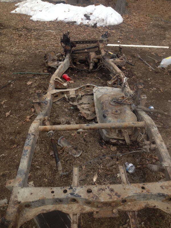

Hey yota tech I've been a lurker for a while and have a much needed build thread to post for ideas and comments Step one I bought the truck to start with this spring an 84 frame and axles with a 94 body and bed with a 22re converted to 22r and on a home made wiring harness aswell as a sweet homemade body lift made using 3 inch pipe nipples inside PVC pipe with side walls from tires and 2 add a leafs in the front and homemade blocks in the rear on 33inch interco trxus tires fronts are like brand new rears are Bald to the d Attachment 102638 Attachment 102639 Attachment 102644 Attachment 102645 Attachment 102647 Step two this truck had a front half of a frame and then the rest was just misc peices of 1/2 think angle iron :overkill: and the axles leaked to the point of dead grass underneath it So the plan was pretty much use a donor frame I have from a 91 pickup with a trail gear front spring hanger and shackle set ups I got with the truck and turn it into a cool first truck that I can drive on the road "considering I've had 5 that I drove and parted out with in the last 2 years" I was going to keep it kinda basic with regular push pull steering and maybe lift springs in the front because the double add a leaf was just as good as welding the axle to the frame The new plan (as if this week) it's to 1. Six shooters and high steer arms 2. Dual transfercase (the real challenge) 3. Rear disc conversion and v6 ifs front calipers on fj60 rotors in the front 4. Chopped and balanced drive shafts for the front and rear with dual transfercase 5. New rings on a set of pistons with 80 thousand miles on them I have had laying around and all new gaskets too to bottom 6. Pinion seals on my locked rear 7. Rebuild and paint one of my nicer looking ps boxes Well it's been about 2 months from then till now and so far I've completed motor swapping the truck just to test a 22re I had picked up cheap and wheeling through woods aswell as cutting all the ifs stuff off the motor frame and starting to clean it up This week I finally started to get stuff moving I tore down the whole truck down to a bare frame I set my cab up on blocks for the time being and dug into my front axle (greasy) I have pulled that all part down to the hubs and knuckles I am going to replacing with trail gear 6 shooters and high steer arms because the push pull was not my cup of tea and the previous owner welded the tie rod to the ends plus I have 3 ifs steering boxes sitting around . I also started to get rid of some rust on my 91 donor frame I found the best method to remove rust is the flap disc on a grinder so just this weekend did i flap disc my whole frame and paint it with my duplicolor something paint in my harbor freight gun and get that rolling all that's left for me to do with it now is weld on my spring hanger and shackle mounts I also went ahead and tore down my 22re to a long block for now because that motor has as much compression as a soccer ball Attachment 102640 Pics of the frame before blasting Attachment 102646 I also got to painting my axle housing I made sure this got an immense amount of loving with the sand blaster as this is worth it's weight in gold to me Attachment 102642 Attachment 102643 And I aswell came up with a simpe differential plug for painting ( yes I taped it up all nice before paint ) Attachment 102641 I also have a few questions for some fellow yota tech friends 1. Does any one run antiwrap bars 2. I was thinking of running a brake pressure regulator for the rear with disc conversion to prevent lock ups as I don't really want to run a stock toyota proportioning valve think this would be effective Attachment 102648 3. What does everyone with dual cases do for drive shafts I really can't afford trail gear or marlins I have a shop local that will chop and balance my stock ones but I'm not to sure about stock shafts travel And this is as far as I've gotten their will be many updates soon I can't wait for the dual transfercase and six shooter segment of this build their will be many more pictures coming

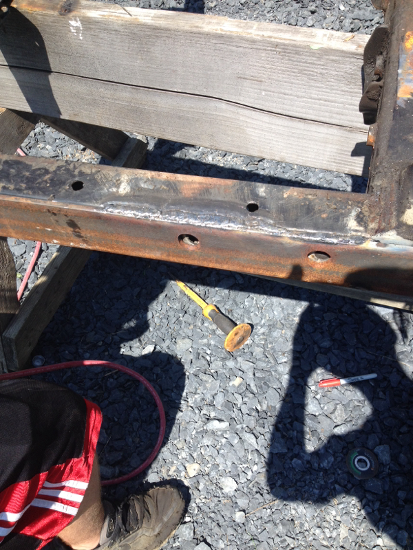

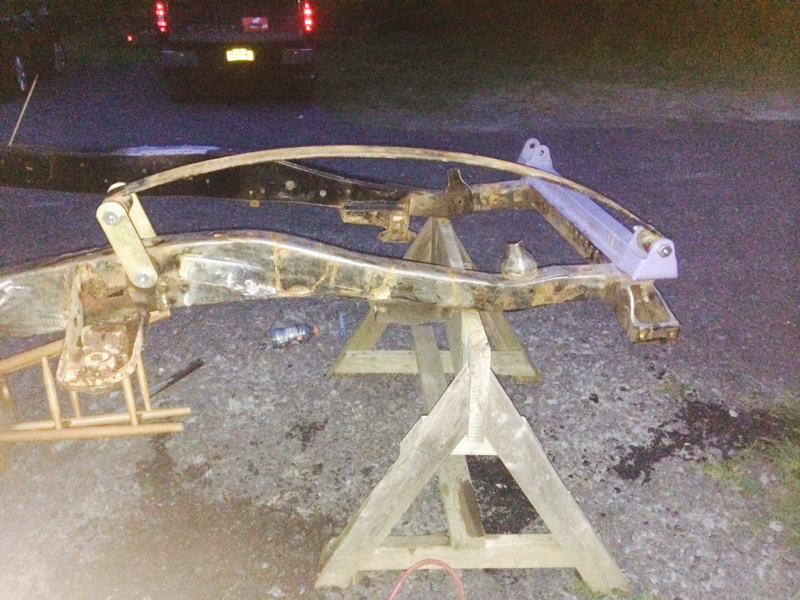

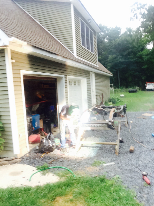

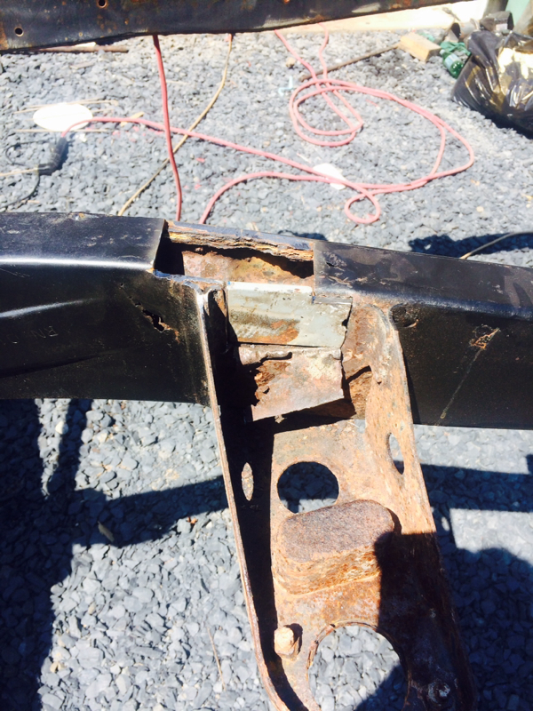

So today me and good old buddy weeg went real hard on the frame we make a nice patch by the driver floor pan body mount out of 1/4 inch steel and made it look real factory by grinding smooth
Attachment 102670

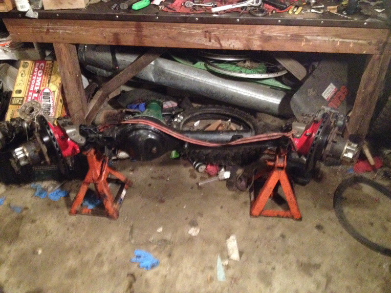

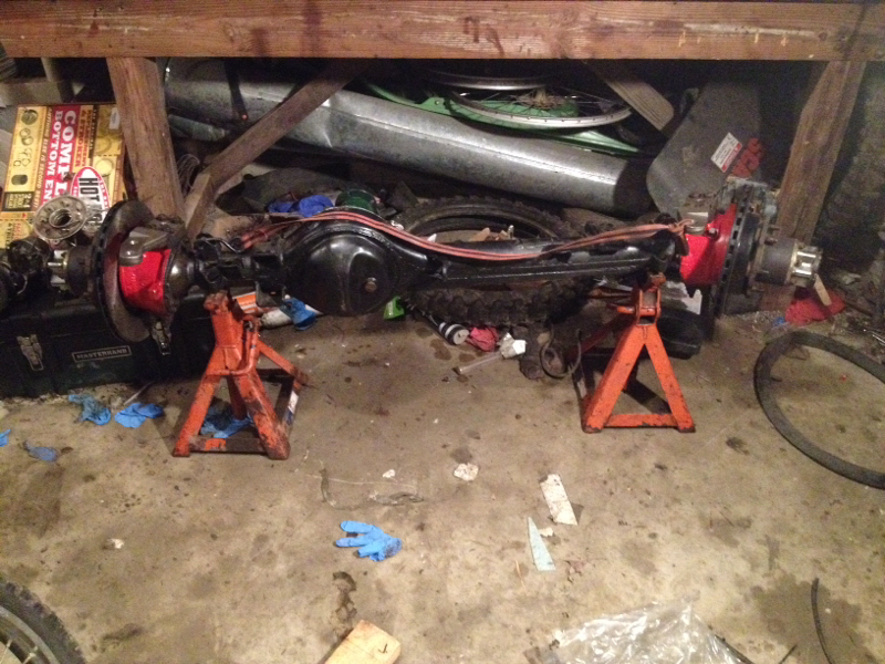

We then finished welding on 1/4 inch angle iron on the front of the frame for the spring hanger just to clean it up and welded on the spring hanger Attachment 102666 We also took apart my rear end to see what I knew was a welded rear end but I wouldn't have expected it to be that bad and I know im now going to tear that down and give it a good taste of 7018 and also pressed off my axle and bearing cup and those bearings were so shot they are a possible candidate for creeper joints aswell as front rotor studs for fj 6o rotors and v6 calipers Attachment 102667 If you can see all of the welds cracked and are quite sloppy I also got to cutting holes for my frame tube that holds shackles and the hole saw broke half way through so I got quite anxious to put those on so I cranked up the welder to 250 amp and whipped out some cutting rods and went to town a bit sloppy but very effective The way I moved my spring hanger forward will move my whole axle forward so my little templates from the trail gear kit didn't do my much help so I have a 1/2 space on one side of that tube but I plan on drilling a hole it a plate and cutting it to match the frame so it will work like a gusset and hold in that tube for shackles Attachment 102668 A nice pic of me sparking her up in the drive way Attachment 102669

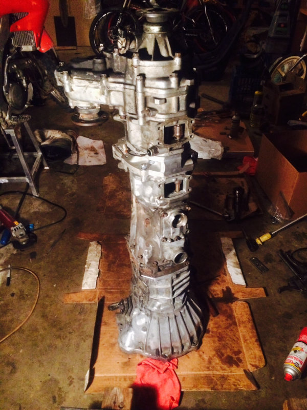

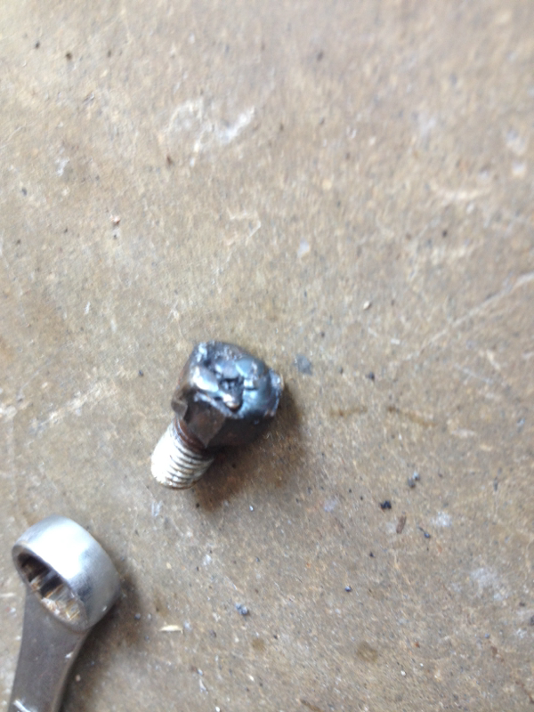

So another update on the thread it's been about 2 weeks and I've finally got all my axle painting done and I am just waiting on seals for both and wheel bearings for the rear to have those ready I haven't done too much on the frame I just completed the both spring mounts to the frame and tacked them into place but one thing I have gone deep into was my dual case set up The dual case took like 3 days longer then it should of because my forward shifting front case broke off 14 bolts as some one took then off previously and the pocket below the head of the bolt and above the threads aloud for corrosion and allowing most of them bolts to brake (even a 1/4 rachet would brake them) and this made my welding nuts to broken bolts tactic very useful but after I took care of all that with in an hour I had build up my entire dual case using the kit from trail gear so I'm glad to have that done and out of the garage as it contains practically an entire drive train to the truck and what ever else is in their Attachment 102734 Attachment 102735 Attachment 102736 Attachment 102738 Attachment 102737 With this done and once my seals and bearings are here in a week I should have a driving truck again

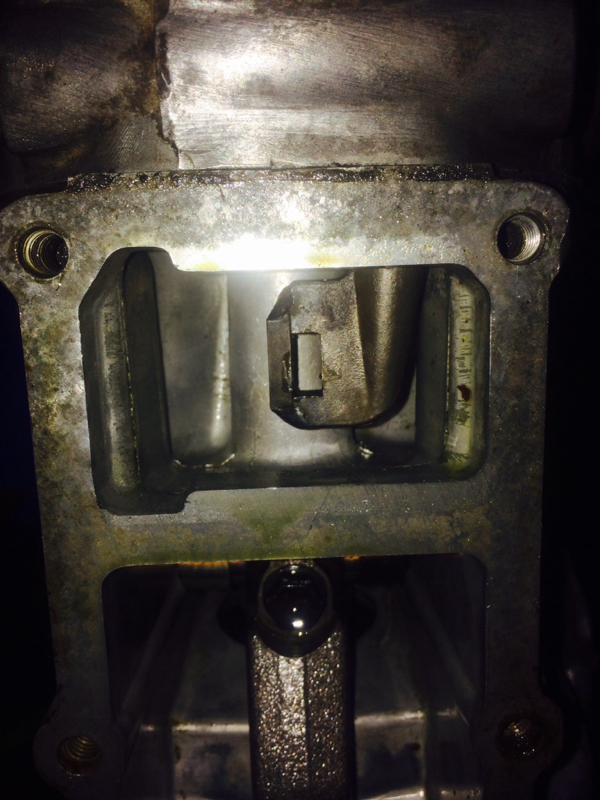

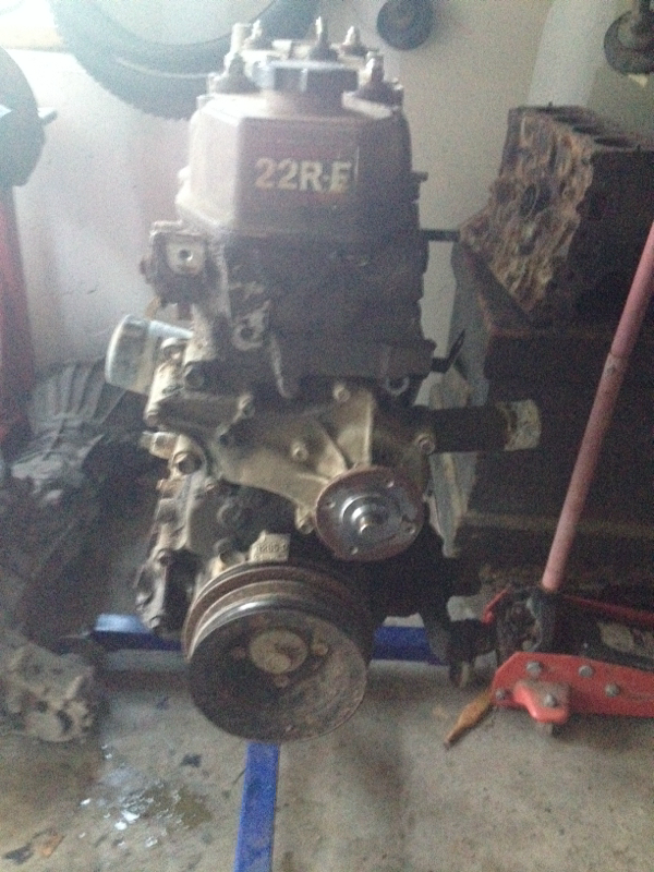

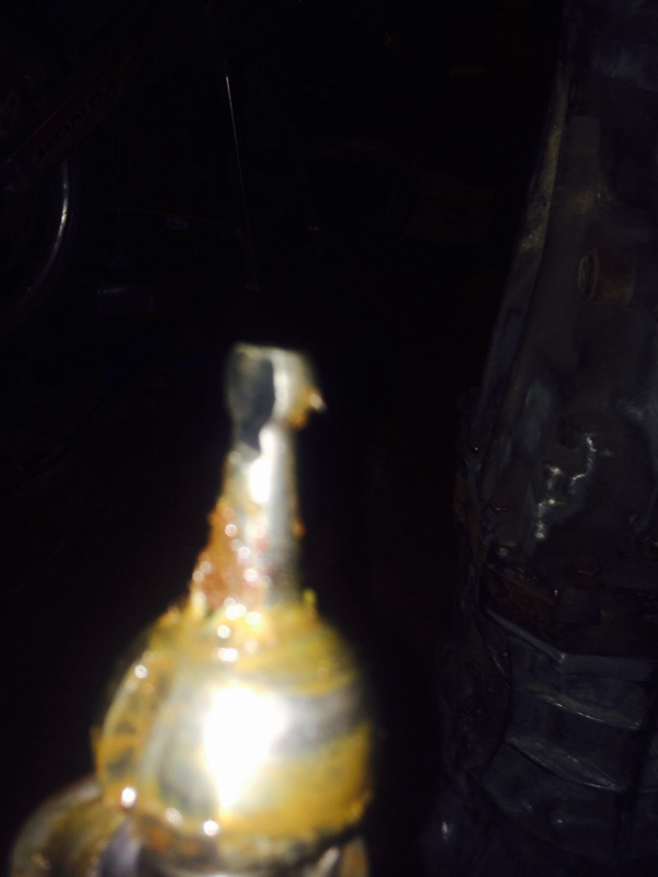

After a long month of staring at misc. parts lying in every crack and crevice of my garage I decided to call up my buddy weeg and get back to work First to start was the 22re, the plan was to just replace the head gasket and do any necessary machine work done. As I took off the head I noticed a channel that ran into the head bolt between cylinder 3 and 4 filled with an oily sludge and the head bolt their had been very oily and looked different from all the others. at first I didn't think anything of it so I began to re assemble the motor until I was dropping in head bolts did I see when I placed that one head bolt in a crack opened up from the bulge in the block down the water jacket. This letf to me proceeding with stupidity to weld the crack back together… after realizing that I definitely warped the head I decided it was Time to break out the 89 22r block I had sitting in the basement. I went on. To sand blast this block for hours with a sand blaster as old as the sand that ran through it then painted the block in 10 + coats of glossy black high heat to achieve a look this good Attachment 103081 Then I went ahead to hone all of the journals and cylinders and deck the head and as you could see assembled the rest of everything I next went on to clean up all of my efi manifolds and rebuild injectors which went pretty smooth. To clean the efi manifold I used a resin disc to sand everything nice and smooth to polish able aluminum And all within the same day I managed to helicoil the caliper on the passenger side knuckle and rebuilt my axle Attachment 103082 Attachment 103083 Now I am left with a complete motor , dual transfercase tranny set up , and front axle all that's left now is a little welding on my frame then paint and rebuilding of my rear axle then I will be back behind the wheel
