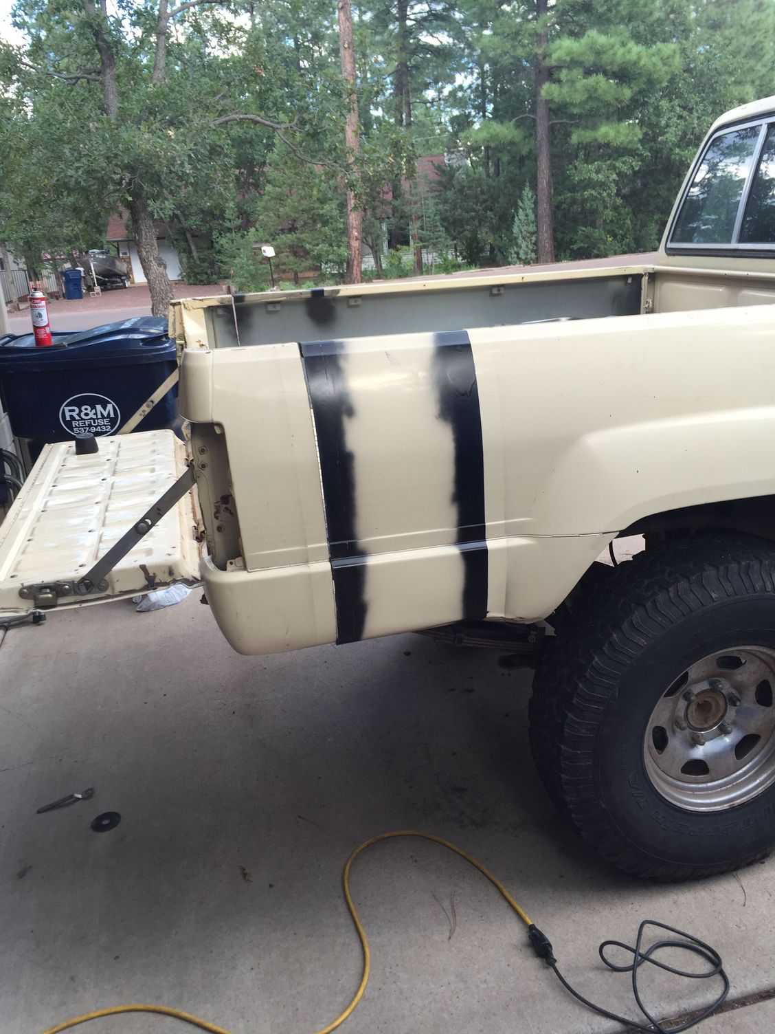

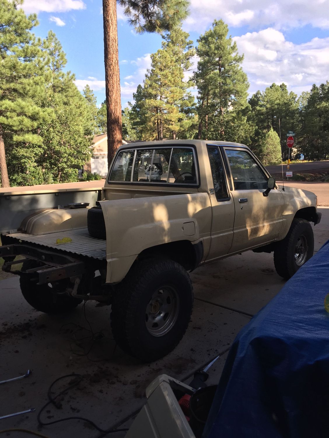

86 ext cab and bed on 85

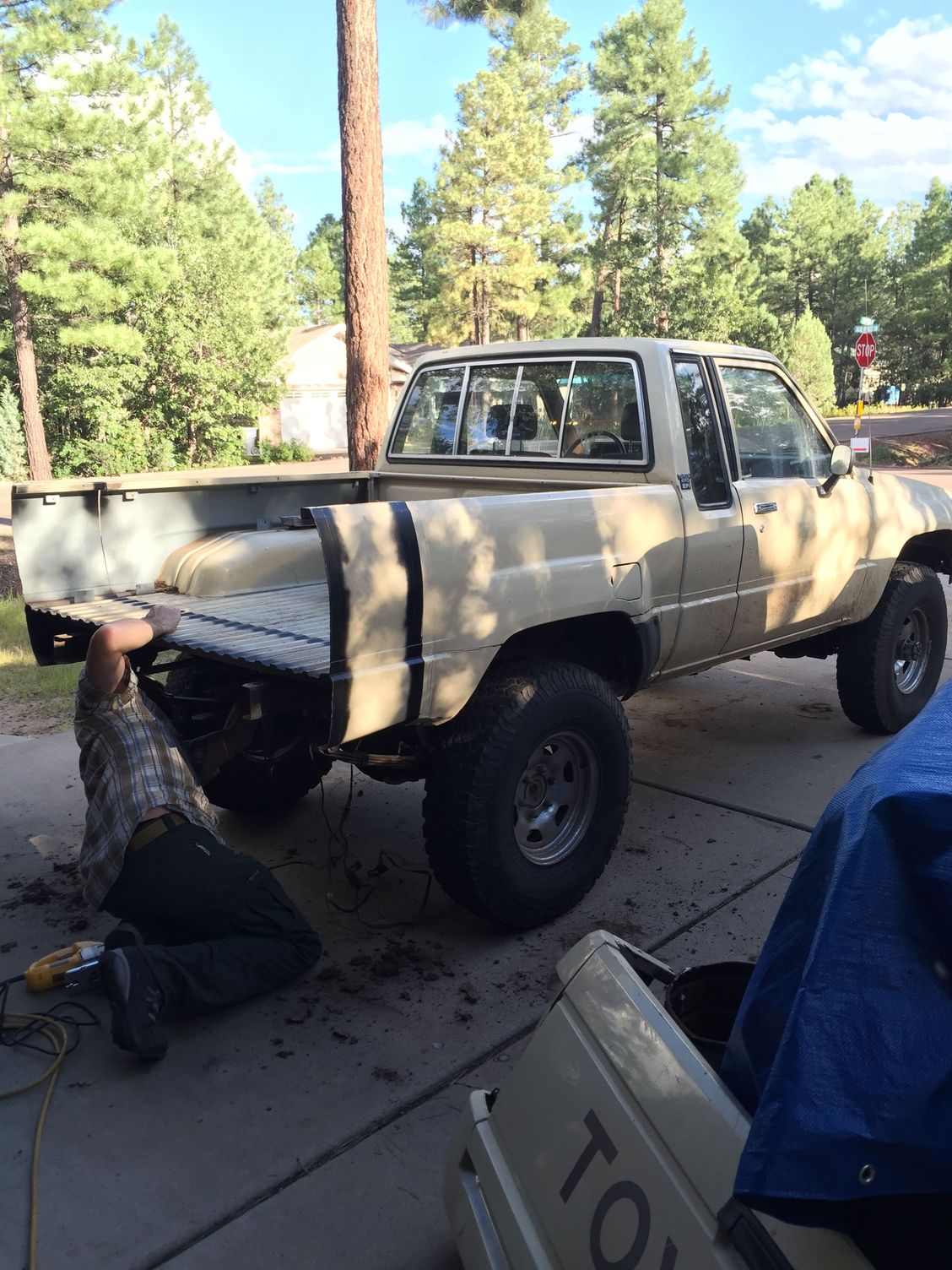

single cab frame
:saw:
https://cimg2.ibsrv.net/gimg/www.yot...0792d7775.jpeg
https://cimg4.ibsrv.net/gimg/www.yot...3c148e27f.jpeg
https://cimg5.ibsrv.net/gimg/www.yot...fee12b8d1.jpeg
https://cimg6.ibsrv.net/gimg/www.yot...a593770ee.jpeg

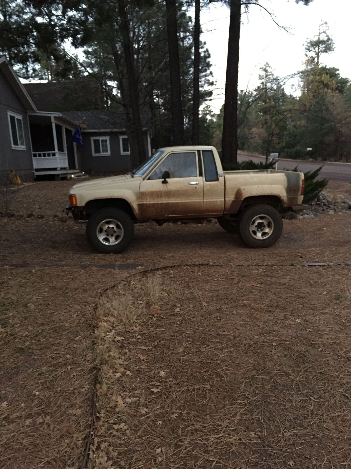

85shortYota Nov 12, 2015 07:37 PM

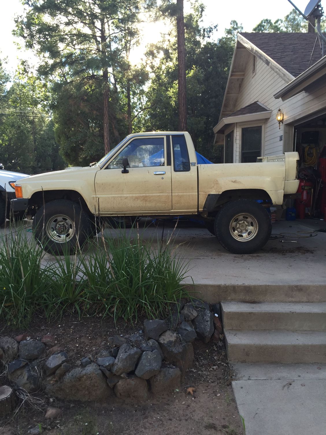

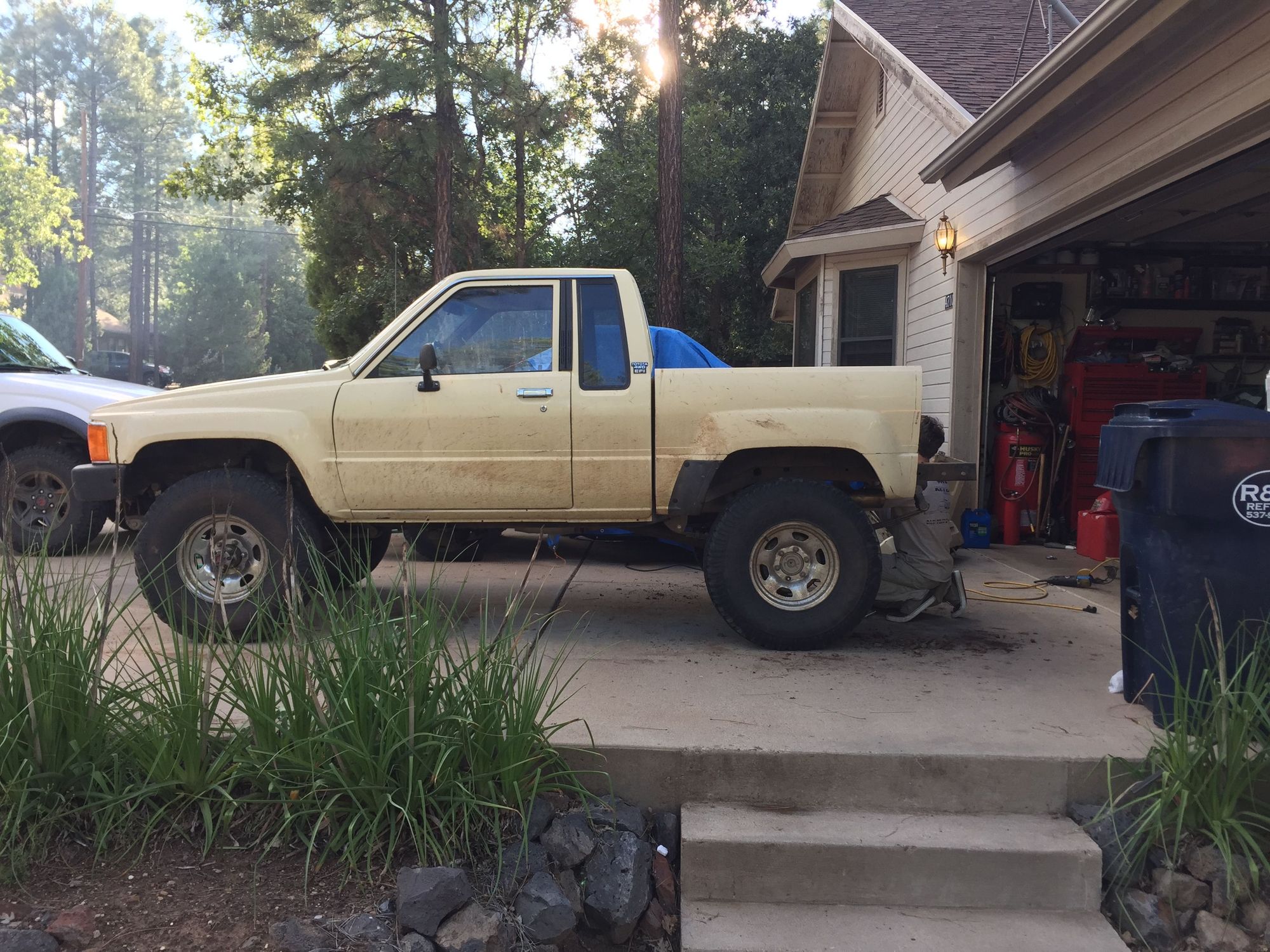

New fj80 16x8s, had to get wheels spacers to fit and swapped the rear axle to the wider ifs one to match the front.
https://cimg0.ibsrv.net/gimg/www.yot...4d8f88a07.jpeg
https://cimg6.ibsrv.net/gimg/www.yot...c7cbc2b81.jpeg
Looks kind of goofy with 265/75s i know, oh well.

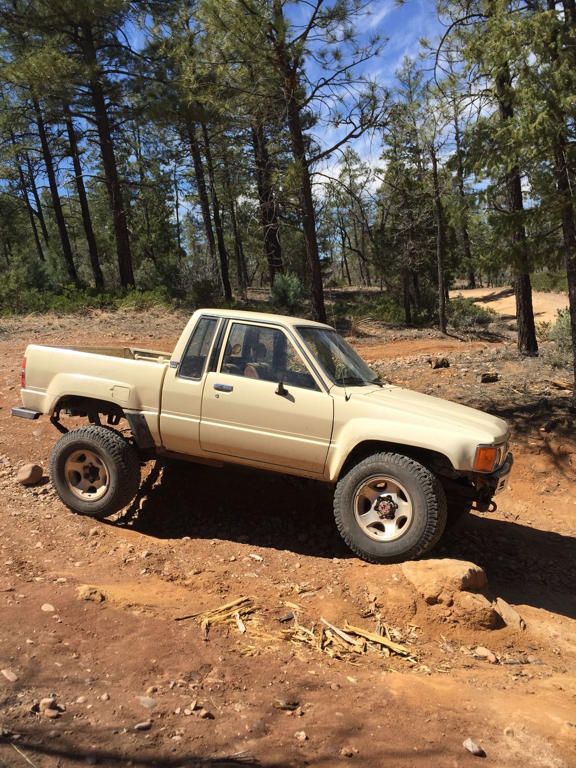

85shortYota Apr 4, 2016 01:36 PM

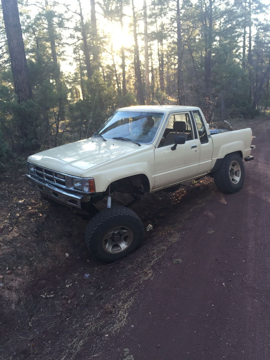

Snapped some pics at a local trail. Ordered stuff for hy steer and RUF conversion.
https://cimg4.ibsrv.net/gimg/www.yot...83f8a5bd1.jpeg
https://cimg5.ibsrv.net/gimg/www.yot...3a648ef5d.jpeg
https://cimg4.ibsrv.net/gimg/www.yot...3078cd7d4.jpeg
rustED Apr 4, 2016 02:00 PM
New wheels look good on there, I really like the looks of the stubby bed! How much did you have to cut out to make it fit? RUF springs and high steer are going to make a big difference!
85shortYota Apr 4, 2016 04:42 PM
Yes it definetaly will, i cut 9 out of the front if the bed and 12 out back. Stock springs and shocks are just not cutting it.

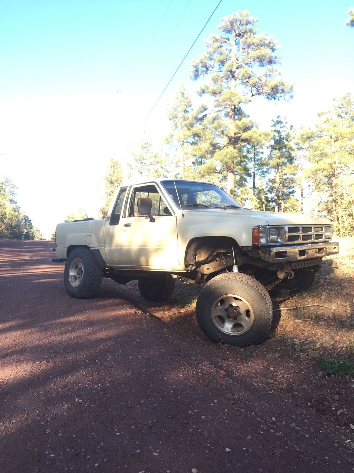

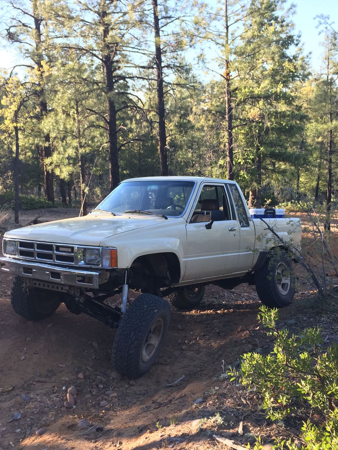

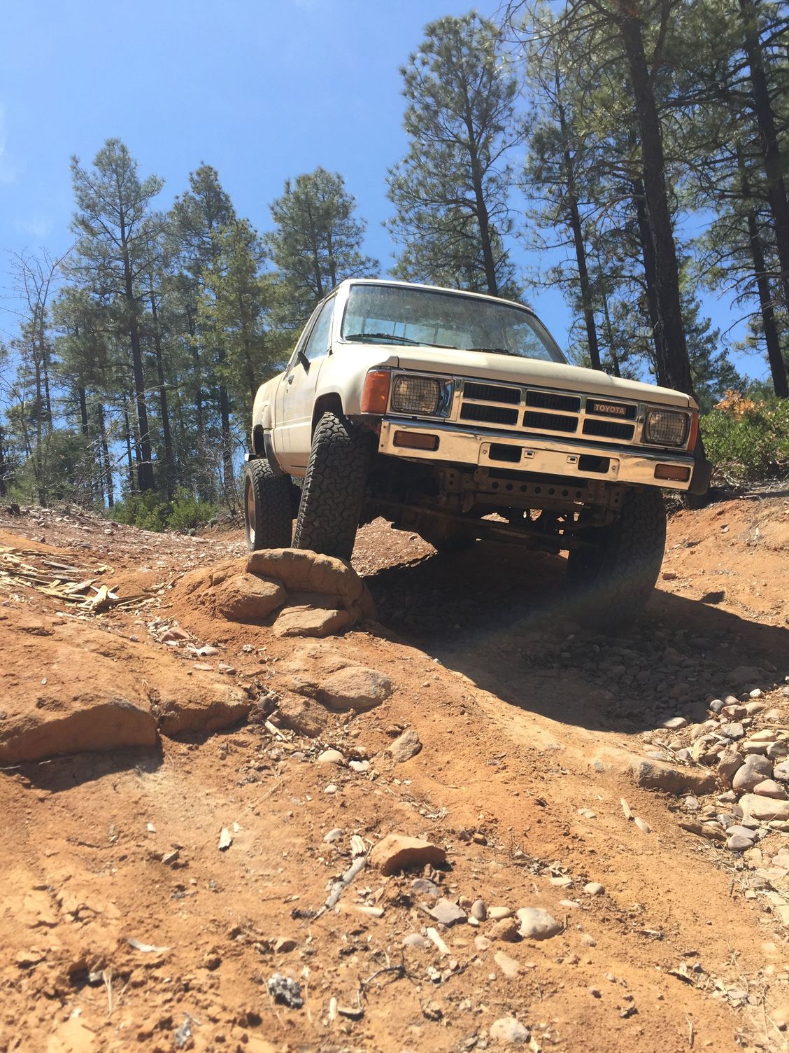

85shortYota May 9, 2016 07:29 PM
Installed hi steer and 5 pack ruf with stock spring hanger and skys banana shackles. Flex is better than i thought.
https://cimg8.ibsrv.net/gimg/www.yot...e2ef01a1d.jpeg
https://cimg9.ibsrv.net/gimg/www.yot...ecdd9d0a1.jpeg
https://cimg0.ibsrv.net/gimg/www.yot...95cfae27a.jpeg
Seebolt May 11, 2016 09:02 AM
Hi Steer
How does the Hi Steer handle? Much better??
85shortYota May 12, 2016 12:18 AM
oh yea for sure night and day difference, i can turn the wheel with my finger on the pavement.

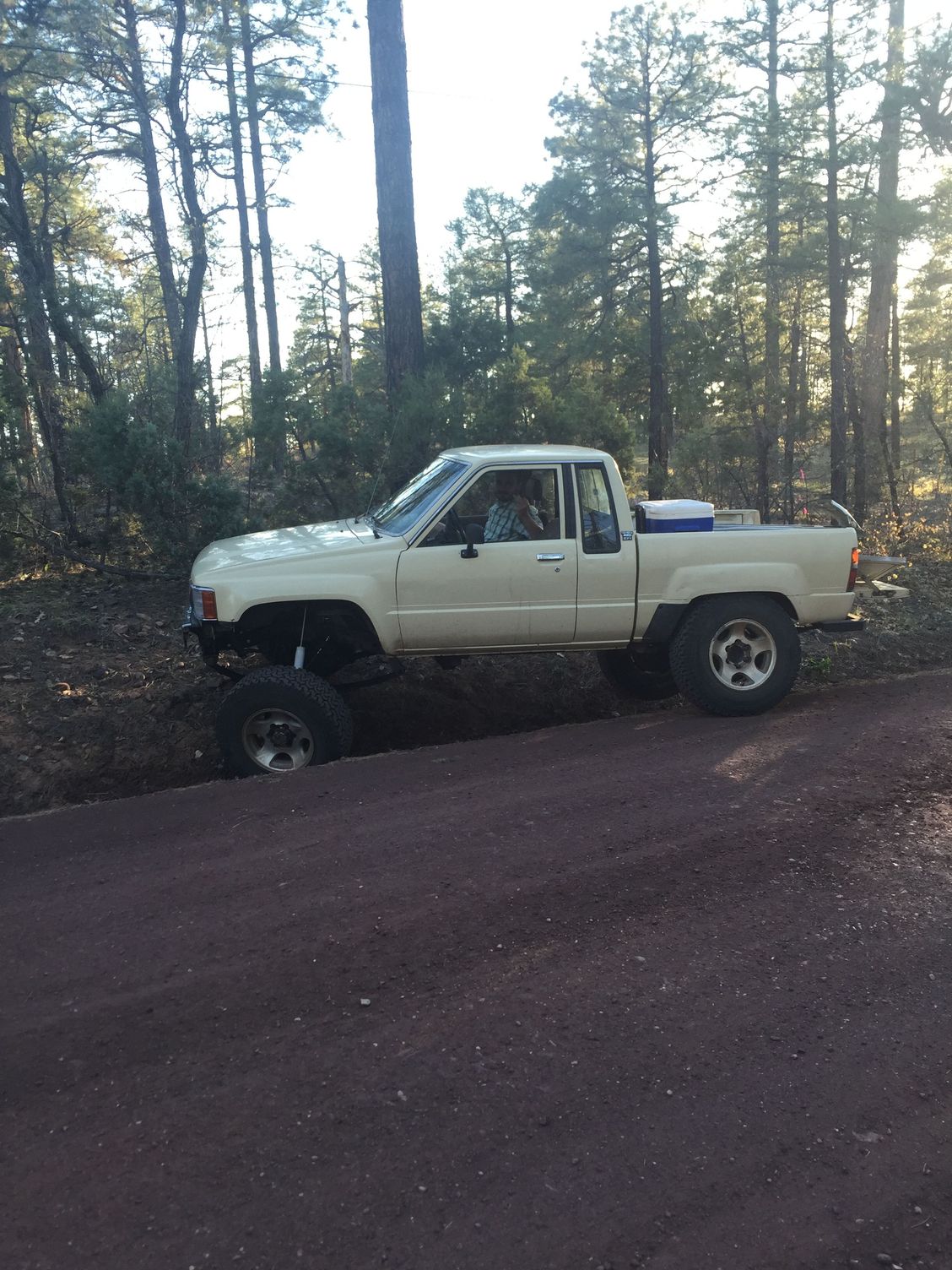

85shortYota May 12, 2016 12:19 AM
https://cimg3.ibsrv.net/gimg/www.yot...0bab02fa9.jpeg
Another photo from local trail.
