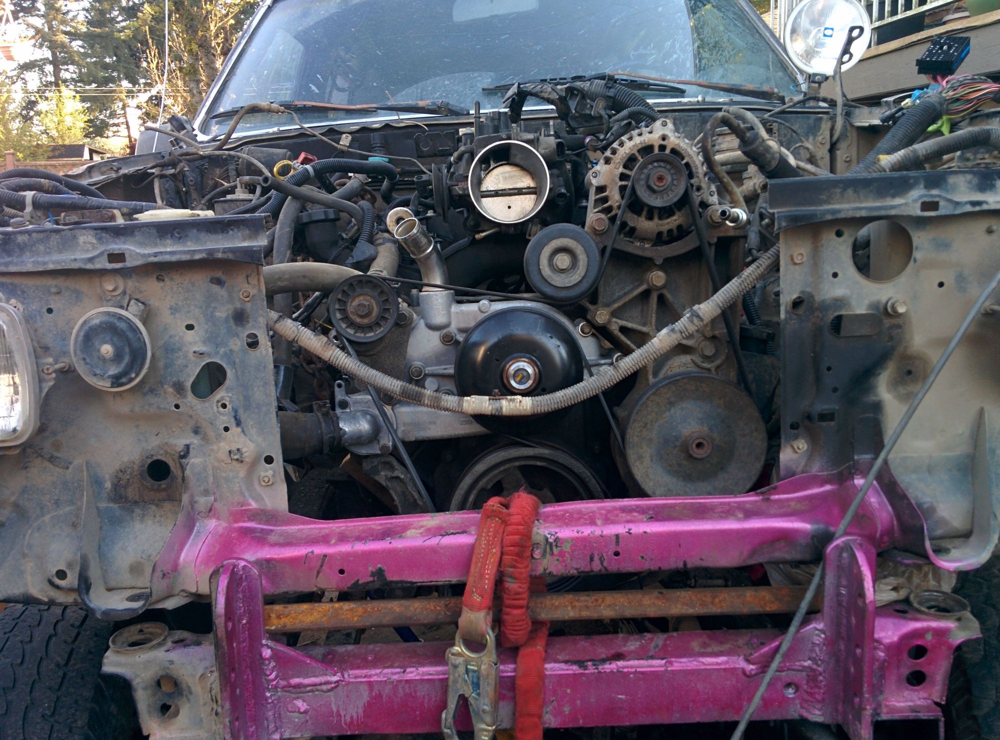

˟˟˟˟, forgot to update. Figured out lots.
Yes, a swap typically takes me a few days at this point, assuming I know where I want the build to go before I start, and have all my parts on hand. I spend more time tracking down parts (cause I have to order everything from the US because Canadian vendors are useless) and looking for my ˟˟˟˟˟˟˟ sockets, than I do actual swapping motor. The 6.0L swap we did a few weeks ago pretty much took 2 full days of work.
Higher COG unacceptable. The entire reason for this build was because I wasn't happy with my XJ's side hilling stability. It's already pretty damned good, and miles better than most rigs I wheel with and/or run into on the trail, but I know I can do much better. The XJ's motor ended up 1-2" higher than I'd have put it except that when I did that swap, I didn't know what I was doing and ordered conversion mounts from Novak. They put the block arbitrarily high. Compound that with the Unibody being top heavy and having a suspension that actually articulates (most XJ builds are stiff as hell), and I just don't feel comfortable on anything > 40 degrees at all.
But, I did manage to get the motor very low. I've currently got the top half of the stock chevy motor mount bolted to the block (just so I have something for reference, and to support the motor temporarily). The motor is far back enough that the stock mount is actually 1mm behind the stock yota frame mount. This gives me enough room to put the stock runner rad in front of the motor, though probably not enough to put a decent flowing e-fan behind it. Not sure what i'm doing about that yet. May chop the firewall and bring the motor back another inch or two.
But for now, I've got clearance everywhere, and the hood fits, with no body lift.

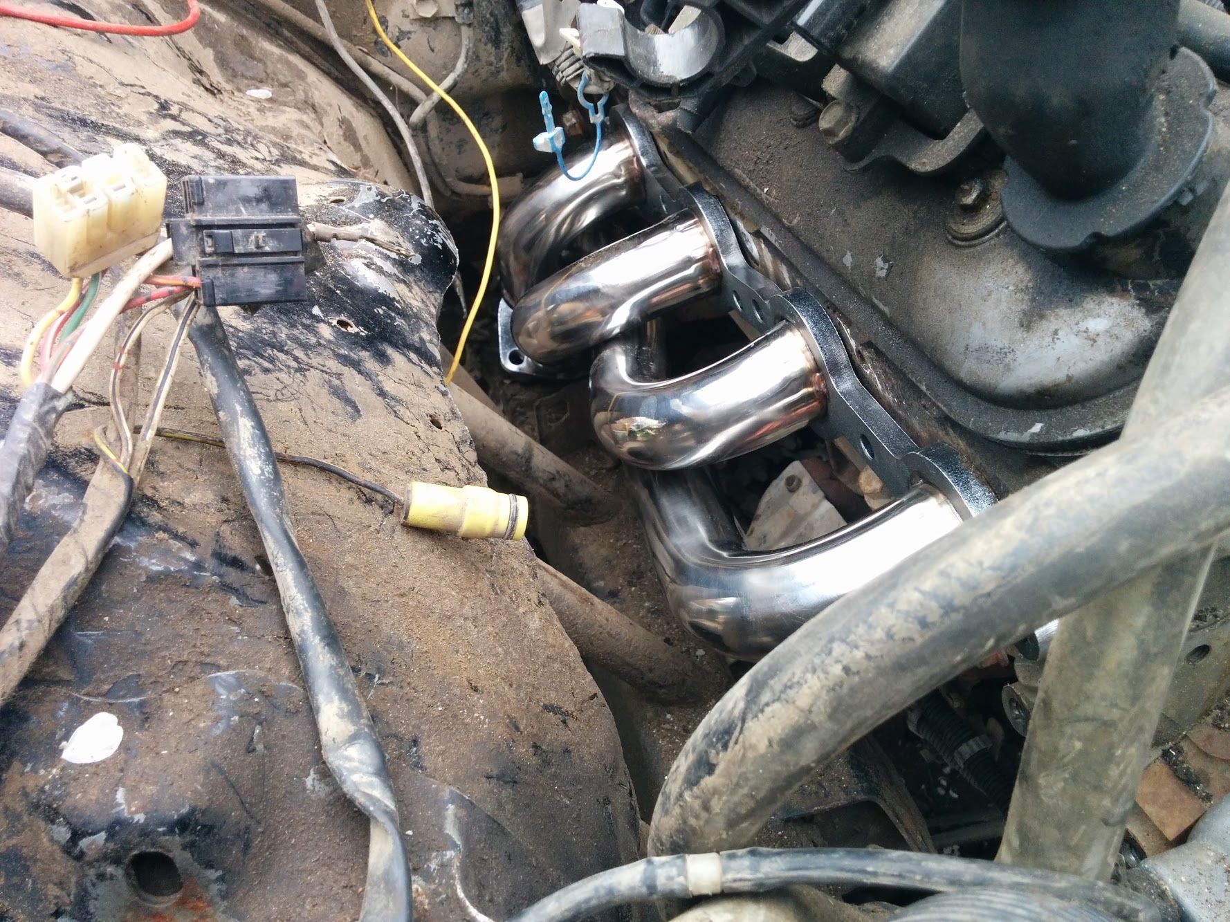

These are the same headers I used for the last 6.0L swap in the 1500. They're block hugger shorties with rear dump. Impossible to find in Canada, absolutely everywhere in the US. Picked these up from Amazon for $180 - https://cimg1.ibsrv.net/gimg/www.yot...a4d98283f5.jpg
https://cimg2.ibsrv.net/gimg/www.yot...847d924f29.jpg
They fit almost perfectly. Had to trim some of the inner fender just to lose some of the annoyance. The collector clears the frame rail, but the flange ring does not (I was expecting this). I'm going to just chop off and extend the collector 2-3" so the ring is below the frame.

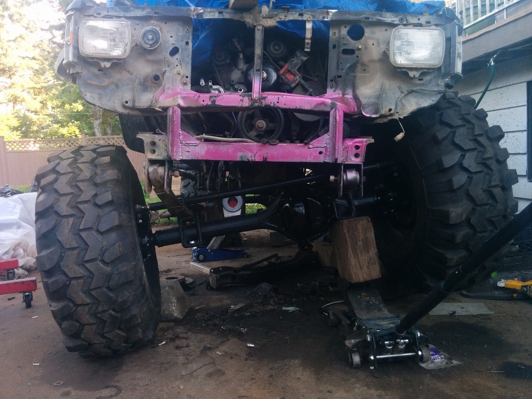

Ben Feral Selinger Apr 19, 2016 08:14 AM

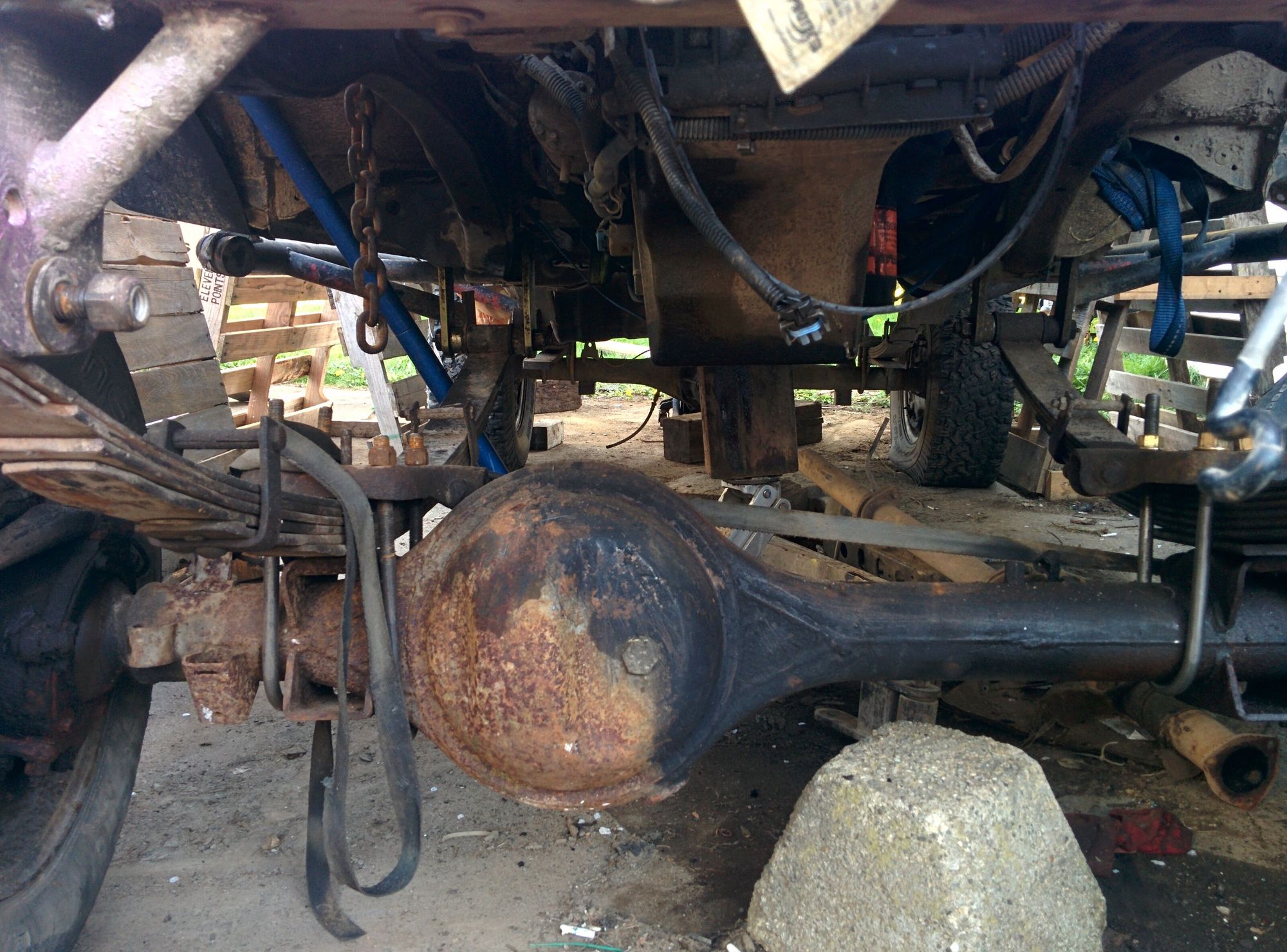

Okay, so I've got the motor placed and temporary motor mounts mocked up. I've got clearance for headers to sneak through, everything clears under the hood, oil pan to diff clearance is good (with a driver drop). But I've got a problem.
Flipping the LC 60 axle around for driver drop 1. because there's way more DS clearance on the driver side and 2. I can't find a pass. drop case with a front output far enough out from center to clear the trans pan without running the DS right under the trans.
I pulled the front axle again and stripped it, and cut the front cover off as it'd have to be spun 180 for the now rotated third/ring gear.
https://cimg0.ibsrv.net/gimg/www.yot...db7850d6e3.jpg
I was planning to staying leaf sprung for now just because I want to see how far I can take a leaf sprung rig. I'll link it later, but for now, it's leaf.
The leafs are raked up at the front (just the nature of the toy frame), which puts the center of the pack (it's a rear back, so the center is actually a bit forward of center) at about 5-8 degree angle. With the stock axle perches, this points the pinion down into the ground (cause it's flipped). So I already rotated the knuckle balls (roughly) but now I've gotta rotate the perches and here's where I'm running into a wall. I've gotta rotate the perches around 20-25 degrees forward, but to do so, and keep the mounts low, I'll have to chop open the pumpkin to keep the perch at stock height (the straight line at stock height, goes about 1" into the housing).
So I'm looking for input here for two issues:
1. If I chop the housing up at the pumpkin, my plan would be to just cut the stock perch risers off at the angle and height I need, and just keep cutting at the same angle into the pumpkin, and just weld in some filler where it opens up. Is this going to end up weakening the housing overall?
2. I've no idea how I'm going to put ubolts in. The pumpkin side will neither be square nor round on the bottom, so I'm really not sure the best way to get a bolt in there. I was thinking of just welding up a rounded edge on the bottom of the housing to just run regular round u-bolts.
It's just seeming like a lot of work to stay with leafs. Realistically, it'd be about the same amount of work to just 3-link it.
Thoughts/input?

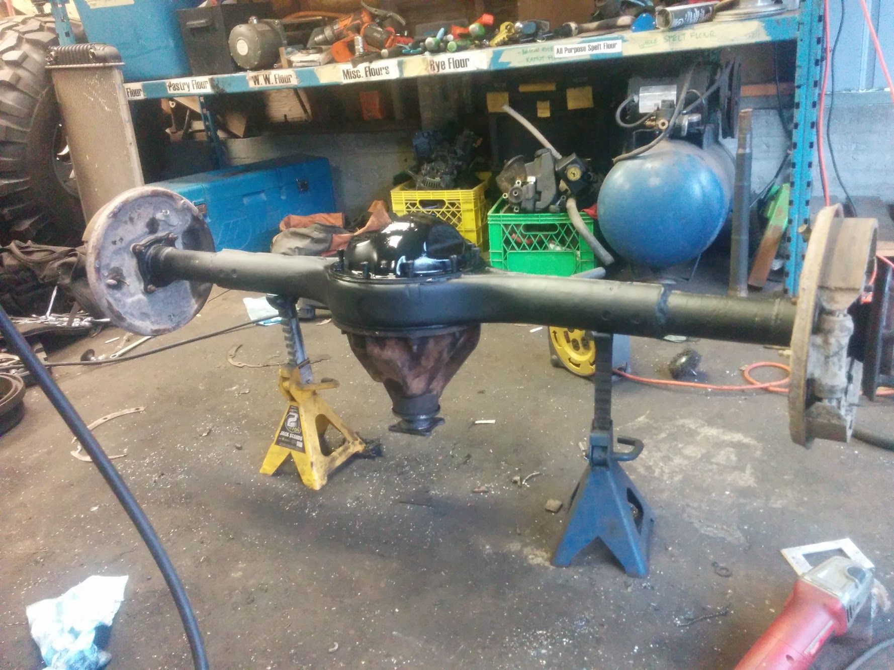

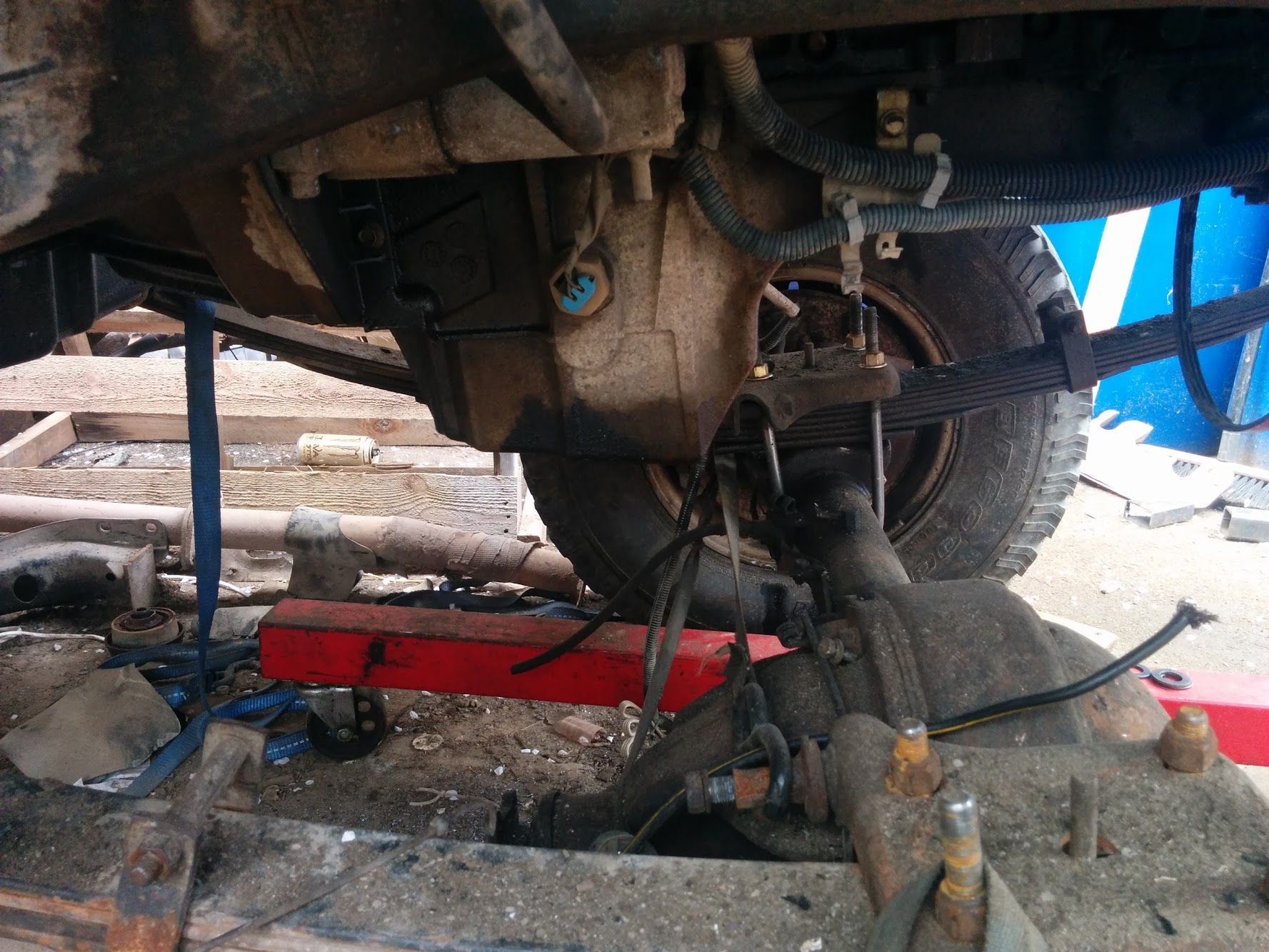

Axles pretty much done. The rear hybrid 9.5/8" will be good enough for now, for the purposes of having something to roll on for the first test drive. Slammed in the 8" outers, bolted it all up and just eyed it level :p. Also sleeved it for good measure.
Front is mostly re-assembled, but it'll all have to come back apart. I just wanted to make sure everything still lined up after all the welding. Need to replace the tube seals and then button it all back up, but putting it off for now as I'm not sure if I'm happy with the pinion angle, but I don't want to change it until I'm sure where my t-case is going to sit. Haven't decided between the 241c or an Atlas.
I stuck the GM PDC into the driver front well and it fits like a glove with minor trimming, so the Engine is essentially already wired up and ready to run. Just need to plug in the battery and grounds. I'll be tying all the toyota electrical into the GM PDC as the GM stuff is much better documented, and all modular.
Assorted pictures of axle stuff.

So in the last post, I showed my gear setups. I'm happy with the front setup. Pattern is near perfect. The rear though is a little close to toe on the drive side, and with the amount of tooth I had to grind down for pin installation, I'm just not happy with it.
That said, after I'd ground down the tooth and pin and actually tried installing a c-clip shaft into that third, even on a bench it took me 2 hours to do one shaft so I said ˟˟˟˟ it and built a hybrid rear to eliminate the c-clips. Really sorta wish I hadn't ground down that gear now. Oh well.
So update for today.
Axles are both under the truck and mostly complete. Rear axle needs new seals installed, both axles need shock tabs, gussets and trussing, but I'm holding off on that until I've gone for a test drive as I have no idea if the axles are even remotely aligned.

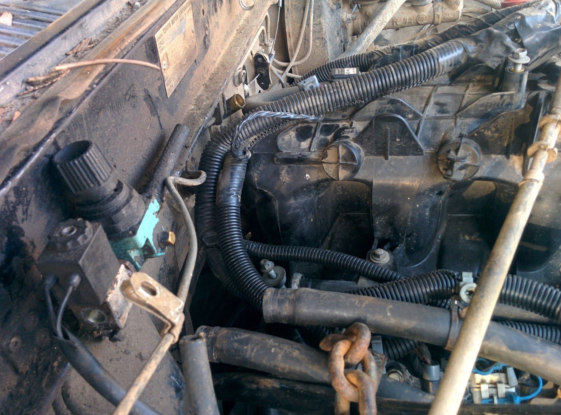

I started on the installation of the GM PDC yesterday. I figure because the toy electrical was mostly ripped out anyway, and the GM stuff is far better documented, modular, and has loads of room for expansion, the GM box just made more sense.
Looks like it was meant to fit here:
https://cimg9.ibsrv.net/gimg/www.yot...2d63baf457.jpg
https://cimg0.ibsrv.net/gimg/www.yot...e822593214.jpg
https://cimg1.ibsrv.net/gimg/www.yot...d192c9d35b.jpg
The plan is to just give the PDC power, ground, and ignition all into the stock locations, as well as pipe the fuel pump relay out to the toy harness. From there I should be ready for a test fire. Holy ˟˟˟˟ is this ever the way I should've done the Jeep.
Once that's all working, I'll just tie the rest of the toy electrical in. There's really not much else needed besides lights, wipers, horn, and the rear window. I estimate I'll spend a total of maybe 4-5 hours on wiring by the time I'm completely finished.
The box itself fit really well. I trimmed it a little, which is fine because MOST of the box is just dead space. Hit it with a sawsall for 5 minutes until I was happy with fit, threw in a couple plus nuts, and she looks like she's home.

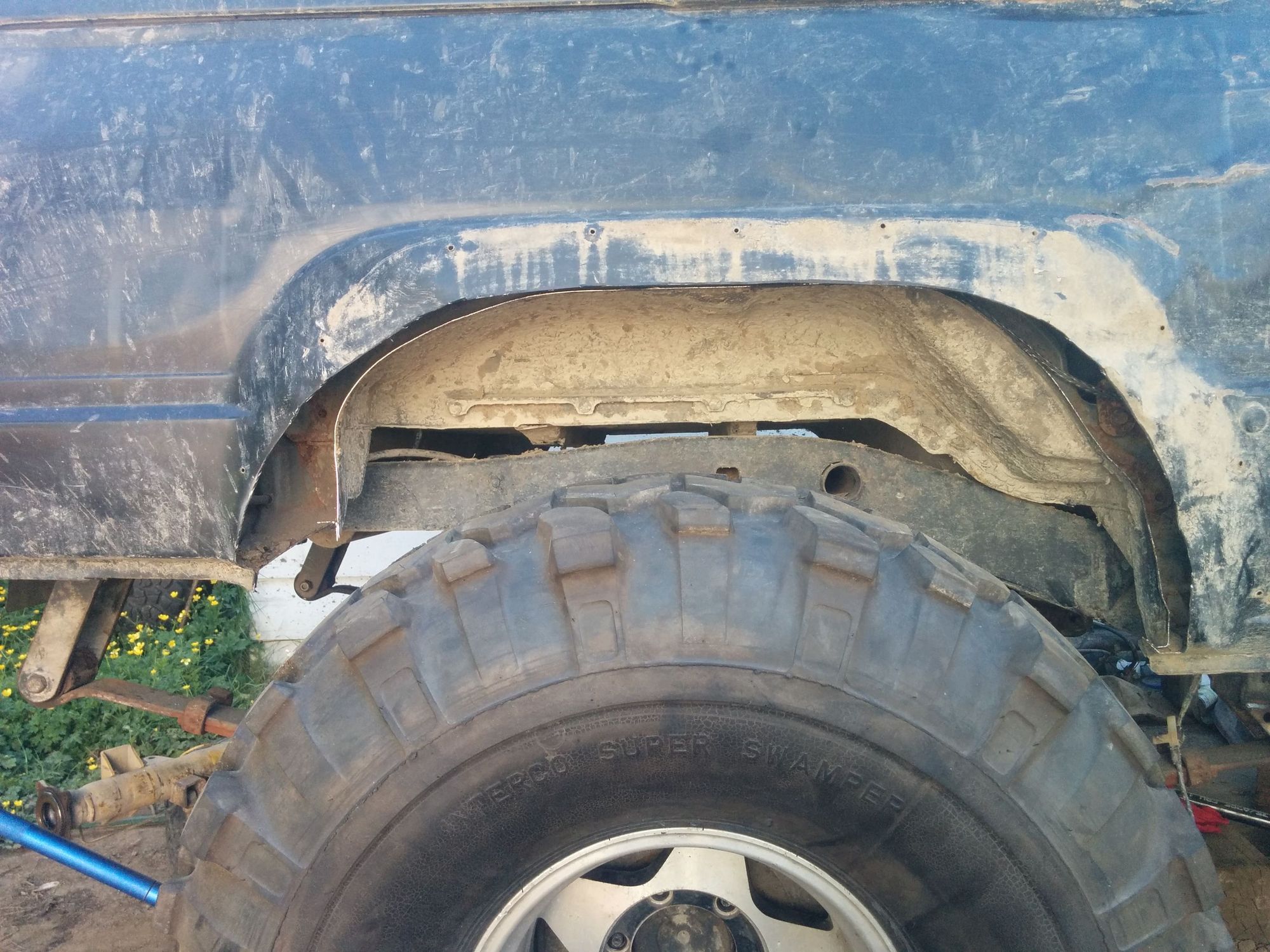

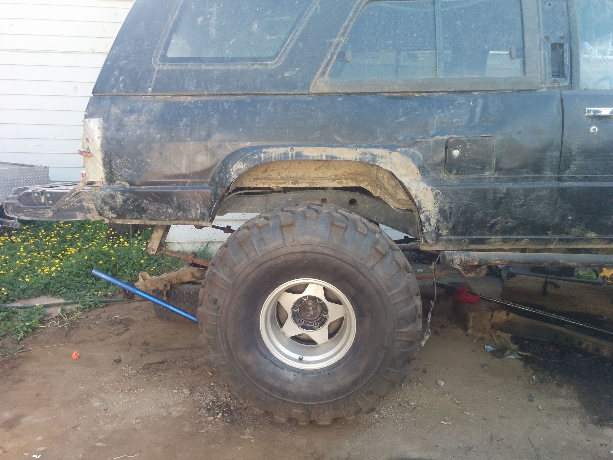

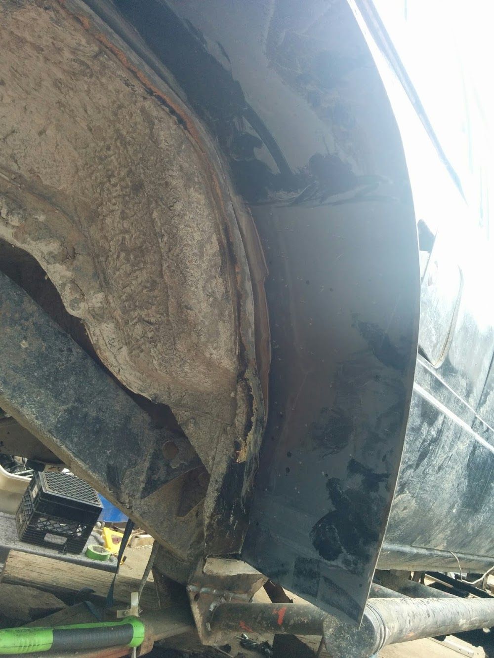

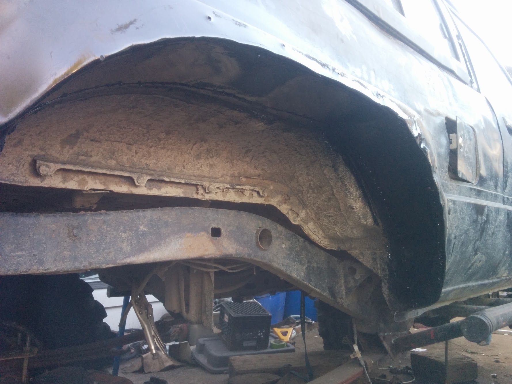

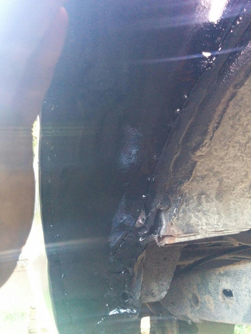

Then I got side tracked today because I'm annoyed that every time I flex any corner out, the rear tires would bind in the wells.
Decided I'm happy with the actual axle location (though it is a longer wheel base than I was originally planning for), so started chopping. Again, my god is this ever easier than on the XJ.
I just cut about 1" out from the center pinch seam on the under side, then took an inch off the outer fender just so I'd have easier access. From there, I made a real long marker out of some sockets, so that I could just level the marker against the inner well while scribing a line on the outer. This gives me a very nice line until the rear 1/8th of the flare, where I had to come back a few more inches, but I managed to draw that bit by hand, and then chop it all out with a small cutoff wheel.
Not positive if this is where I want it yet. I may go a little higher on the outside, but everything else I'm happy with.
https://cimg8.ibsrv.net/gimg/www.yot...53c8afc658.jpg
https://cimg9.ibsrv.net/gimg/www.yot...6c647b6193.jpg
https://cimg9.ibsrv.net/gimg/www.yot...05cf16127d.jpg
Hopefully get some sheet metal tomorrow to burn in this side. I'll use some thick construction paper for mock up to get my shape, which is WAY more planning than I ever did with the Jeep :p. But, this really should be dead simple. Just a mostly flat piece of sheet, tack it in to the inner well, tack to the outer, burn in and trim the outside. Should be an hour per side (maybe not including the time it takes to clean off all the underbody coating. (Anyone have any magic tricks to get that stuff outta there?)

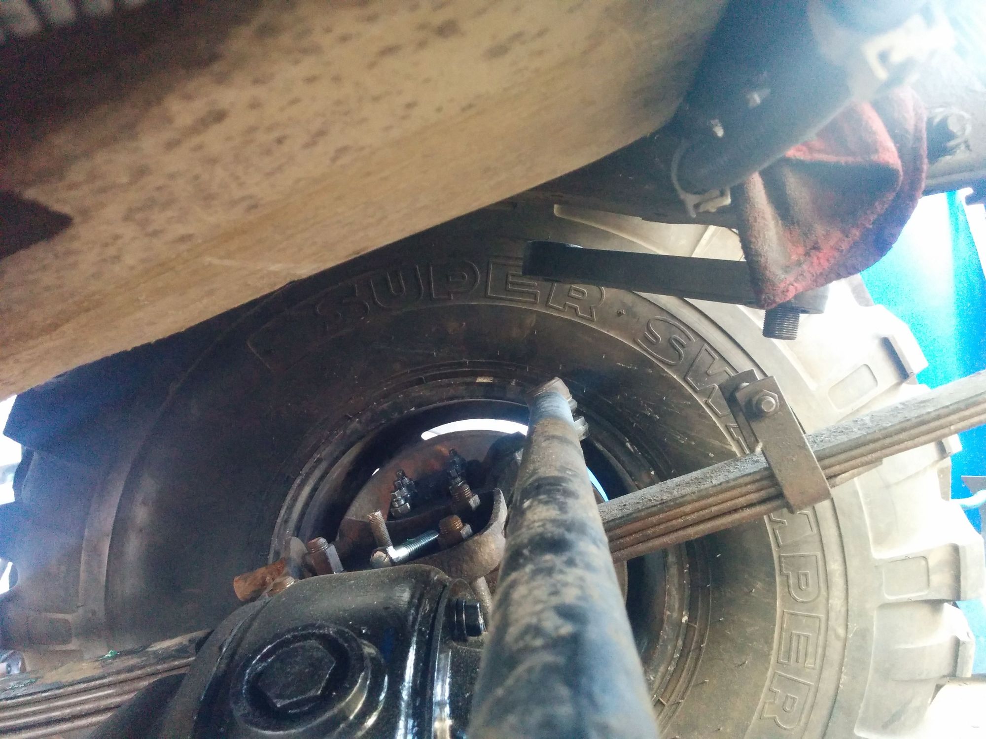

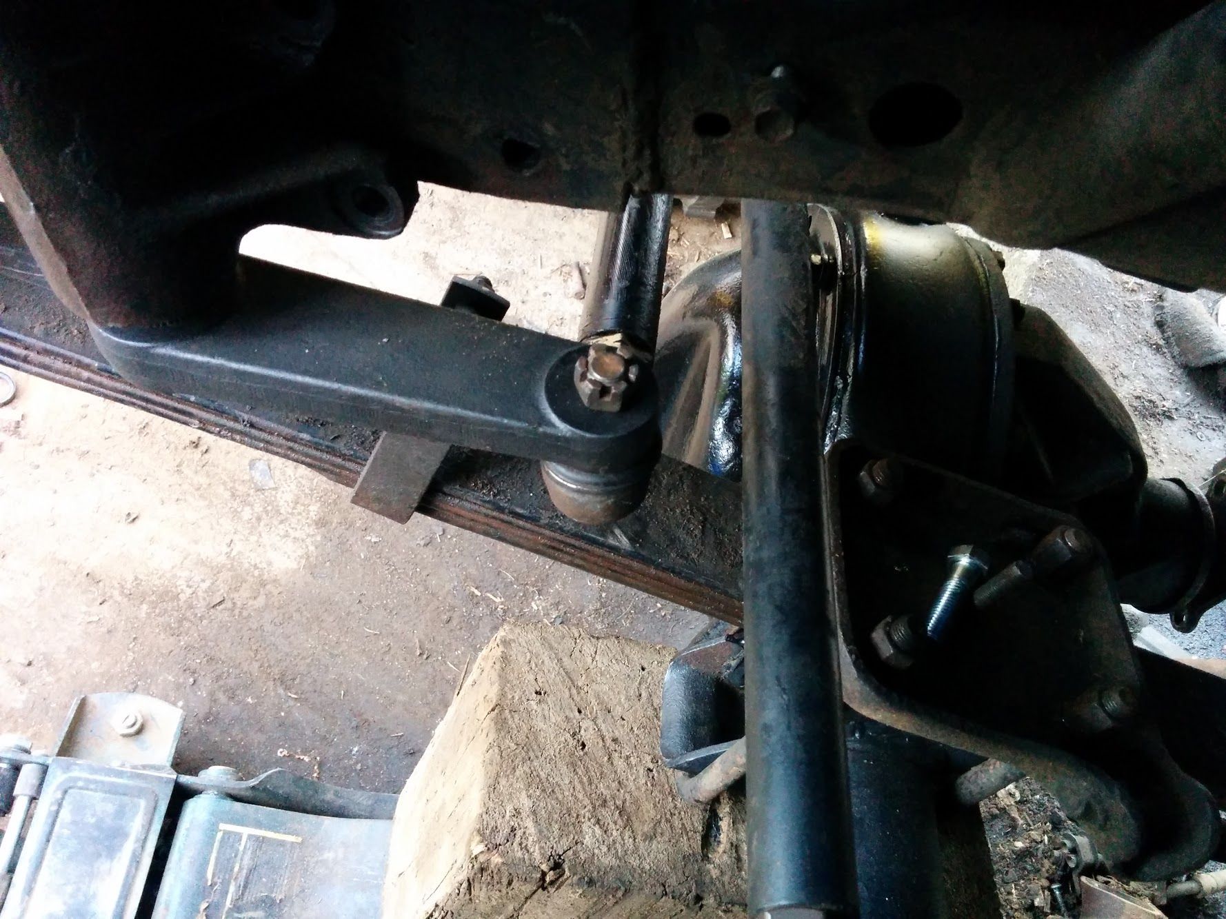

Here's my current problem.
https://cimg1.ibsrv.net/gimg/www.yot...3163d4e598.jpg
Previous owner had this thing lifted so high that pitman/tie rod interference wasn't a problem. With dropping it down almost 7 inches though, I'll either have to move the box forward another 2" (it's already hitting the cab), or find a reverse rotation box and mount it a foot or so back. I happened to have an old BJ60 box, which is reverse rotation, but is a manual gear. I haven't decided what I want to do here yet as I know nothing about the various toy steering gears. What makes more sense? regular or reverse rotation? Either should give me enough clearance, but the regular rotation box mounted way forward will ultimately give me MORE clearance.
Other than the pitman/TR interference, everything else looks like she'll fit. Articulated a few directions. I seem to have more than enough clearance to the frame and the oil pan (plus the oil pan will be moving up with the f-body swap).
Front axle fits perfectly with the RUF swap.

It actually really wasn't that bad. Did the passenger rear today in about 2 hours. That includes cutting the sheet out of a chevy box, prep, chopping, an hour looking for gloves and tools, welding, more cutting and folding, welding, and a coat of paint to protect it overnight from the rain.
Here's the donor
https://cimg2.ibsrv.net/gimg/www.yot...cdc017c304.jpg
Then I started on the runner by cutting a straight line 1 inch to the outside of the center pinch seam in the well, then just sorta randomly cut out the fender just so I could pull the old stuff out and see what I had to work with.
https://cimg0.ibsrv.net/gimg/www.yot...a4a01b2ee8.jpg
https://cimg1.ibsrv.net/gimg/www.yot...8be862ba13.jpg
From there, I lightly hammered the outside of the pinch seam up a little so it'd be level with the inner well, so I could (using my special "LONG MARKER") to scribe a line on the fender (outer) that would be flush with the inner well.
Once I had that line, I just chopped it out as well.
Then I took my piece of sheet and stuck it in for a test fit.
https://cimg5.ibsrv.net/gimg/www.yot...a632c2acad.jpg
https://cimg8.ibsrv.net/gimg/www.yot...6fe101e327.jpg
https://cimg9.ibsrv.net/gimg/www.yot...395e3ebb1f.jpg
Test fit looked good. I WAS going to just tack it into the inner well, then cut it to fit the fender, but decided I didn't want to also go completely homicidal with edge welding, and instead cut some slits in the fender and just hammer the outer fender in and up to meet the new sheet. This was WAY easier than the same job on the Jeep.
So I tacked in the inner well, then cut off any excess sheet sticking out, pushed it up inside the body, cut some slits in the fender and hammered it all up. Then just started tacking.
The rear got a little ugly because of the change of plans half way through, but once I'm ready to make it pretty, I'll just hammer it all flat and slather it in sealant. It'll all be covered by the flares anyway. I'm more concerned with making sure it's sealed and not going to rust.
So this is how the one side sits now. Needed some paint to survive the rain tonight.

Then my buddy showed up with a spare drag link and a couple TRE's so I could figure out where I'm going to put the steering box. I think it'll be fine if it gets moved forward about 1.5", and tilted way back. I was going to clearance the frame for the castle nut to pass by, but looking at it flexed, I'm already near buried in the fender and those leafs cant' really go any further anyway, so I'm goona call this good.
https://cimg2.ibsrv.net/gimg/www.yot...785ca71a43.jpg
https://cimg3.ibsrv.net/gimg/www.yot...d655ab71f4.jpg
https://cimg4.ibsrv.net/gimg/www.yot...60aac93ccb.jpg
https://cimg0.ibsrv.net/gimg/www.yot...8d36672cce.jpg
https://cimg1.ibsrv.net/gimg/www.yot...d2fa08f5c6.jpg
Box is just resting there cause I ran out of hands and my GF has Zero interest in helping. Just pretend it's moved up as high as it can go and still have clearance for the castle nut to the frame. Should be more than enough room to clear the tie rod as well.
All in all, a pretty productive 3-4 hours today. Depending on how lazy I am tomorrow, I'd like to get the other fender done, and chop off the old steering box bracing and re-mount it in the correct spot.

No pictures from yesterday and it's raining now, but got a few things done.
Engine mounts are in. Took the GM mounts and cut the frame end of the mount off, and flipped the engine side around 180 so it points almost straight down. Drilled an enormous hole in it to accommodate an enormous bolt. Welded on a chunk of 2x2x0.25 tube and drilled a hole in it to match. Stuck a hockey puck in between and torqued down. I think it'll work.
I had some wicked oil leaking from the donor motor. PO said it was the rear main, so pulled the trans to replace, but the seal looked good and I don't think that's where the oil was coming from. Thinking it may have just been the oil pan gasket. Oh well. Did the rear main while I was in there, as well as the valley cover and valve covers while I was at it.
Bolted up the np243c to check fit. I think it'll work. It has the 1350 yoke front output, which I'll probably swap out with the 1300 series flange (the long flange, cause that's what I've got, but I'll do a shorty if I can find one). Then I can probably use the GM DS flange and just swap out two caps for toy caps, and mate a Toy double cardan up to the GM flange. I THINK this will work.... If not, I'll be on the hunt for a GM double cardan again, and just swap out the caps on the diff end.
For fueling, I think I'm going to just run a hose from the toy pickup to the bottom of the tank, then pass that to an inline 255lph pump. No idea if this is going to work, but it's cheap/easy and if it works, it should work fine. I've never used an inline pump so I have no idea if they have trouble priming.
