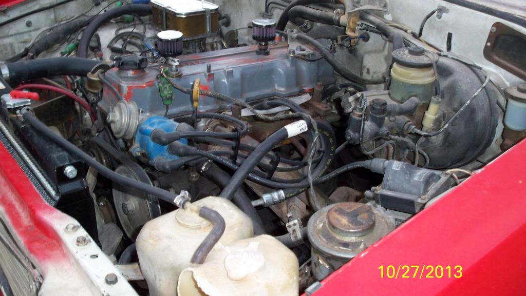

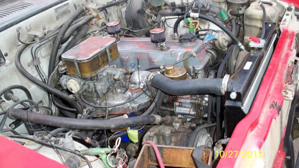

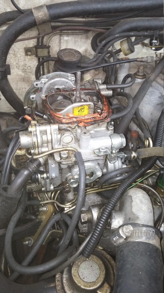

The first thing i did was pull the carb out to try and find out what it was. After about
2 hours, i found it to be a 32/36 E-Choke(not connected) Weber. I wish i had taken pic's of the dis-assemble, but it didn't come to mind to make a thread. After cleaning it and checking all the little ports for possibly sand, i put the gasket kit i order from the webers site, about $31-ish.
Then i had taken apart the cylinder head, and oil pan (for peace at mind) to check the condition it was in. The block was just perfect, but the head needed a bit of cleaning and the oil pan bolt hole had to get straighter. After that i took 320 sand paper/cotton like rotary piece and smoothed the combustion camber, and polished.
And just clean up everything else, dirt duel-plane intake, emission ports(thick black walls). The old radiator had a bad core, so i put an aluminum single row just like my 4runners. It does get just a little warm, but i got a hose to redirect, and it only has water in it.
Here's what it look like now
Attachment 146787
Attachment 146788
If the the engine is clean,something must be wrong.
After putting it all back together, i made a wire from my alternator to the electric choke.
And man did it start running beautifully, was able to get at 1000 rpms (sounded sexy) and start up.
Had put in for the engine, gaskets, lude, oil filter, cyl. head cover air filters, and a new starter.

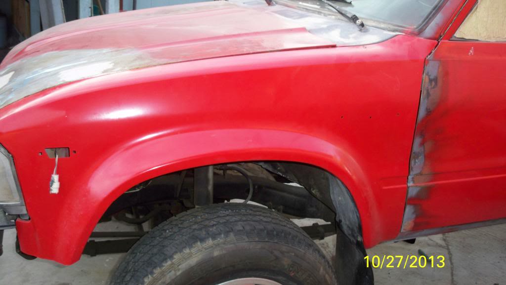

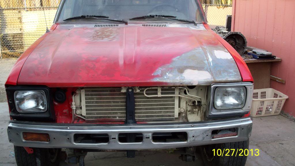

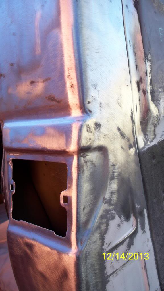

Next was the body, imagine the entire cab, hood, and fenders cover by a layer bondo and then premiered over. I took a 40grit sand paper to the fenders and hood first, went down to the metal, hammered (not to perfection, it is a truck)and cleaned with mineral spirits. Add 3 layers of Rustoleum red cherry enamel, the fenders temporarily done.
Attachment 146789
The hood on the other hand i didn't complete, 3 areas i gonna have to bondo since the metal was too stretched. i left it until the rest of the truck gets painted.
Attachment 146790

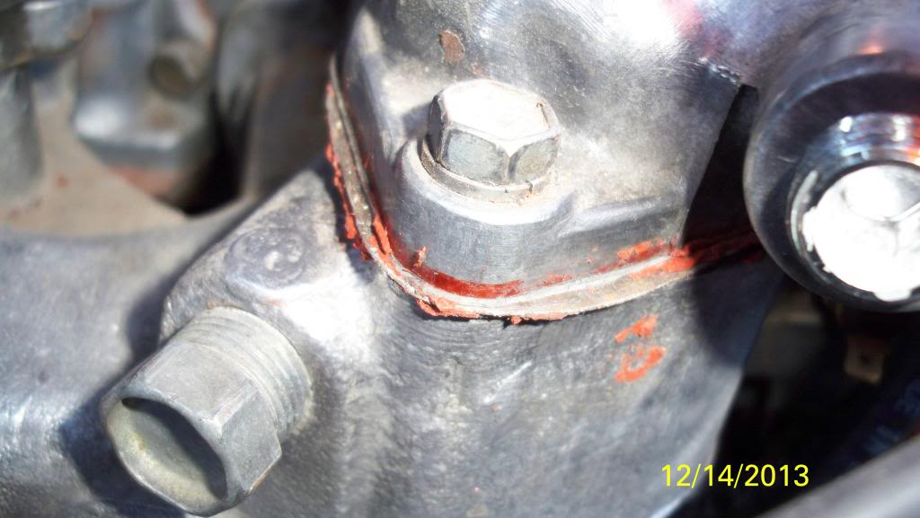

Man look at all the rtv my god I would put new gaskets on that thing quick
gillesdetrail Dec 6, 2013 04:51 AM
Looks good! You mentioned you have only water in it now, I suggest flushing it or putting an additive in because water will rust out everything and create nightmares, it also boils at a lower temp than coolant and has not lubrication to it, but the worse thing really is corrosion.
83 Dec 9, 2013 07:19 AM
Why is that people who go crazy with rtv always do it with red?
catfish21 Dec 9, 2013 10:42 AM
Lol I have no clue I put high temp red around my headers but thats it

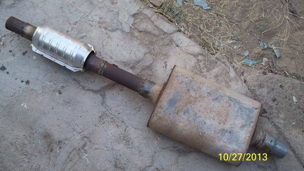

Now you know that the header is a tri-y (nice for this low-end torq.), but when i got it the guy told me the muffler had fell off when he was at a McDanelds drive thru. So i ended up welding a 2"-1 3/4" pipe to the header, then welded some extra pipe i had from my 4runners exhaust to the Flowmaster 60 series muffler. Attached the 49state Magnaflow cat. .
Attachment 146279
Doesn't really make sense but, i like the reduced engine sound. In my opinion.

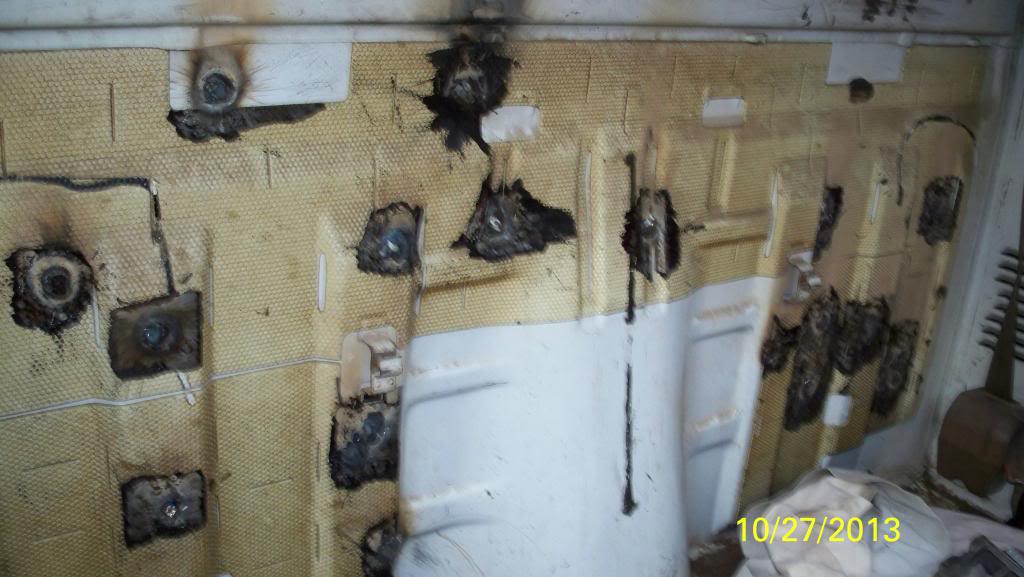

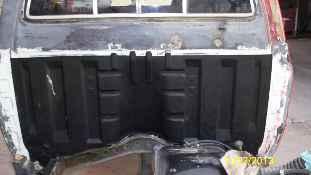

Also i notice a lot of screw holes on the back of the cab, i believe the other guy had a system (amps, crossovers, etc.) in the truck. So i decided to weld those up and smooth the outside of it, then added some Dupli-color Kevlar Bed Armor. Nice.
Attachment 146280

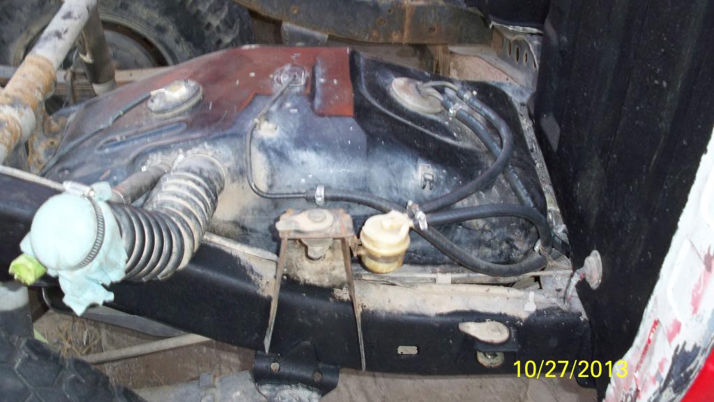

I even did some of the frame (not done), did all the fuel lines and played with the filter i put between the carb. & steel fuel line.
Attachment 146282
Will get front filter pic later.

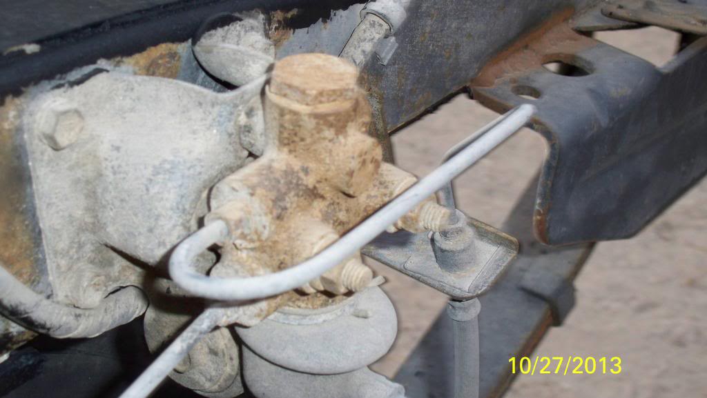

On a side note, i thinking of removing this and given it a good cleaning, but on the side line because nothing is wrong with it, no crud in the lines all brakes work. What do you guys think?
Attachment 146283

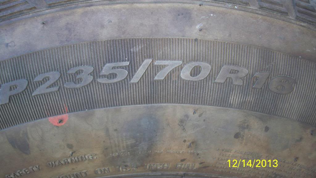

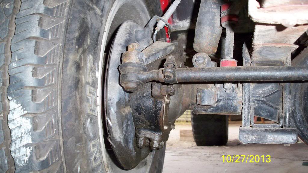

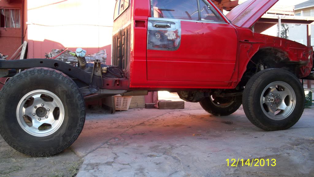

Also put a set of aluminum wheels on 16x8, with an 1.25" wheels spacers on the front. Other wise it would be right on the pitman arm, Before there were 15x11.50 Steelies on 32" BFG M/T's, to much for the 22r to drive done the road with enough push. wasted a 1/4 of the tank going about 8 miles to a buddy's yard, straight from where-when i just bought it.
Attachment 146284
Nice safe spacing. Will get images

chrisgreene243 Dec 13, 2013 07:15 AM
1 Attachment(s)
Attachment 146257
Yea p/o RTV jobs make me feel real confident.

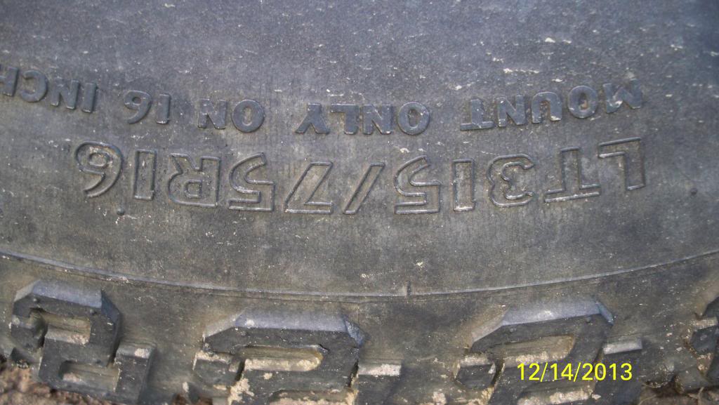

So continuing from the wheels, i bought these wheels from a guy that had them on a dodge diesel truck lifted. The ones from above images, they're aluminum with 2 different sets of tires front and rear. Rear has Mickey's and front Dunlop.
Attachment 144431
Attachment 144433
Attachment 144434

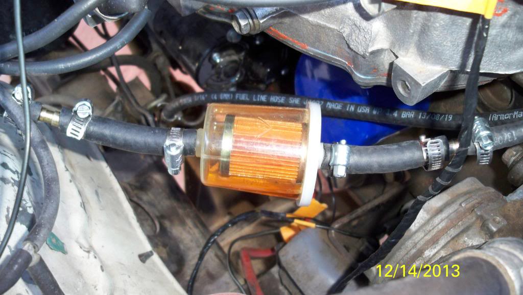

Here's the rigged fuel filter redone with two brass fittings, and correct rubber lines to fit the filter and factory metal lines and fuel pump. Can see the redone wires in the back.
Attachment 144435

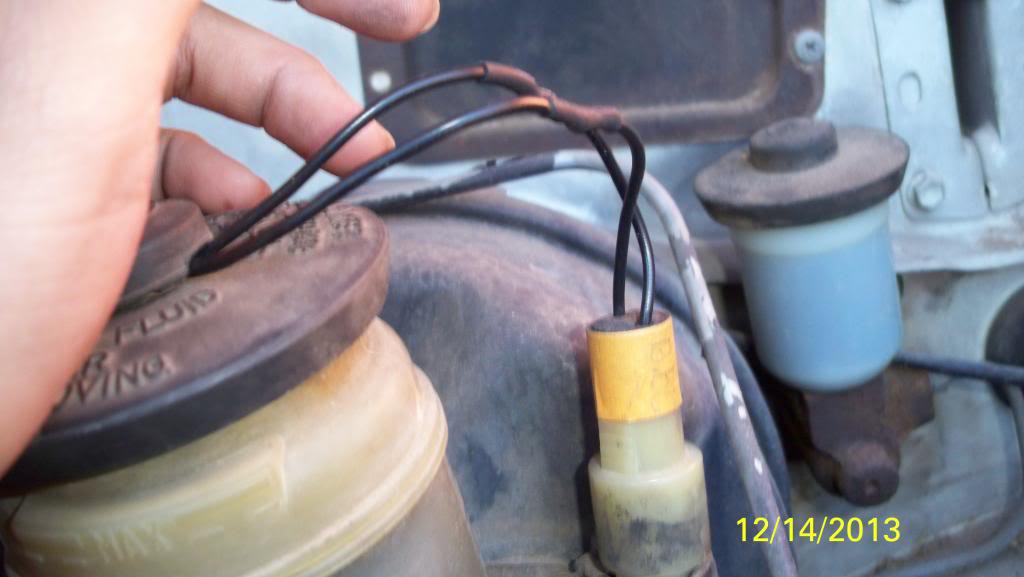

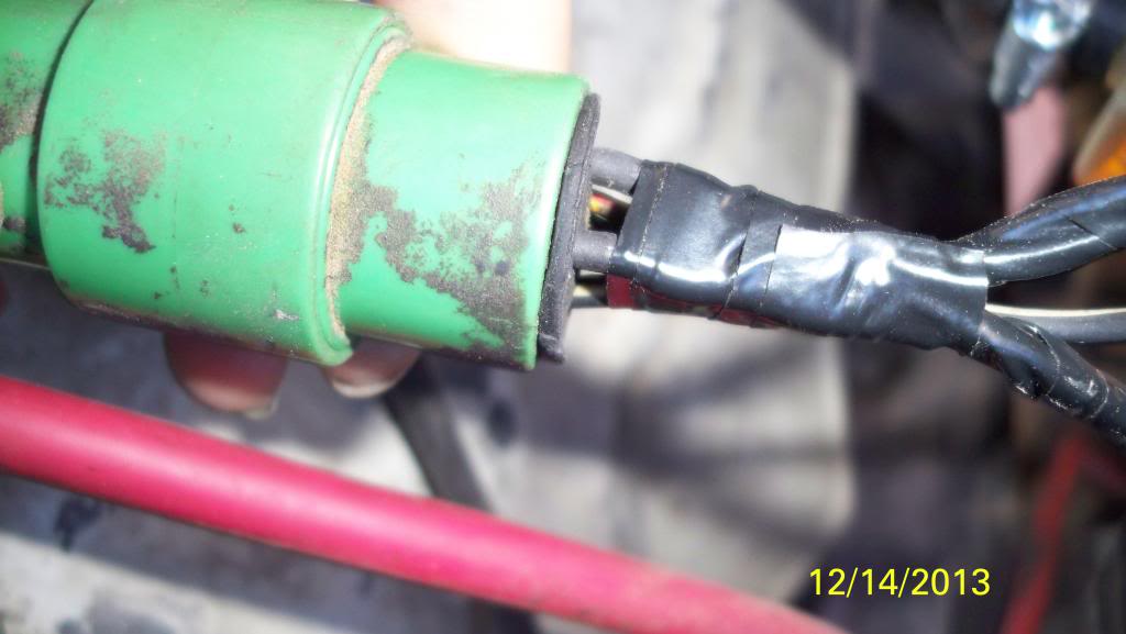

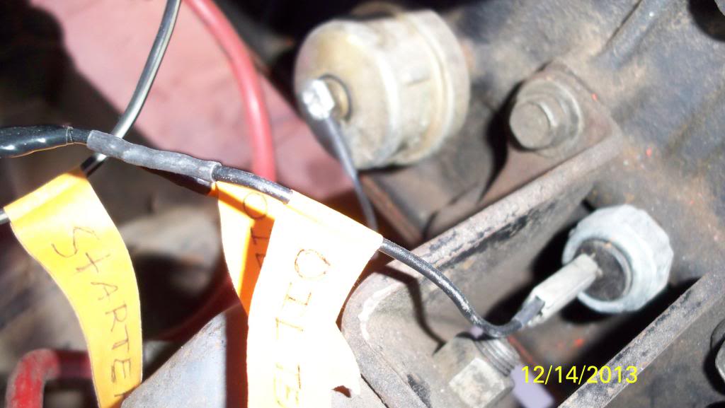

I also re-did some wires on the brake fluid container and plug, plug for four sensors and starter all wires done with 18-gauge.
Attachment 144436
Attachment 144437
Attachment 144438
To give and idea, i take the paint all the way to the metal and then do and final 400/320grit wipe down to the surface and clean with mineral spirits, then add the Rustoleum rattle can.

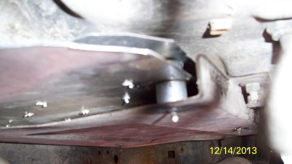

Here's the two pieces of drilled aluminum sheets and 1" piping on the heat shield to reduce the muffler heat on the drivers side. Double tacked on four screws.
Attachment 144440
And the plate i had to rig.
Attachment 144441
and just hold my methods, i apply rtv on the outer half of the gasket to prevent any from entering any open inside areas of the engine. Think as thick as your thumb nail as a layer applied.

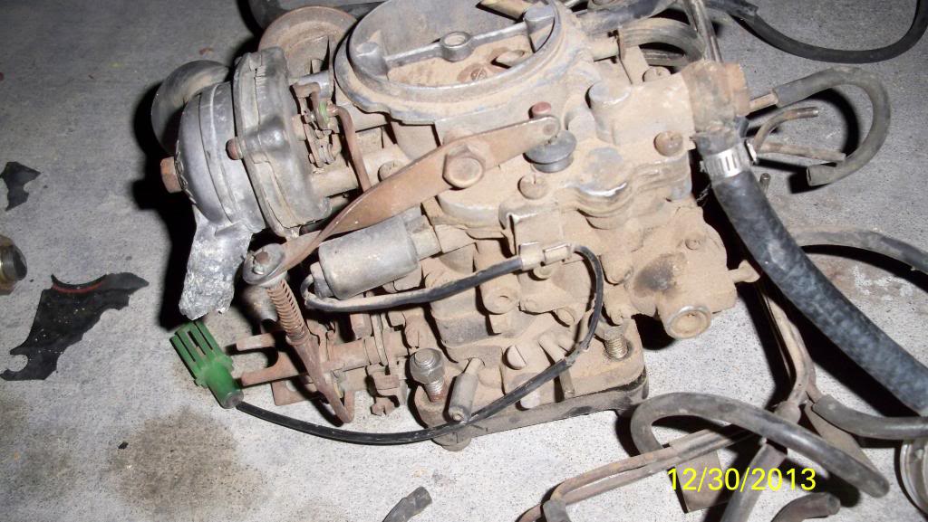

And so about 3-weeks ago i bought a 20r engine complete except exhaust header. From a 78 p/u, and since i have the perfect 22r block to match, i'm going to do the hybrid job to it and get a propane kit from gotpropane.com
Hand port the intake/exhaust and hand machine the surfaces but have a shop machine the head to block surface. Will add de-smog plates, use the 20r duel-chains instead on the 22r single. everything else will be from the 22r, nice and simple. If any one's looking for a 20r carb. that needs a overhaul, give a pm.
