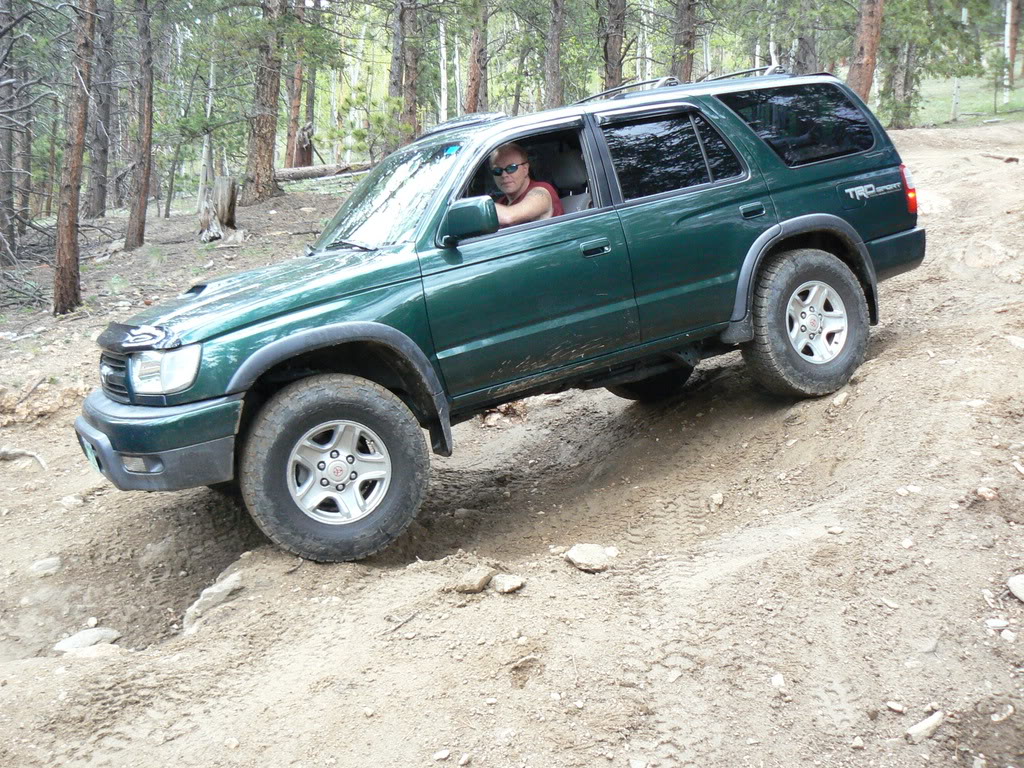

hello i have a 2002 4runner limited 2x4 with a 3inch spacer lift kit front and back, i would like to put 33x12.50x16 (on my stock rims) however all the places i have searched on the internet (for hours!!) haven't helped much so i hope you guys can give me a little info thanks it is a 16x7 alloy wheel i have up loaded a pic before the lift thx. i have put 33x11.50x16 on they fit height wise i just don't know if the 33x12.50x16 will fit with wise, to clear the upper A arm or if they will rub the A arm

I know that 285/75/16 Cooper Discoverer STT's with a 3" OME lift will rub the upper control arm. I now need to pick some new rims with 3.5" - 4" backspacing.

I would think the 12.50's will be a little close. You may have to trim the Upper As or use some spacers.

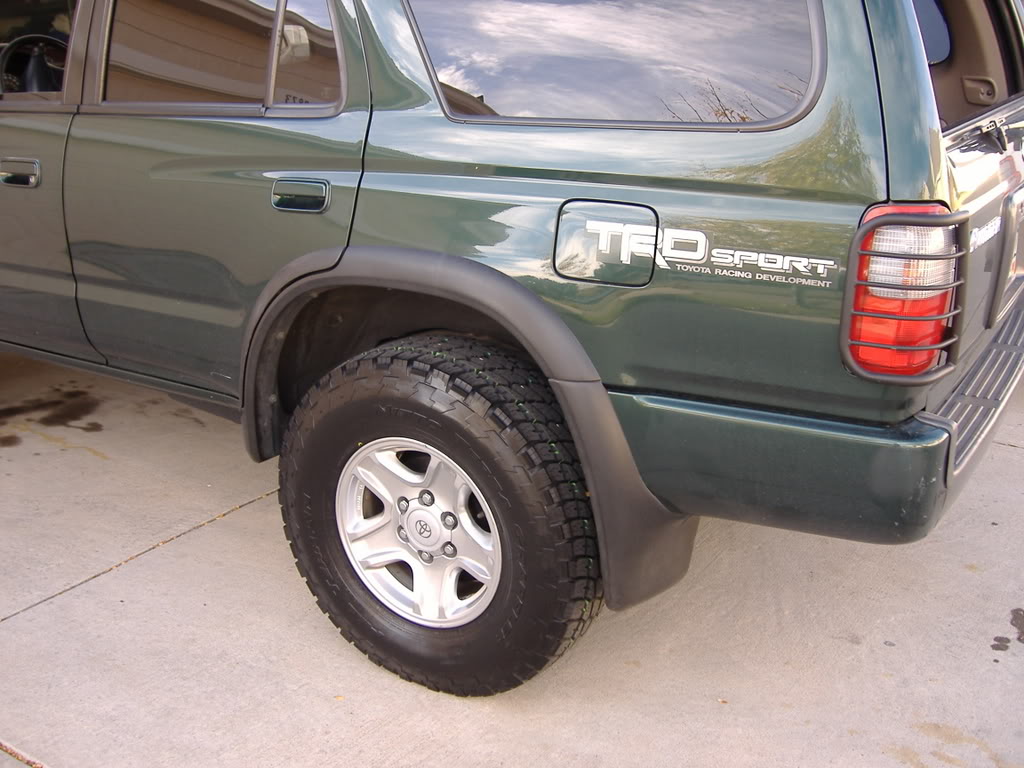

so they fit 33x12.50x16 on stock rims if any one needs the info, looks sweet

here are the pics
3 Attachment(s)
33x12.50x16 on stock rims with a 3 inch spacer lift! no rub cut 1cm off front fender in wheel well.
