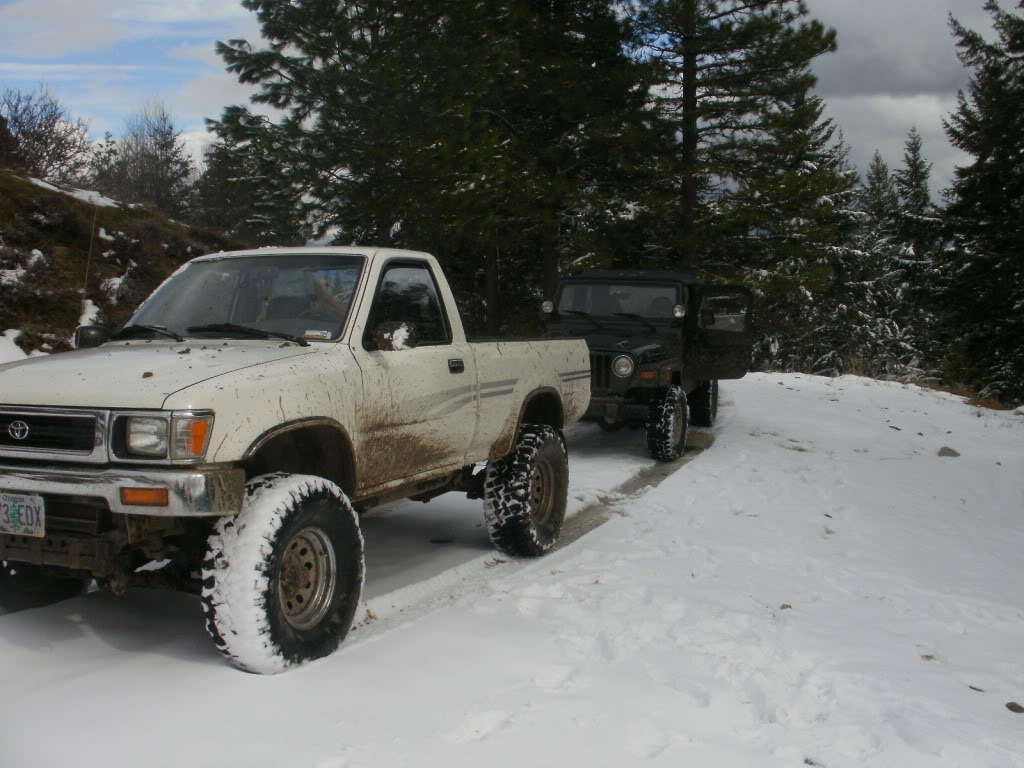

I run 32 11.50 with no lift but I had to hammer the pinch welds
Attachment 189108
People say you can run 33x10.50's with no lift
But I would say 31x10.50 is the best without lift even with the 32's the gearing sucks
